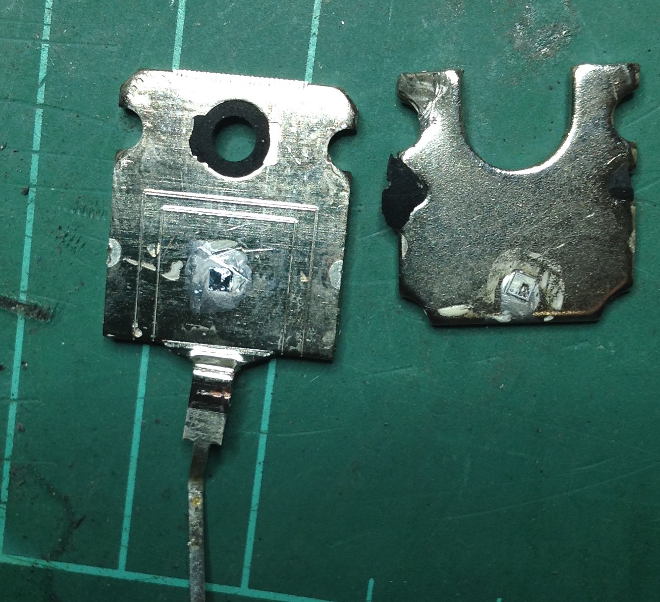

Thanks for the reply. I had nothing to loose so I cracked open one of each. See attached. The die size is 2mm x 2mm. I have never seen inside one of these but it looks a bit off, one isn't even centred properly.

The chip of the original must be at least 5x5 mm. I disassembled an original one some time ago. The chip was much bigger than yours (about 5x5mm) and well centered. In Australia I don't know any seller nor here in Italy. I know that the transport costs are very high ... you pay much more for shipping than the cost of the transistor ..... But at least play it safe!

I think with that die size you are 100% assured that they are fake.

Those fake C5200’s are about the size of TIP41’s inside. Among the smallest I’ve ever seen. Usually they are about 3055-size. I’ll bet they test less than 1000 pf Cbe.

The first thing we noticed was that Vbe(on) was way too high at currents well below what is listed on the datasheet. I don't have it in front of me but I seem to recall very low capacitance (as in under 1nF).

I suspect that the fake TIP35C/36C, 2SC5200/2SA1943 and the fake D1047/B817 were all more like TIP41/42 class transistors. And the D1047/B817 looked like bad scrap/test rejects with some crazy low current gain and some crazy high Vbe numbers. (Barely a functional transistor.)

In that link note the very small capacitance measurements for the TIP35C. Note that they are also strangely close to the measurements of the fake 2SC5200 that I had also bought online...
I think someone else once commented here that the fakes all have the same useless small die inside them. Just different packaging and marking. So I don't buy such components on ebay or AliExpress anymore. And I strongly recommend not buying op-amps, electrolytic caps, WIMA caps and low noise regulators/references there also!
