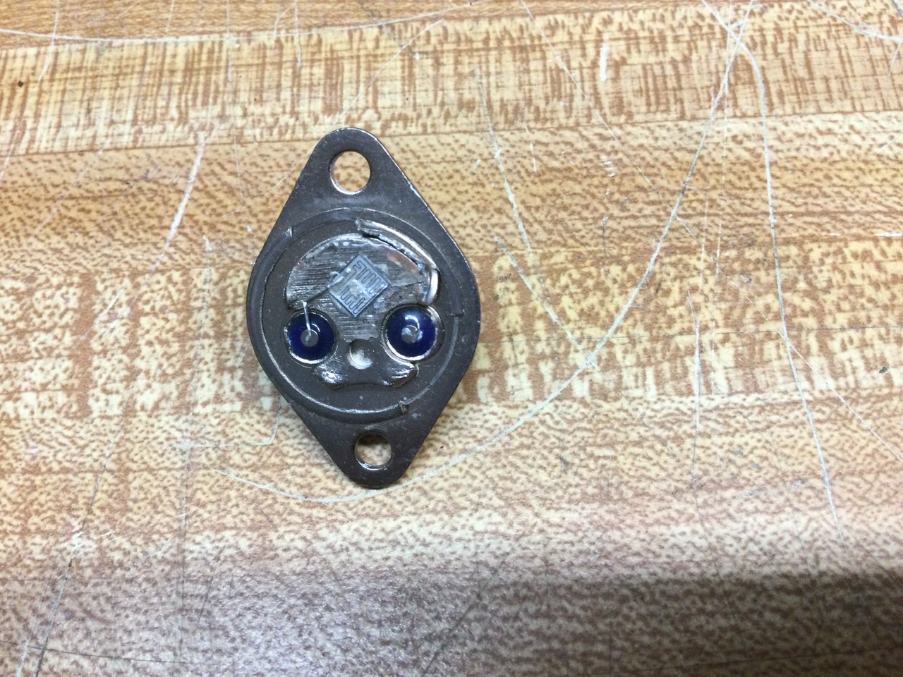

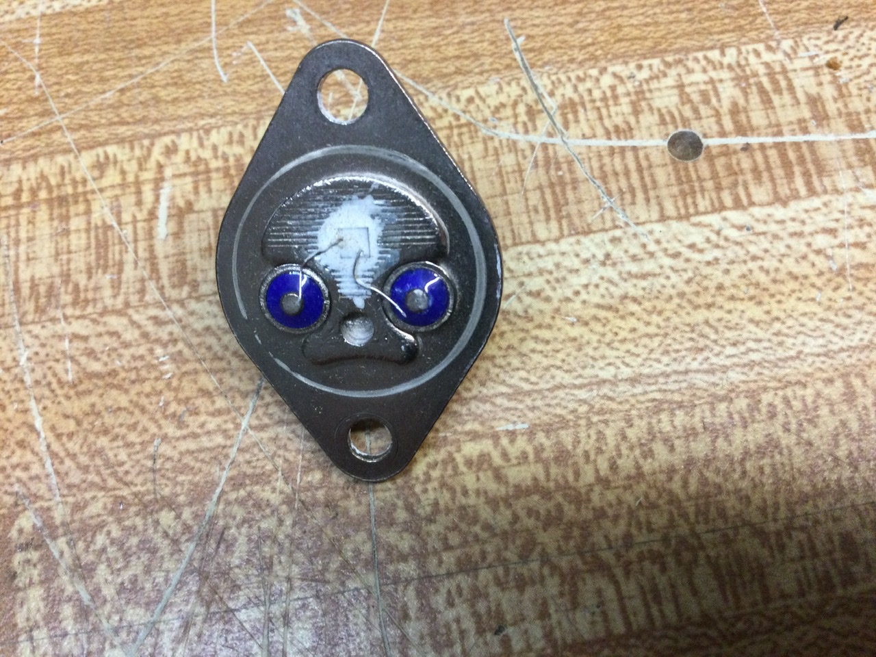

Mah .... But the dimensions of the wafer seem correct! Fakes usually have a very small wafer .....
Exactly. I had another fake MJ15024 from the same batch, marked with the same date code, supposedly from MEXICO - spelled right- that looked like this inside. It’s *almost* the right size. The die is a 2N5630 - they have a very distinct layout that’s easy to recognize if you’ve seen them before. Probably a genuine Motorola they acquired from somewhere, or maybe one of the second sources now making those dies and selling them under Mospec, Central, or Solid State(part of NTE group).
Now you put those two in parallel, and wonder why the thing won’t bias cleanly and the voltage on the emitter resistors is way different despite being “from the same batch”. That’s what clued me in to the fakes. The amp was actually *working*. Would have blown up eventually, though.

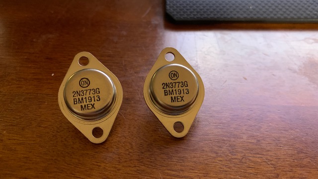

These are currently on offer on Fleabay.
.Matched Quad 405 Replacement 2n3773 Transistors,best quality ever | eBay
The 2N3773 is still commonly available.
But people still like to pay less than $7 apiece for them. So the black market continues.

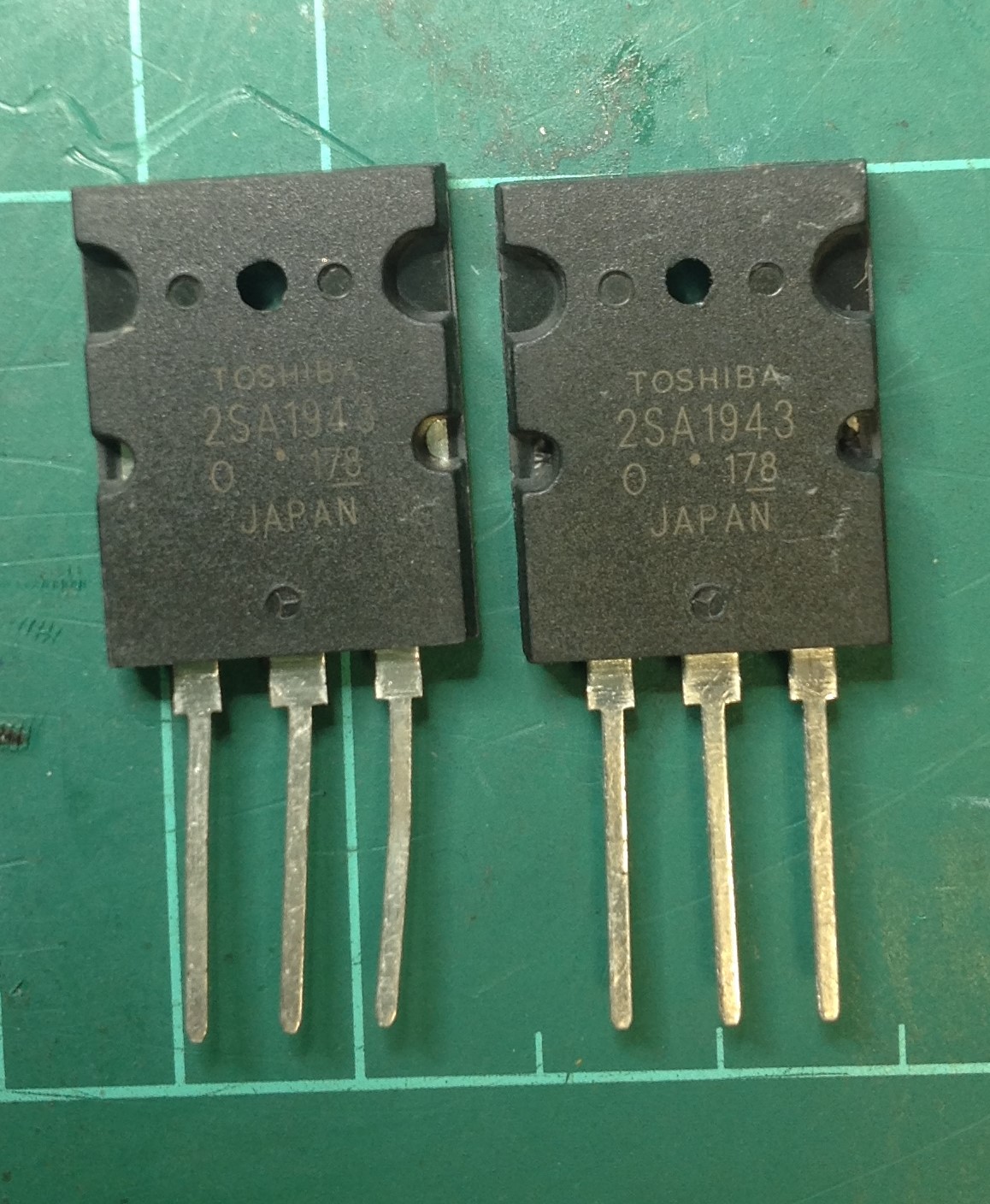

Fake 2sc5200 and 2sa1943 ?
Hi all
After blowing up 8 of these transistors in my attempt to repair a Denon PMA-700v I am starting to suspect they are fakes. They seem to work up to about 10Vrms after which time they blow. Yes, I got them on Ebay but from a local Australian seller so I thought that would improve my odds. Thoughts ? The offset print on one of the 2sc5200's looks dodgy. I really don't know how else to check them. It still could be my repair job.
Richard
Hi all
Richard
Hi Richard. I also had the same problem with these transistors. They exploded !! Over the years I have understood that today it is not easy to judge a component by the writing! The fackers have reached very high levels in the printing of the abbreviations and also in the materials of the package. This makes it very difficult to verify by eye. There are 2 solutions to check if a component is original or fake: 1) the bench test verifies that the measurements taken, especially the maximum voltage and current, correspond to the data in the manufacturer's datascheet. (This case, however, still requires you to purchase the component). 2) buy only from official sellers. (RS components, TME, Farnell, Arrow ..... etc.). I don't even trust physical stores in my city anymore! I hope to be proved helpful.
