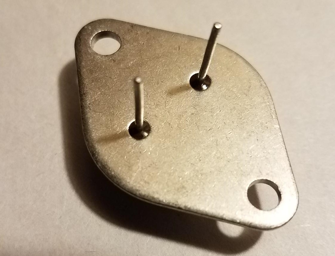

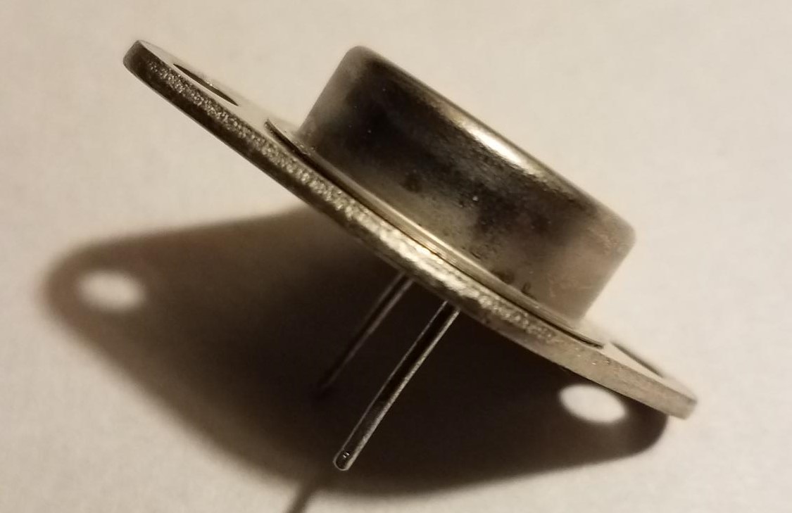

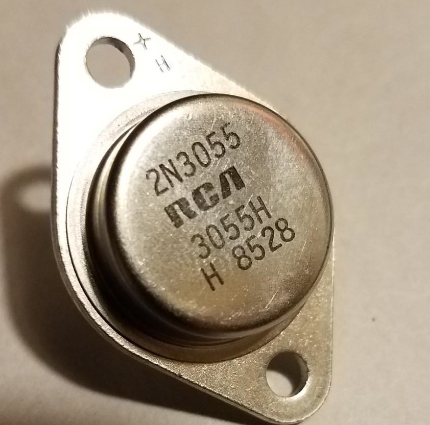

What do you think of this? It was soured in the USA as nos 3055H. Also wondering what the Ft should be for these devices. I have read conflicting info, some say later RCA homotaxial have Ft at 2+MHz and others say 800 KHz

Hi Marty,
A real 2N3055 has an Ft of 800 KHz. It was designed for power supply use as the pass transistor that was commonly mounted on a heat sink away from the PCB Normal power transistors can oscillate under those conditions. Some of the really early ones had an Ft of 19 KHz. I got that figure from some really early documents from Lambda (they defined the transistor for use in their power supply products). Motorola may have designed those original parts.
When looking at the specifications for a transistor, always go with the collector - emitter breakdown voltage. The collector - base junction rating is optimistic and you don't generally use transistors in this way.
-Chris
The “H” version is supposed to be the slow hometaxial version. For a while RCA was making both types, with the non H basically equivalent to the Motorola. But I dind’t think they still making hometaxials in 1985 - I thought they stopped when the 2N6259 disappeared in about 82. Maybe they had Emmit’s flux capacitor. Or maybe they were making a tougher version (but still epitaxial) and calling it the H. Motorola/ON did make a tougher 2N3055A for a while, and they never did have the RCA process.
This isn’t about spoofing - but rather a what is it. There are so many different things that are called a “2N3055” that it’s difficult to tell what you’ve really got without further testing or inspection.
Almost any modern NPN epi-base or triple diffused transistor die at least 2 mm on a side and mounted on a heat spreader will pass the generic spec for a 2N3055. None of the parameters are tightly spec’ed and the required SOA is pretty easy by today’s standards. A real one from ON would be tougher and have margin to spec. A real RCA hoemetaxial would be tougher still.

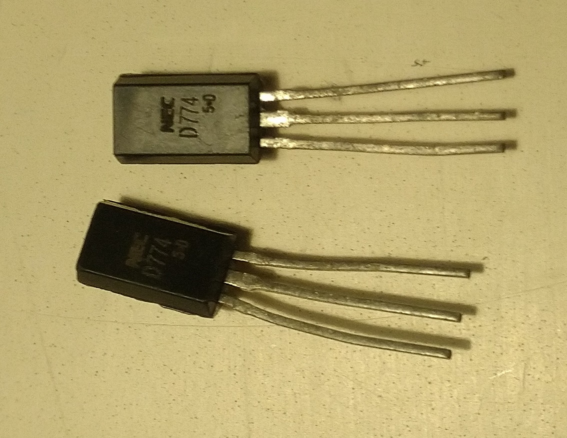

Hi grunf,
Tough call. They are clearly not real if NEC only used the case style in the data sheet. They do look suspiciously like new leads may have been attached.
Normally, the remarks I have seen have lower beta, ~200 or lower. So to measure a high beta suggests they might be real, or at least from a stock that has more desirable characteristics.

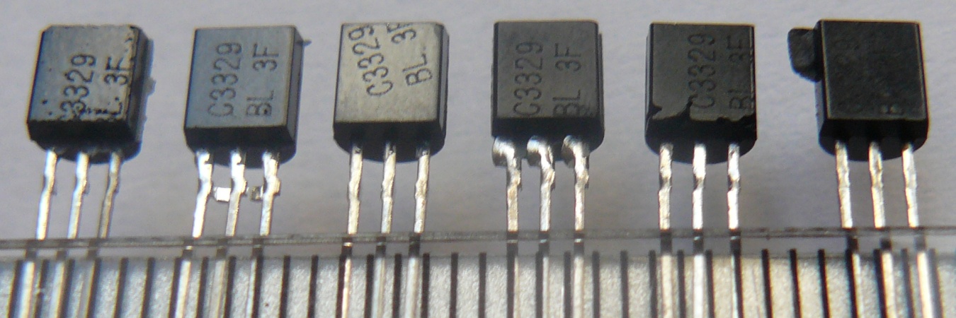

No worries - I know they're fakes, but I'd better explain my reasoning:
On top of the obviously different font types:

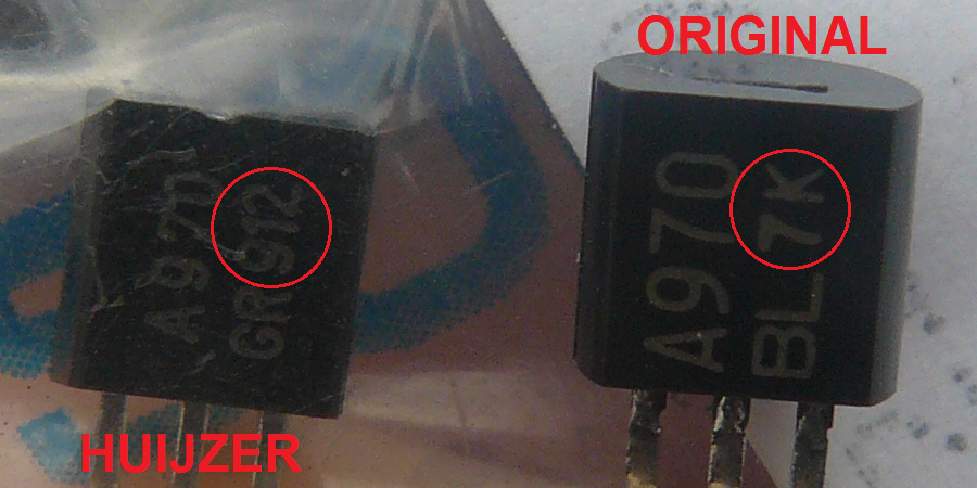

- A970: I've seen a lot of various genuine Toshiba transistors over the years, but I've never seen one that would use a 3-digit date code

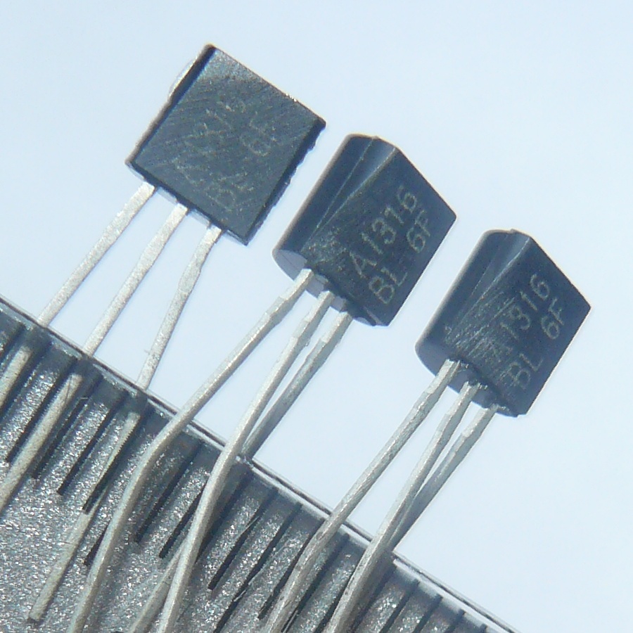

- A1316 & C3329: the former sanded to oblivion, the latter... I just can't find words to express how horribly poor quality imitations they are :yuck:

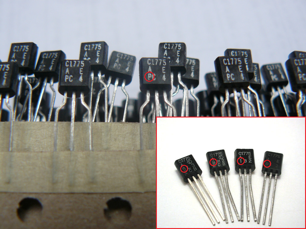

- C1775: AFAIK, the 3-letter Hitachi date codes always start with a digit, representing the year [as you can see in the smaller photo of genuine parts from different production years in the corner]

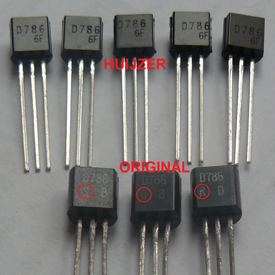

- D786: the hFE rank is supposed to be printed on the case
I didn't even bother to test these electrically / compare against data sheets...

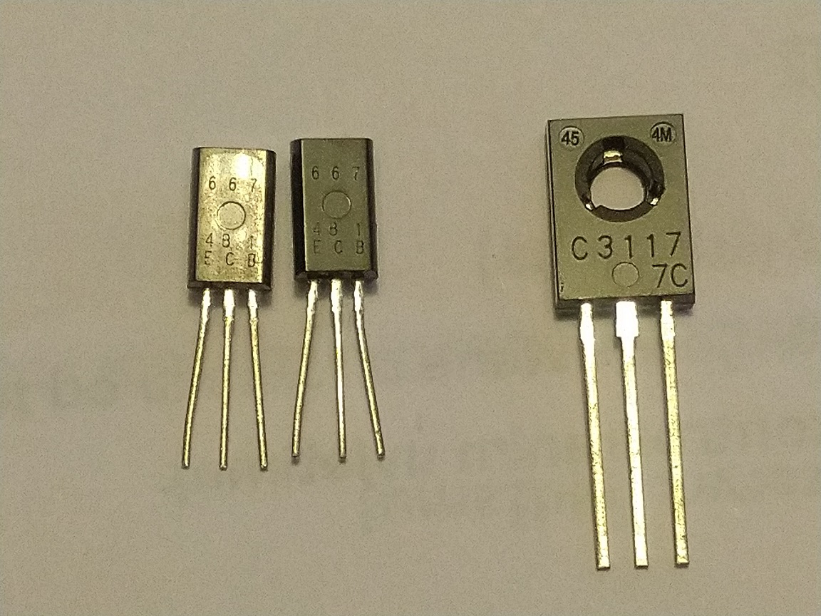

I have some suspicious transistors, the first should be Hitachi and the other Sanyo. hfe is for both ok. What do you think, are they original?
