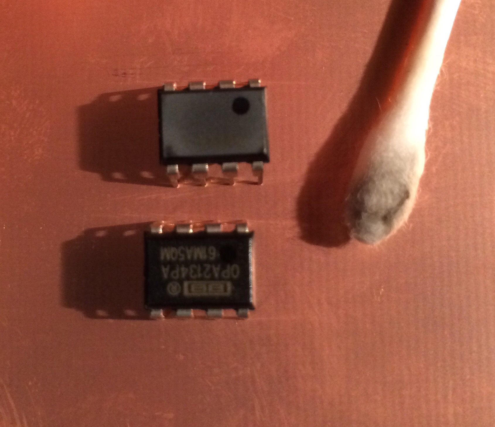

I get opa2604 but I am afraid these are not original because there are signs it is reprinted.
better picture I can not make. Came from eleleparts ebay seller from china.
regards
Here I have some better pic of mine order, I did see on the internet that it has different prints. pic two are the original ones.
Maybe I can test the specs.
regards
regards

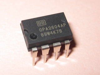

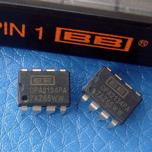

Based solely on the looks, I would take the counterintuitive conclusion and say that the first photo shows the genuine item of more recent production. Yes, the ones with the "wrong" BB-logo. I will explain later.

We have been using this opamp in a particular product for about 15 years or so, and they've always looked like this:
I know, the BB-logo looks odd, but they're always this way and they're always acquired from authorized suppliers. This is on the most recently produced batch.
But you're probably more used to seeing the BB-logo this way:
Left 2008 vintage, right 2011 vintage.
2017 vintage ICs look like the one on the right. Any other exterior, and I'd assume them fake until proven otherwise. Especially the OPA627 is prone to being counterfeited as they are pretty expensive, even when bought in large numbers.
Do you notice anything about the lot trace codes on these ICs?
But beware... looks alone may be deceiving as the better counterfeiters will try to match them as closely as possible.
Even through this may look similar to the OPA350 in my previous post, the rough edges make me think this might be a counterfeit too..
And the lot trace code seems a bit too similar to that of the right OPA627 to be a coincidence...

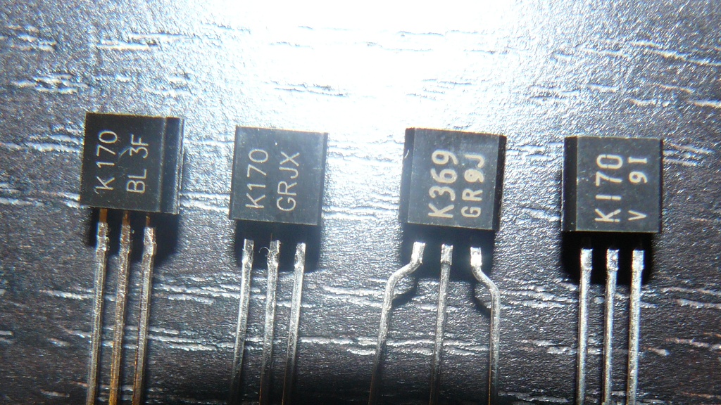

I'll post more details shortly, but I ordered a small amount of BF862s from China. They were sold as "unmarked" BF862s but with my jeweler's visor, I could make out the markings and they did not match the NXPs I bought from Avnet a couple of years ago.
I have a locky_z curve tracer and I took a sample of each. The ones from China weren't even close and there was no typical curve for Id vs Vds at constant Vgs. The NXP graphs were what I expected. :mad:

Yes, the laser engraved numbers are a dead giveaway as well. Any of these old transistor numbers, BJT or JFET, are fake if the numbers are neatly laser etched.
The K369 and right hand K170 lettering looks correct. I didn't check the date codes. I usually buy a low quantity to test, then buy more if they check out okay. They almost never do. Buyer beware!
