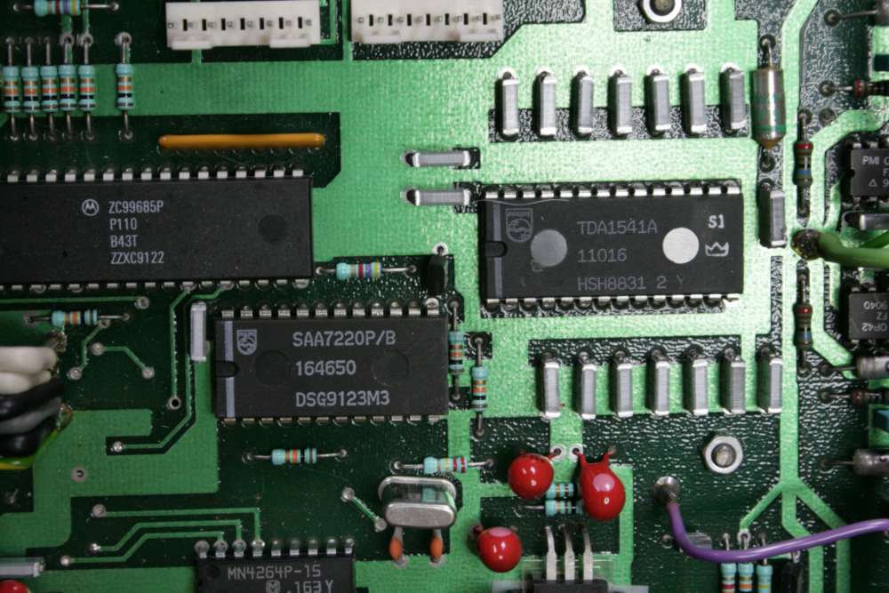

Very nice. I'm a DF / OS fan, so for a kit-style PCB like yours, I'd like to see an option for a DIP-sized DF IC (like SAA7220 or PMD100). The placement of the DF IC is critical, IMO. Perhaps the best commercial TDA1541 machine was (is) Naim's CD2. If you look Naim's IC layout (image below), you may see why their CDPs are decent...

Joined 2009
Nice lookk.!!!
