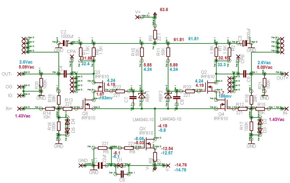

OK, I swapped out the FETs on the right channel. It now sounds lovely but the left sounds whimpy. I have attached a schematic with voltages. Left channel is in blue and right channel in red. All measurement were done with input shorted except for the output test. That was done later with a 1K sine wave at 1.43VAC input.
I replace Qx on the left channel as well thinking it might be the problem but no change.
Any help is appreciated.
Blessings, Terry
