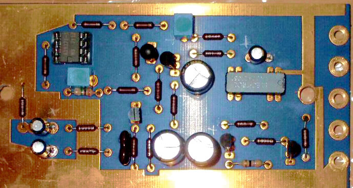

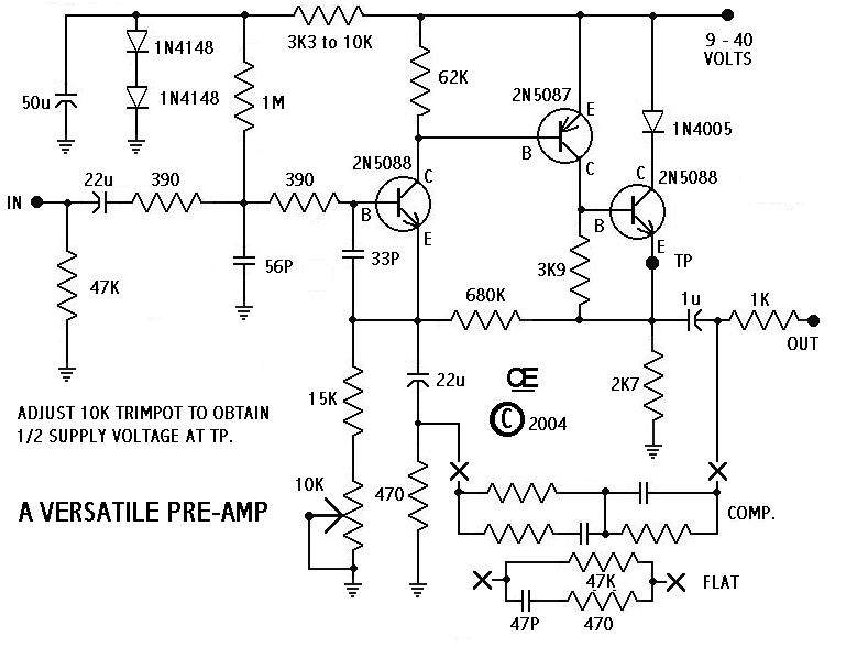

hi
i know this is an old thread
and the preamp schematics is done, but i found this on web and was curious what do you think about it
similarities/differences
what could be modified (diodes out?)
thanks
ed

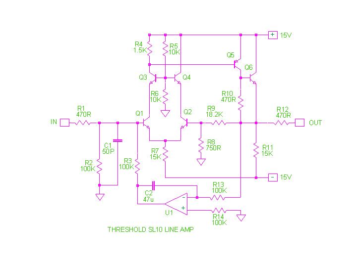

It seems an over complicated design mainly to be used as a RIAA preamp.
If your aim is to test a more sophisticated line amp design I would go with the SL10 which has common mode rejection at the input and no cap on the signal path.
I have redrawn, for clarity, the schematic of the SL10 from Nelson’s site which I reproduce here.
