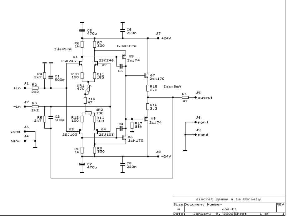

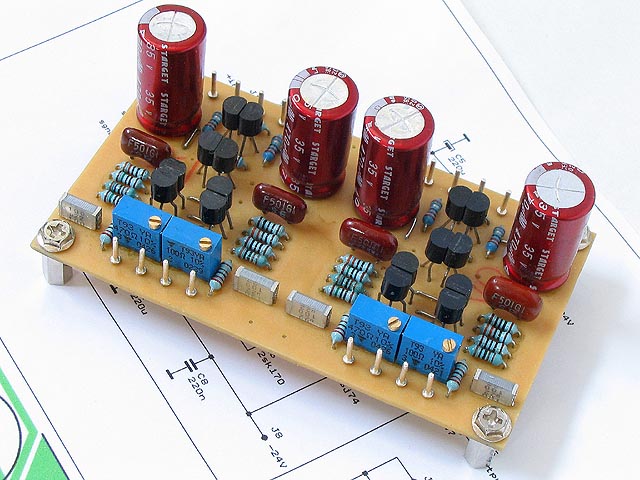

not exactly on topic but.........
My friend Oly is one big (like he like to say ) "Grand Pa Borbelly's" follower ...hehe
his newest "Borbelly influenced" analog stage for sheeeetyyyyyy CD players,usefull also as line stage.....
just a oic for now,I'll try to convince him to share schmtc too.....

steenoe said:
Wow, thats a nice looking friend you have there, Choky!! Seems like a very kind type of guy:cool:
His schematics looks just as nice:) I just love that Borbely kind of stuff:) My solder iron feels like firing up;)
Steen:cool:
Edit: shoot me a pdf of that board and I will give it a shot:) Pretty nice indeed;)

Beautiful link Choky, nice guy and schematics. How come he does a series reg?:xeye:
I think that he have some practicall problems with "missing voltage " inside of some shhhhheeeettty CD player,where he put that stage as finall output; something like 2x15V is available ,so solution was to use what you have ,with generic series regs (317 and 337) ,with something
higher Iq through Jfets,just to compensate....
now we do something together as "dedicated muscular series-shunt reg"......or something like that.....
I always have place (read-another case,if I want) and tooboollar :clown: approach,and Oly is somewhat more realistic than I;we'll see what we will make at the end

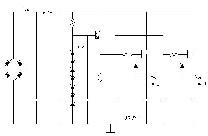

Hi, Choky
I have a great interest in your psu of BOZ, and I am thinking to reinforce my BOSOZ with a similar psu, which is a zener follower + source follower.
How do you and your tube friend Oly see this? Any advice? Tks.
Regards
jh

jh6you said:
Hi, Choky
Regards
jh
you mixed things twice:clown:
tube friend am I,and Oly is SS friend ;)
it's better to use exact copy of my (Oly's) BOZ reg,just because first BJT is also current source for zenner string.....less noise and overall better results
anyway-your version seems functionall ,too .....

I am confused again - my bad habit. :cuss:
Thanks for the reply, tube man Choky, and I believe yours must be good.
I was thinking to use NPN transistor and other components already in a junction box . . . :scratch2:
And, I was thinking that the arrangement of a zener regulation combined with an emitter follower will reduce zenner resistance, i.e. due to Rz/beta, so to reduce the ripple in a better way . . . In addition, the following source followers will purify the output voltage once again . . .
Could you give me a hint how yours reduces the noise?
