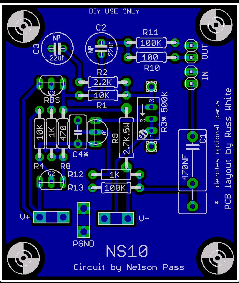

Russ, thats pretty neat. Cant help thinking, if I had a PDF I would etch a couple right awaySingle Side Layout Take II
Steen.
apassgear said:Russ,

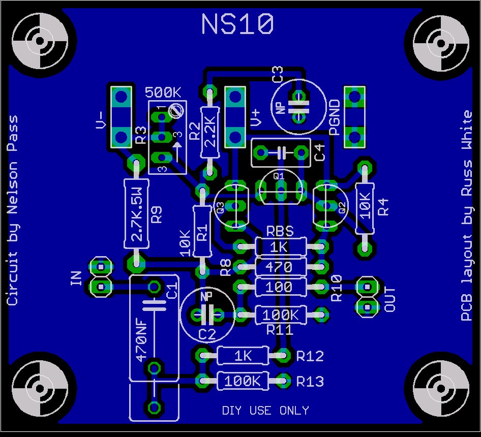

It would be a nice touch if you could squeeze in a small cap at each rail, say 1000u @ 35V on the board, similar at what you did on the xbosoz.
Ok, no problem, fighting a production work issue here, give me a couple hours.
Hi all, there is an error around Q2 on the PDFs. Do not use them I will post fixed PDFs shortly with Tony's bypass caps added.
Sorry if any of you started etching already. a fix is easy, just use a sharpy to make a trace to the positive rail, or if you already etched, just make a wire jumper or solder bridge to the positive rail.
Sorry, should have looked closer before posting.

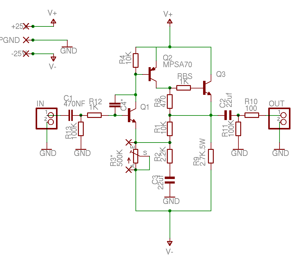

Yes, I noticed that too. I would have preffered at least 1uF for C1. Also C2 being an electrolytic isn't excactly my cup of tea. Maybe a Black Gate NP would be in orderFor some reason C1 seems small for a bpt maybe ok for jfet
Steen
steenoe said:Yes, I noticed that too. I would have preffered at least 1uF for C1. Also C2 being an electrolytic isn't excactly my cup of tea. Maybe a Black Gate NP would be in order
Steen
I used the values lumanauw provided. But that is a 15mm spot, so I know I could find at least 1uf MKP to fit, and even 2uf MKT.
Values given should be looked at as guidlines.
I have not even built one yet, so I have no idea how it will work.
Hopefull one of you folks can fill me in.
