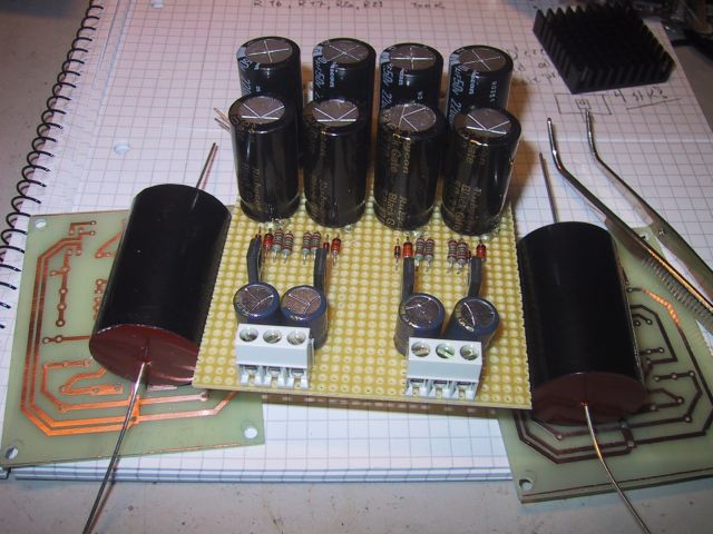

Ok, just to keep you guys from falling asleep:D :D I am working on a more "audiophile"-like version of the NS10. Attached is a pic of Choky's shunt reg supply. One for each channel, ofcourse;) I used small schotky's as rectifiers then 2200uf Nichicons, 100r 2 watts, then some Black Gates. (cause I had them in my box of caps:D ) Followed by good old BD's and 220uF FC's! What do think, will that psu do? Guess it will:) Mainboards will be stuffed with good parts too, you see the outputcaps on the pic:) 22uF MKP's. (Jantzen audio) The rest is FC's and Rifa polyprops and so on;) Will keep you posted about listening results;) I have great hopes for this little linestage, thats no secret:)

if you put 2x100 ohms(instead of 2x120),than your ripple rejection will be smaller and both BDs will be hotter;
you think to put some lil' htsnks on BDs ? :devilr:
in any case-get handy your DVM and measure current for one channel and finnaly give me that data (pleaseeeeeeeeeeeee);
after that I'll recheck values for "proposal" to make it finall solution-at least for my NS10 megaclone:cool:
btw-looks nice:eek: will these sh**ty caps be in air-one leg on pcb,one on back side?
if you put 2x100 ohms(instead of 120),than your ripple rejection will be smaller and both BDs will be hotter;
I just used 100r's cause I had them in my inventory:) If 120 is a must, I have to order some?? Didnt think it would matter a lot, Choky? Yep, I have some heatsinking in mind for those BD's allright:D I am gonna saw a PC heatsink up in suitable pieces;)
I dont think they are that sh###y, at all:) The Jantzen caps won all listenings tests they did in Denmark:) Just so you know!! With brands like M-cap supreme and other stuff like that, Jantzen took the score:D :D Nonetheless, I do intend to make them "Air-suspended" somehow! I might reconsider that, though, and make a more firm attachment:)

nah-just put some 22oms /0.25W on top of each 100ohms and enjoy;
it didn't matter a lot-you're right,but you need every ounce of killing that ripple-don't you think:D

bwah-go to
http://choky.on.neobee.net/My_BOZ.html
and look at second pic from bottom of the page-now you can see what caps are
:angel:
regarding suspension- just make both output caps tight close and put some plastic strips around both ,and then solder
