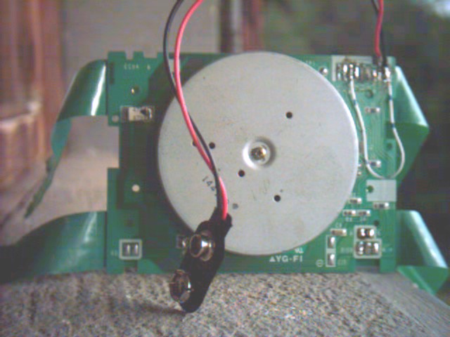

Floppy disk motor
Since I have noise problems with AC motors coupled with the GRADO prestige I tried the floppy disk motor.
I did it for my Project 1.9 , in fact I take the pulley from the original AC motor .
The floppy motor has the same speed ( what a luck!)of the project motor.
The floppy motor is crystal controlled.
For the sound: it is clearly more controlled in the pitch and of course better dinamics.
PS no more noise back from the GRADO prestige even in internal grooves.:cool:

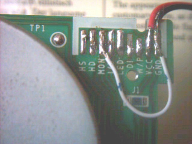

Hello,
The control circuit is under the motor table . Pulling this table (after the removal of the pulley) the chip circuit , the crystal and the coils appears.
To make it working it is necessary ,over the + vcc and ground, to connect a ground to the MON terminal.
This is a relatively old floppy , from the last '80 ,and I do not know if the connection pins are standard.

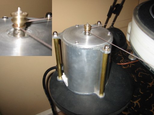

Motor pod finished I blue up the floppy drive motor and went back to a Gerard AC sycrono.I also turned a twin pully for both speeds and I bought the KAB strobe disc and to my delight the speeds i am getting are with in broudcast quility the belt for the moment is cotton If anyone is using somethig else i would like to here your thoughts.

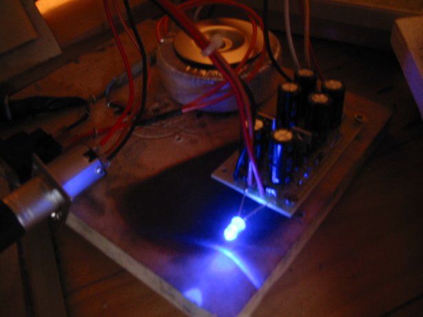

Also have started to do some work on my Phono Amp a new power supply is being tested the curcuit board came from this site http://sound.westhost.com/projects.htm#index First impressions are it is very quite.

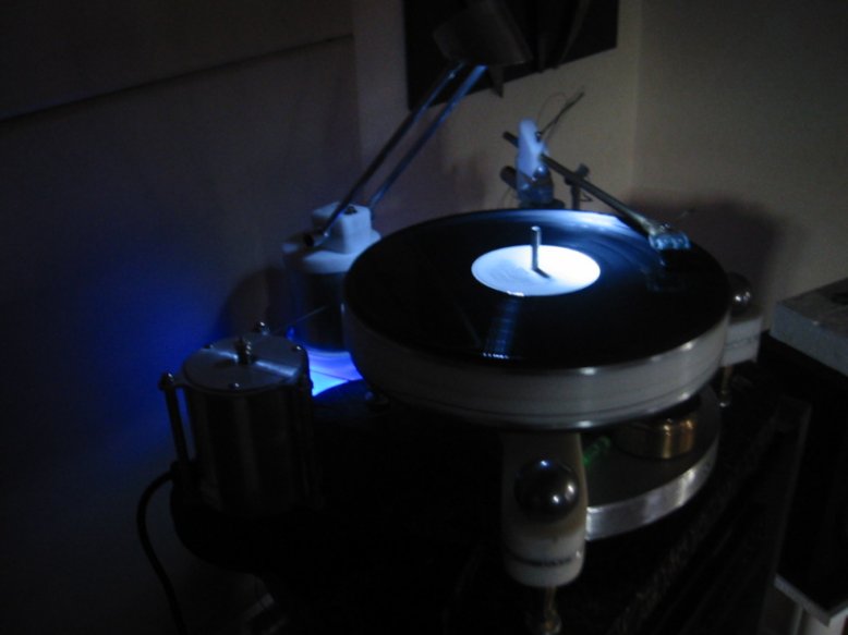

Table finished
HAve finished
I am very pleased with the way it looks the light is all brite LED also the sound is Fab it KILLS my Rega 3 Hearing things on recordings that i know very well very quite. Just need to sort out my PSU.

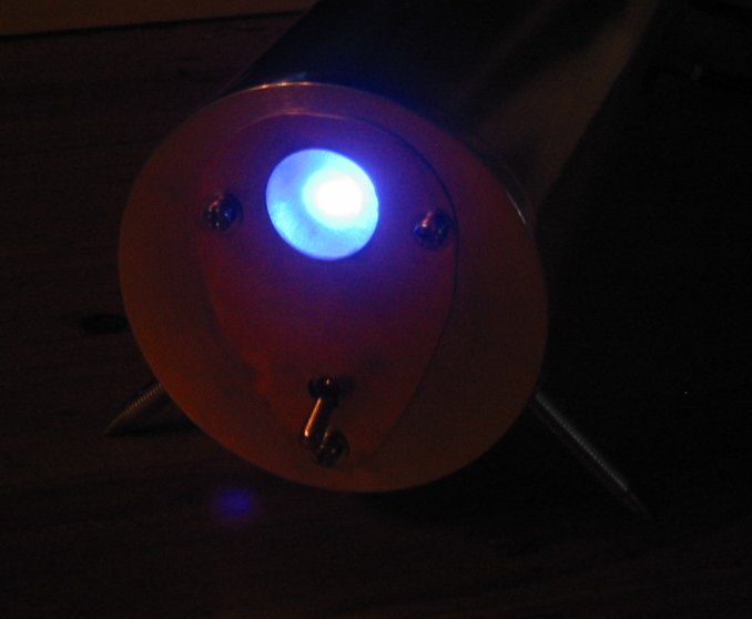

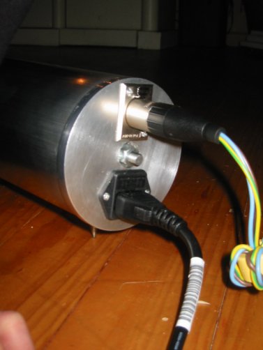

PSU finished
Finished PSU 100mm diameter aluminium 250mm long front and back plate 100mm diameter 10mm thick (pig to drill holes especialy ther square IEC power socket) all held together with 8mm threaded rod. Front face finished with Brass Acrylic window with Blue LED for Power.
