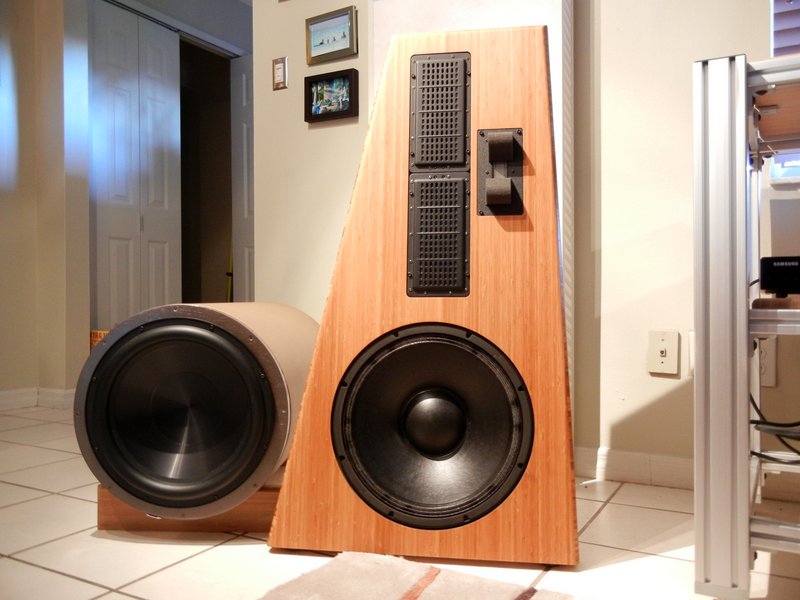

I've got my Raal 140-15 crossed to 2 Neo10 @ 3Khz also. And I do the gradual rolloff into the highs as well. Sounds most natural across a broad range of recordings this way. Unfortunately for me, with the side by side mounting, my off axis is not as pretty as yours.
Nice job! How will the cabinets be finished?

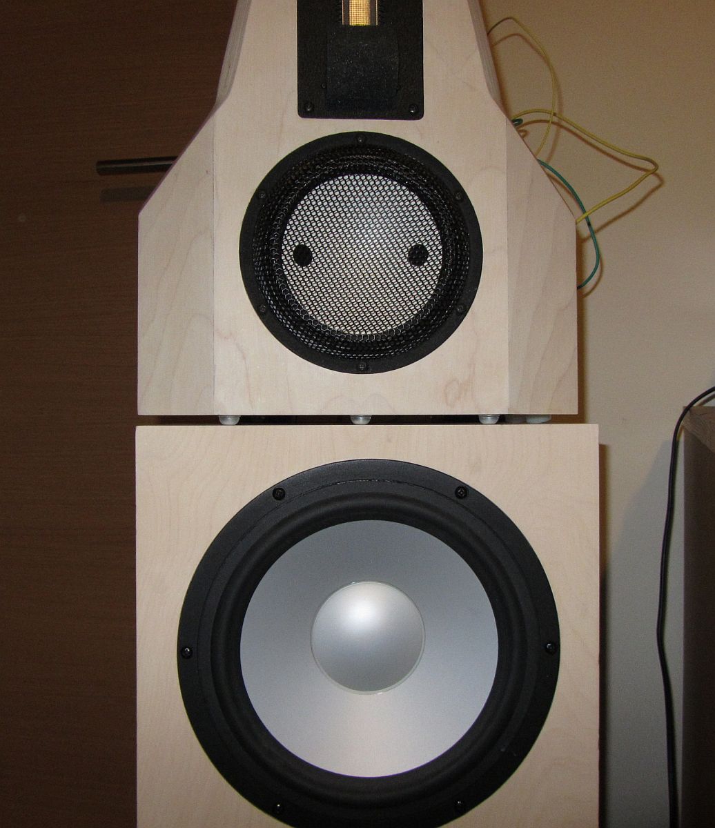

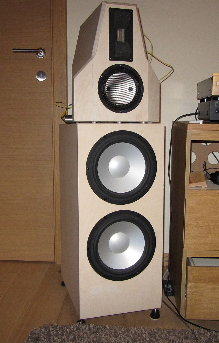

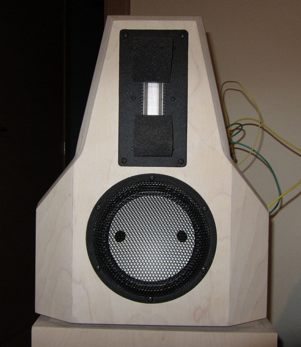

Hi Greg,
The cabinets are already finished :)
The cabinets are in birch multiplex and I like the look of birch, easy finish ;)
But I I have varnished them with three layers of a water based varnish with white pigments to make them even more white.
This gives them a rather white look but you can still see the natural texture of the wood.
Don't use a polyurethane (solvent) based varnish if you want to keep the natural color, because they yellow.
Your built looks great too, should be also very transparent sounding with those Beo10s.

Ah yes, I see that now. Thanks for the pictures. The finish suits the look of the drivers and a clean modern European house quite well. I used the bamboo plywood for it's strength and rigidity, but also so that I did not have to do any veneering. Just some coats of Tung oil and a beautiful finish. Too easy.
My whole project is active and open baffle except for the sealed pipe subwoofers. Digmoda 552 three way plate amps with DSP, so sensitivity matching is no problem. Besides, the 15" B&C in the baffle is nearly 99dB/SPL, so with the reverse EQ for dipole rolloff, it's fine. Then the subs on either side are using their own servo controlled plate amps. Yes, overkill on power all the way around. Just how I like it!

That I did not have to do any veneering was also the main reason that I took birch, veneering is almost impossible with that shaped,winged mid/high cabinet.
Forget about that "clean house", sometimes it's like one big DIY project :D
That's the best setup that you have for open baffle: active with DSP and like you: plenty of reserves in the lows (the most difficult part)
I can imagine that it's sounding very good.

Believe it or not, I've had a few DIYers stop by over the years from very far away when they were on a family trip to Disney World. Good excuse for a speaker geek session! I'm very close.
I'm glad to see that you worked through so many xover revisions. It's really amazing that the average person can now use measurements of his own baffle and simulate crossovers in the computer to be able to get pretty close to a good result right away. This is where a lot of DIYers miss having a really great, optimized loudspeaker. Having to acquire all of those slightly different value components and then the time to reconfigure them all. And even then, you will never be able to make all of the VERY subtle changes possible with DSP. Not for me my friend. I'll take the extra A/D any day to use a laptop and a USB port.
