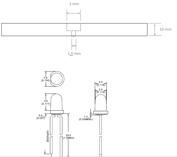

popchops what your thoughts about mounting an 'On' indicator on 'our' case?
problem is the thickness of the front panel
You could do it like this (see attached picture):
* drill a 1,5 mm hole all the way through the front panel
* from the back of the panel, drill a 3 mm hole (for a 3 mm LED) about 4 or 5 mm deep
* insert the LED from the back
* use hot glue, at the back, to hold the LED in place.
The result is a tiny hole in the front from where the light will emit. Use a quite high resistor in front of the LED to limit the current (and light). You don't want the LED to bright. Personally I like a white LED

What about using an ordinary "unmounted" LED @ ~2cents poking through a hole in the front plate. Green for good to go is my code.
Red for a fault indicator.
But the colour is down to the preference of the user.
If the leads are long then twist them to contain any interference that might be on the DC level.

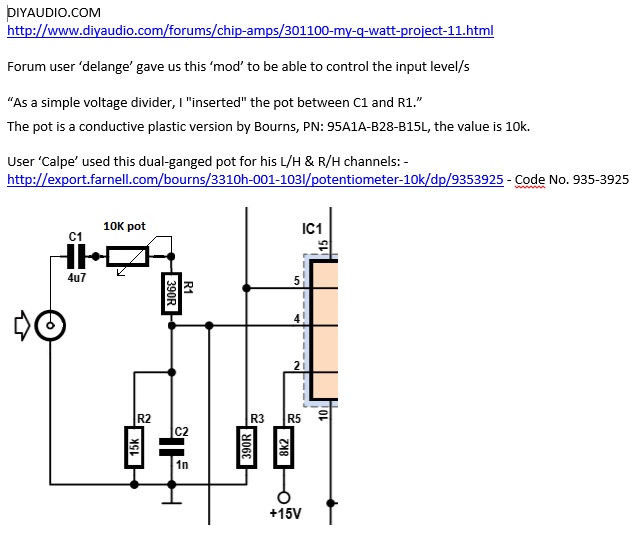

Thanks Delange for your detailed reply. If I have problems with soft start I'll definitely go for a small regulated power supply.
In the meantime I have a question on max DC voltage for the Q-Watt. There are two conflicting figures given by Elektor: 60V (in the main article) and 57V (in comments). I need to know how to dimension the transformer at max mains voltage and low load. Will the Q-Watt tolerate say 58.5V? Then my nominal will be around 55V.

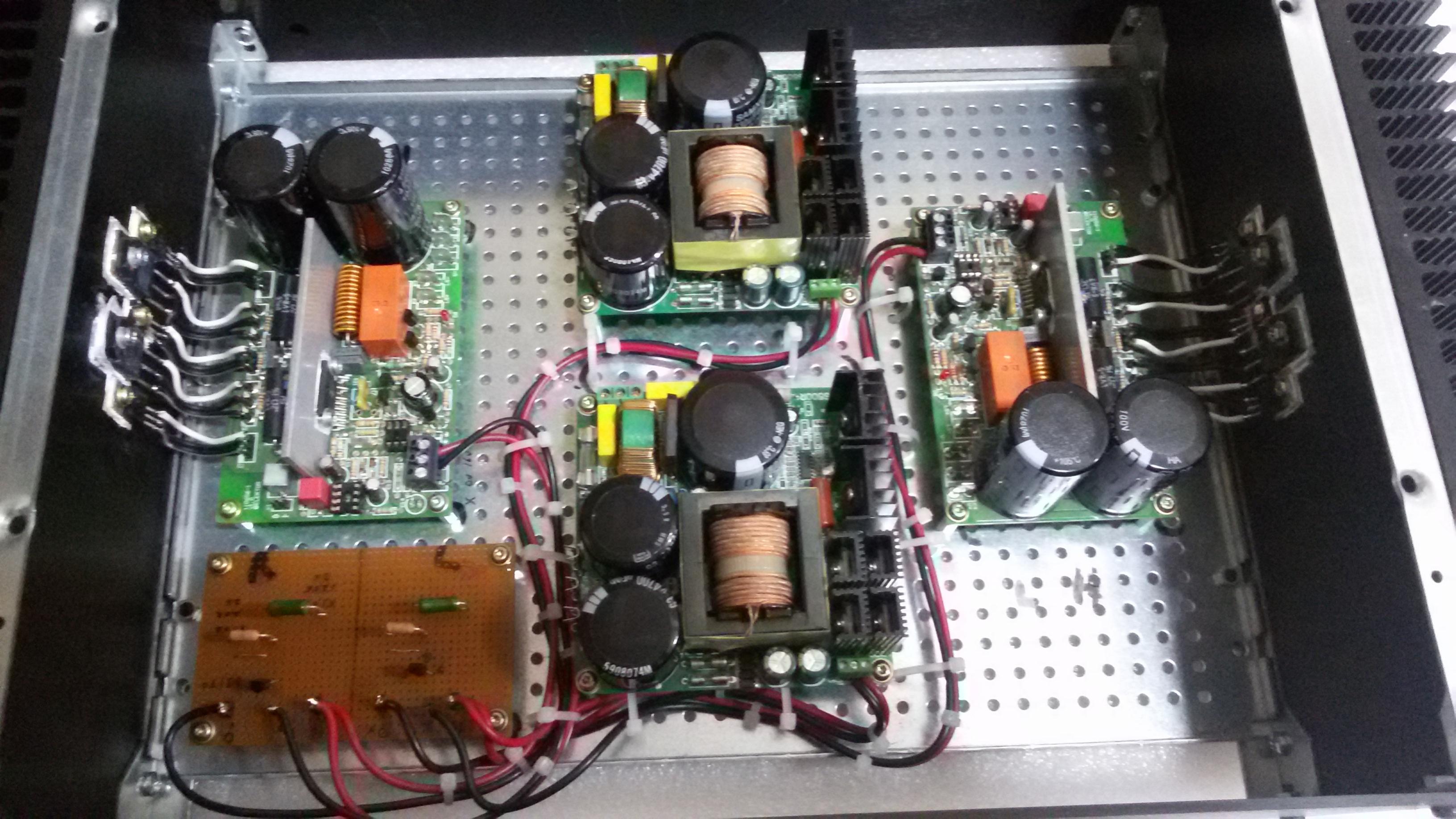

My amps are running of SMPS's who provide ±55 volts.

Can you explain how you calculated these values?
In my opinion, you should first calculate the "deviding factor" (sorry don't know the correct English term) of the transformer:
230v / 40v = 7,75 (deviding factor). So if the mains voltage rises to 240 volts, this transformer would output 240 / 5,75 = 41,74 volts. After rectifying and buffer caps, the voltage would be 58,4 volts DC. This means you are fine with a 2 x 40 volts output transformer.
EDIT: okay, just saw what you mean... To be on the safe side you could use a 2 x 35 volts transformer. That will certainly work in your use case.
