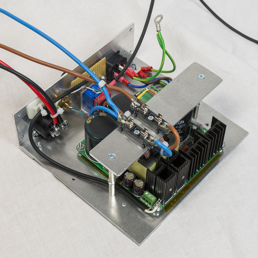

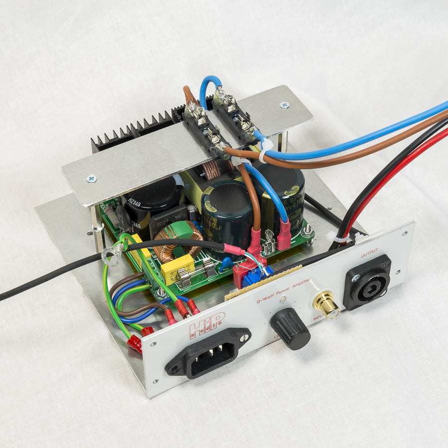

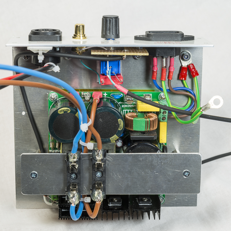

Over the weekend I did most of the mechanical part. Since I wanted to include a power LED I decided to mount the power supply horizontal.
That provides better access to the amplifier itself but also to the connectors at the back.
I still need to add the power LED in the first channel and in order to do that I’ll need to remove the power supply since it is blocking access to rear (due to it vertical position).
I’ll take that opportunity to change the position of the power supply to horizontal as well.
The power LED is a warm white and I’m using a 10k resistor to limit the current and therefore the brightness as well. I don’t want the LED to be too bright…
I will soon start populating the PCB of the second channel and finish the heatsink assembly of the second channel. Hopefully I’ll have some time over the weekend for that job.

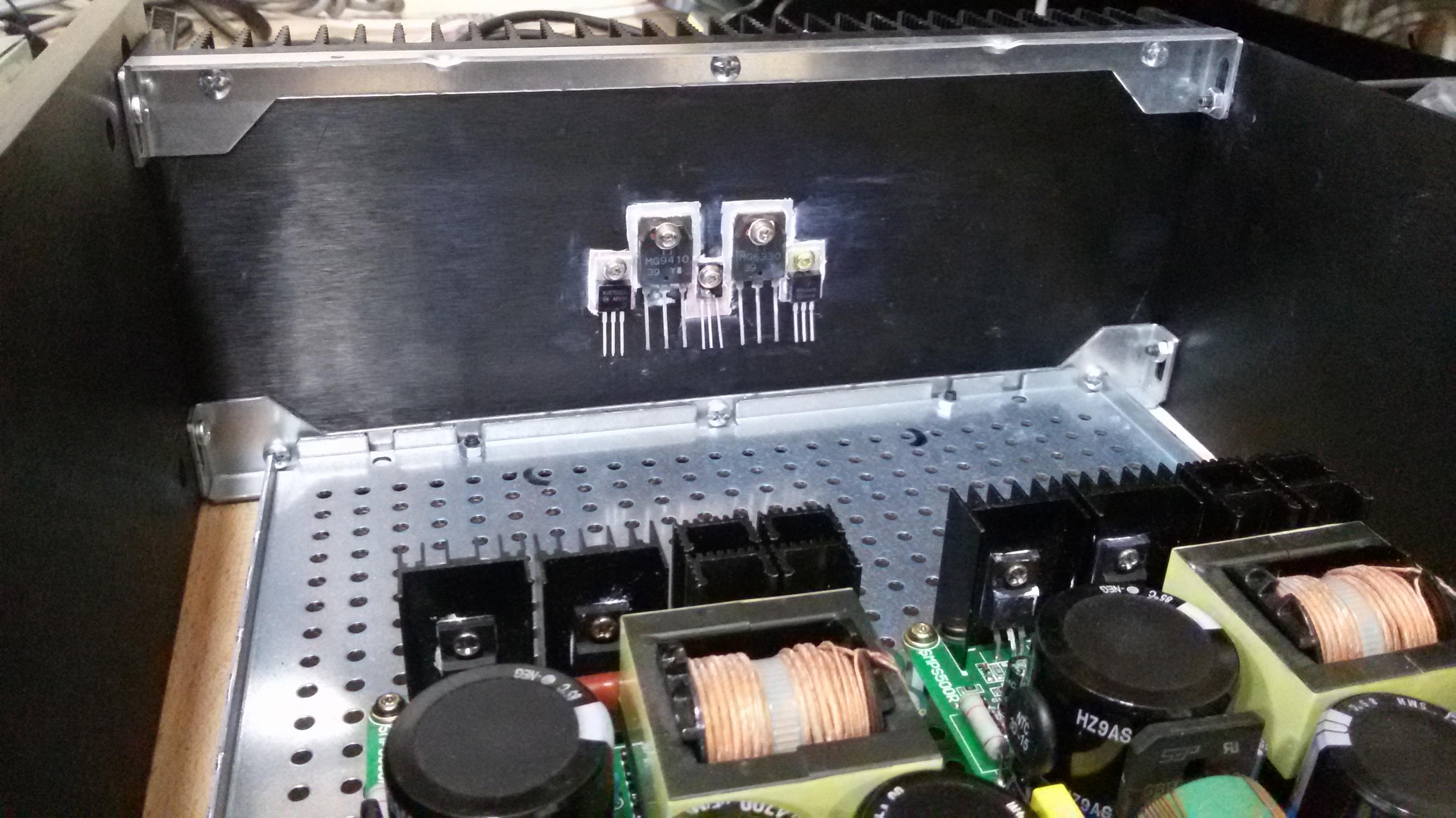

delange, thanks again for the info, have now added it to Farnell's basket with its knob 1209780.
I've got 10 amp anti-surge fuses, so will use these for now.
Can't seem to find a decent looking power switch, will keep looking in Farnell....If i find one might fit it on rear and just have a front led indicator.
Having never drilled to thread a hole, i was very anxious when i began, but its turned out alright, not forgetting to check their insulation afterwards.
Heatsink is a little messy from the heatsink compound...

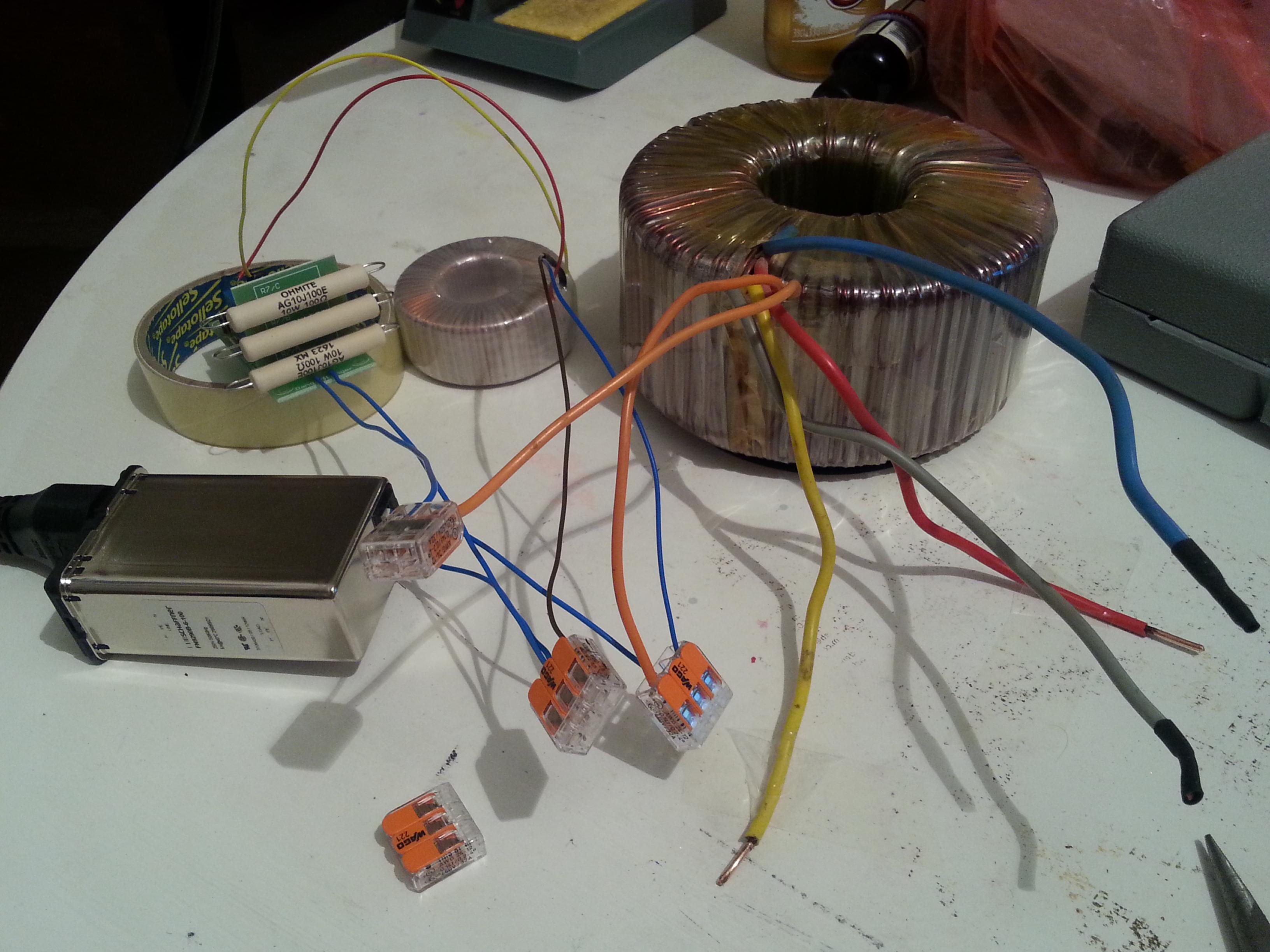

I tested my ESP soft start this week with an ancient ILP 625VA transformer. Starts up on 3.1A fuse no problem every time, and the resistor bank only heats up 1 deg C each start. Takes about 3 mins to lose the heat. I'm using 3x 10W 100R in parallel so peak current to the transformer is limited to 10A for the first few mains cycles. One minor issue with the ESP P39 soft start... it really needs more than 9V AC supply due to rectification losses. 10V AC would give close to 11.5V DC at the relays.

Hi Delange,
Yep I measured 9.3V AC into the P39 board and 10.8V DC on the aux DC output. It has a tiny power supply with four discrete diodes and tiny buffer caps. (I have spare diodes so will measure Vf).
I think it was expected by the designer because Rod recommends a small 9V transformer. This would have about 12% regulation and 10.1V AC ouput at no load. I was scared of overheating relays with > 14V DC so I used an 8.5V (full load) transformer. Gives 9.3V AC whilst powering the board and relays, but the DC is lower than I expected. It could be cleared up if the silkscreen on the PCB said 10V instead of 9V.
I checked the 12V relay spec and I don't think it's a serious problem. Relay will trigger at >9V just takes a few milliseconds longer. And since the resistor network is not getting hot the soft start delay is obviously not 'too long'. Might even save some heat/power in the long term. Relays get quite warm (ambient +15deg) even at 10.8V.
The relay will trigger on 9Vdc. The specification probably shows a trigger value of ~60% of the rated voltage.
But as you have noticed it pulls in more slowly.
If your mains voltage drops as all mains does, you may have non trigger and that will leave your 3off 100r in circuit while the amplifier appears to be operating normally. This is likely to burn out the resistors.
I much prefer to use a higher voltage and regulate down to the relay's rated voltage.
I recommend going further: Regulate down to ~125% to 150% of rated relay voltage and then implement a current saving circuit.
eg, using a 12V 1000ohms relay use a lm7818 regulator fed with ~22Vdc, from 15Vac.
Add a series resistor of ~1k with the relay coil.
Trigger the relay from a capacitor charged to almost 18Vdc.
Then after the cap has discharged the coil current drops to ~9mA.
The relay runs cool and fires quickly and operates properly from all supplies from 216Vac to 253Vac.
You may find that the 625VA+33r33 soft start will reliably start up on a T2.5A fuse. Personally I would have used 4off 10r (in series) as the soft start added resistance. That would definitely start up on a 253Vac supply using a T2.5A mains fuse.
I should get 9.4V DC even with 210V AC mains supply. And I went for 10W resistors which gives me a little margin for timing error. I'm not happy about being 1V off target though.
I love the sound of your regulated supply with a burst of current to trip the relay. Very smart. I'm only becoming aware of voltage regulators now... so for this project I wanted a lo-tech design. I will file this one for later!
3.1A was the first fuse I tried... for sure I will try going lower for final installation. You might remember that the ultimate objective is to start 2x 432VA(ish) transformers. The 625VA is just to test out my design and measure the voltage losses before smacking up Paypal (lesson learned :-D).
