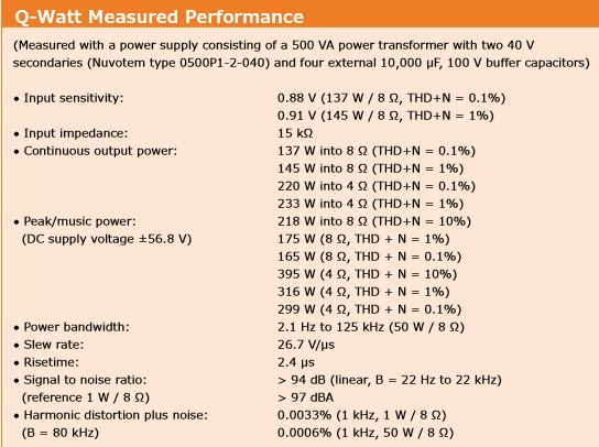

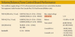

A query on the output level of the Preamplifier 2012 (Elektor April, May & June 2012) & input level on the Elektor Q-Watt Power Amp (Elektor September 2013).
As there appears to be quite a high level output from the Preamplifier 2012, if it's connected to the Q-Watt then there appears to be a 'mismatch' of levels.
Can something be done to keep them in line, otherwise i fear with the Preamplifiers volume turned up to a high level it could over-drive the Q-Watt.

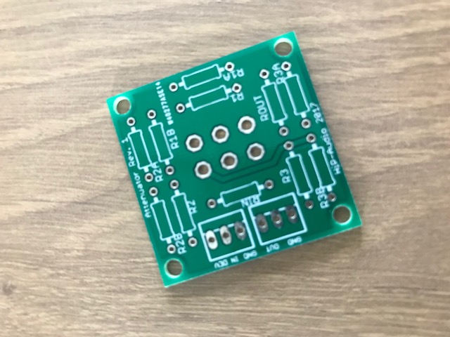

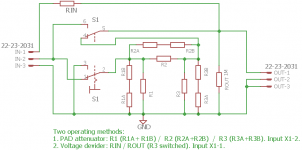

I forgot to mention: the attenuator I use is 20 dB (I have built it inside my Q-Watt amplifier and can be disabled with a swtich). I have created a small (universal) PCB for that but you could just as easily build it on a small breadboard PCB. I use a PI-Pad type of attenuator.

I made the small PCB to be universal so I can use it in different projects.
It basically features to functions: a PI-Pad attenuator or a voltage divider. In both cases there is a switch to allow for two positions. In this particular case the switch would select 0 dB or 20 dB attenuation. The schematic is attached.
For the 20 dB PI-Pad I used with my Q-Watt, I used following components:
R1A = 30k
R1B = 150 ohm
R2 = 5k
R3 = 240 ohms
Rout = 1M
The above resistors are metalic film 1%
The rest of the resistors are not populated.
The DTDP switch is mounted at the solder side of the PCB.
The input connector is wired as following:
IN-1: not connected
IN-2: signal input (connect to output of preamp)
IN-3: gnd
The output connector is wired as following:
OUT-1: signal output (goes to input of Q-Watt)
OUT-2: gnd
OUT-3: not connected
