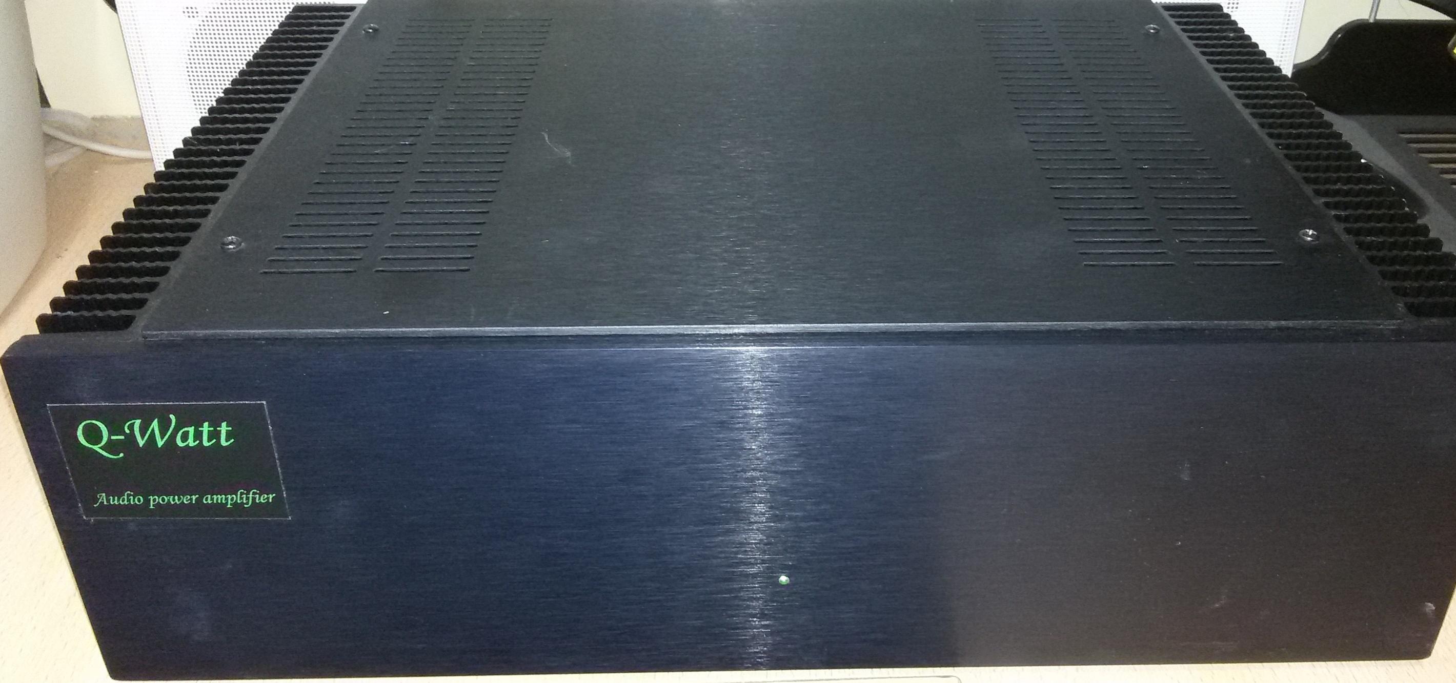

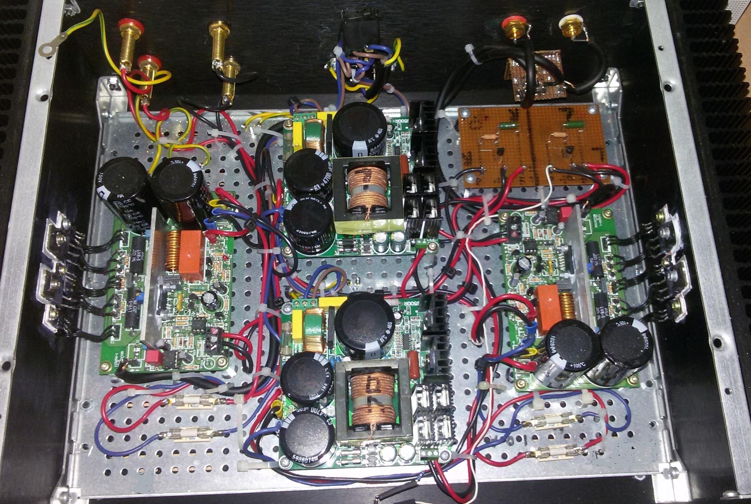

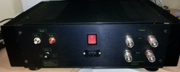

Although my Elektor Q-Watt has been up and running for some time, pumping out great quality sound, here are some images of my beast for the late builders.

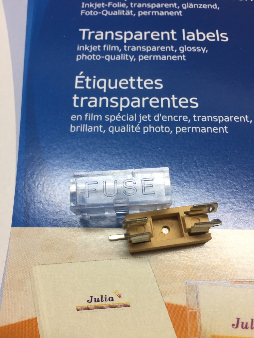

A few comments with constructive criticism, the labels at the backside are not really nice, if I can give a suggestion, why do you don't use transparant labels, it is easy to make with for example Photoshop print it and you can stick on the back without problems.
The transistors with wires on the heatsinks is contrary to what others said in my opinion a good idea because the expansion of the leads while warming up is now no problem anymore. If they are direct mounted on the print it is possible that cracks arise at the soldering joints sooner or later.
The fuseholders don't have covers?
I'm still very satisfied with my Q-Watt in the old Marantz 250 case and I intend to build a second again in the case of an old Marantz SM-6.

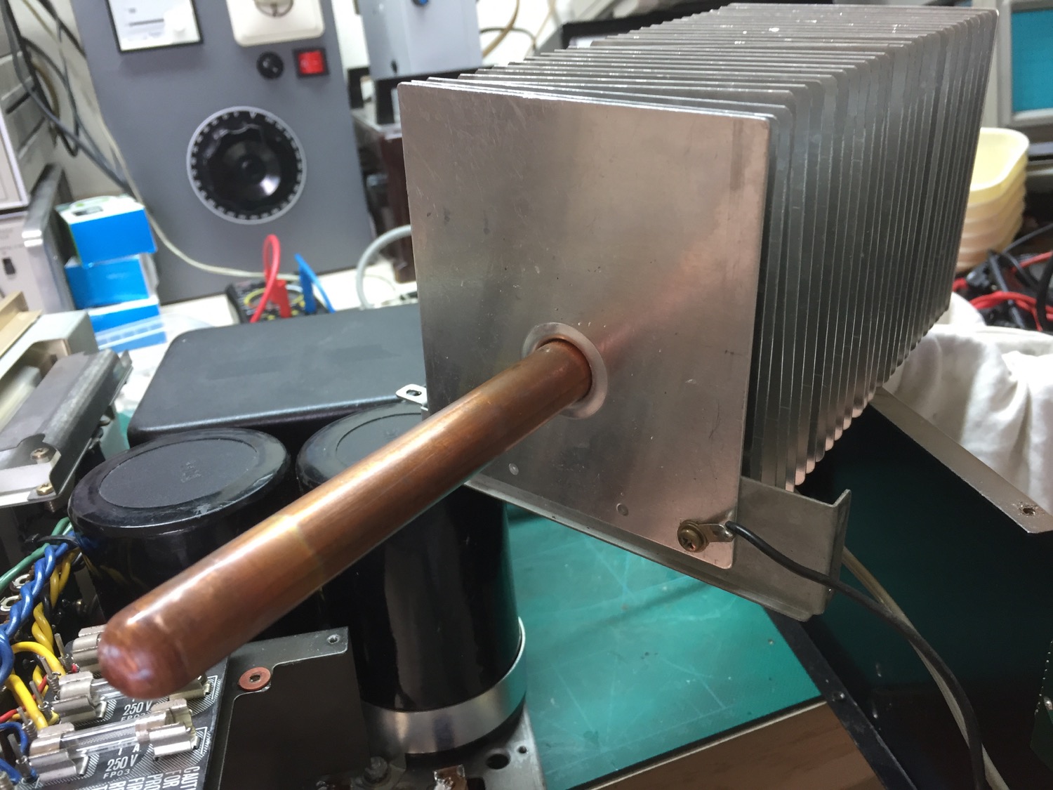

This amp has as cooling a heatpipe, I think it will not be easy to fix it but I'll give it a try.
Anyway I wish you much 'Listen' pleasure.
