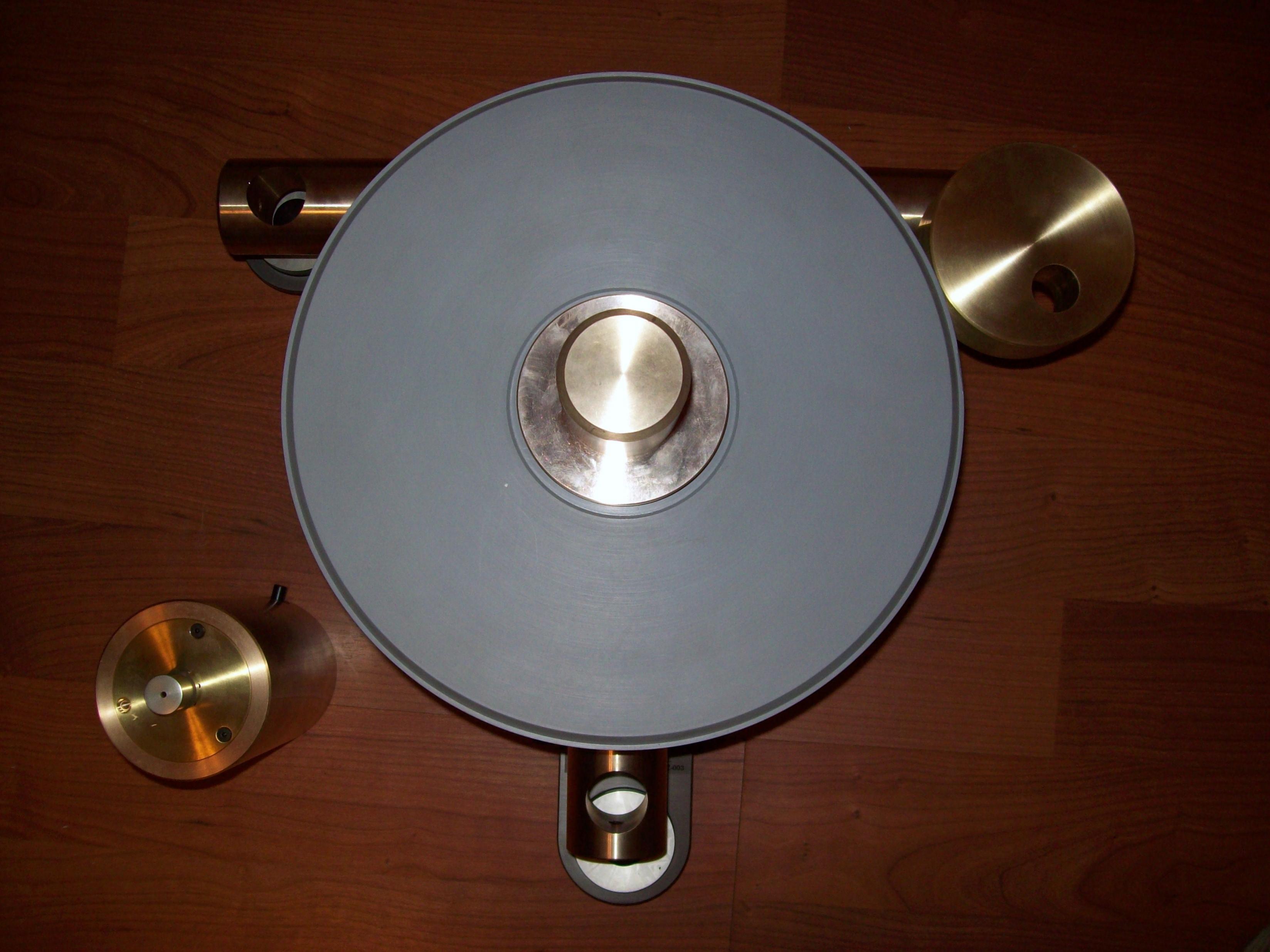

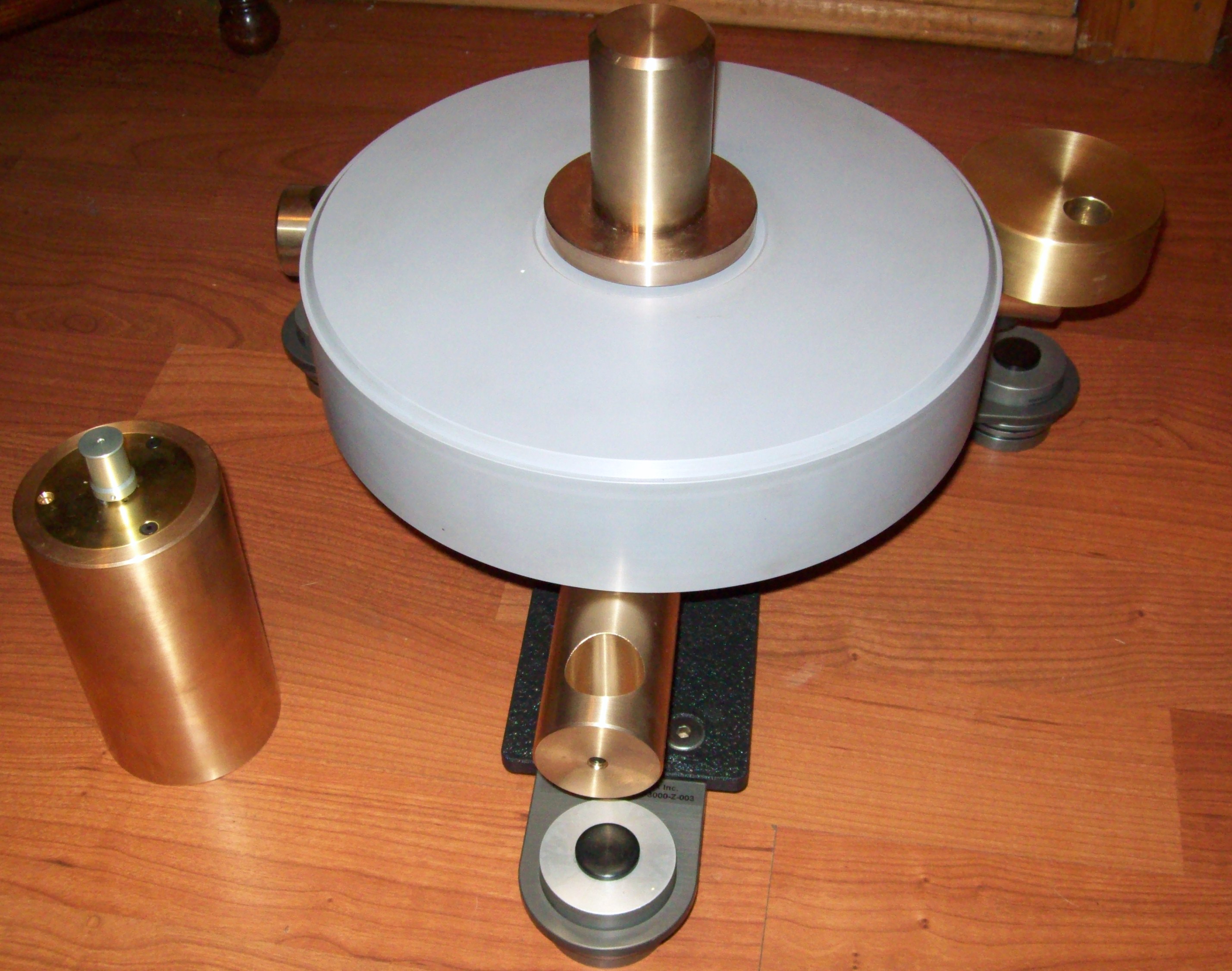

I do have original tape pulley but with this foolish idea of mine ,to use fairly rigid suspension platform from zeiss microscop it may not work. I will need either rubber belt on tape pulley or thread pulley. I think it will be impossible to use tape on slightly bouncy table. Anyway I'll check how it sounds with suspension and without it, and also with different than this Kuzma inspired base (MDF or acrylic).I do not hold my breath about resoults at all ,just want to get over with after all these years
