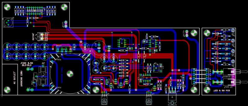

Here the PCB. The notch on the side is where the 2.2AH battery will be located.

Indeed. My only limitation is the PCB material, 6"X9" double sides.
Thanks for your kind comments.
Just verified it yesterday and made a few corrections. If your schematics was exact, it should work nicely. I can send you hires images or pdf or gerber of the PCB if you like.

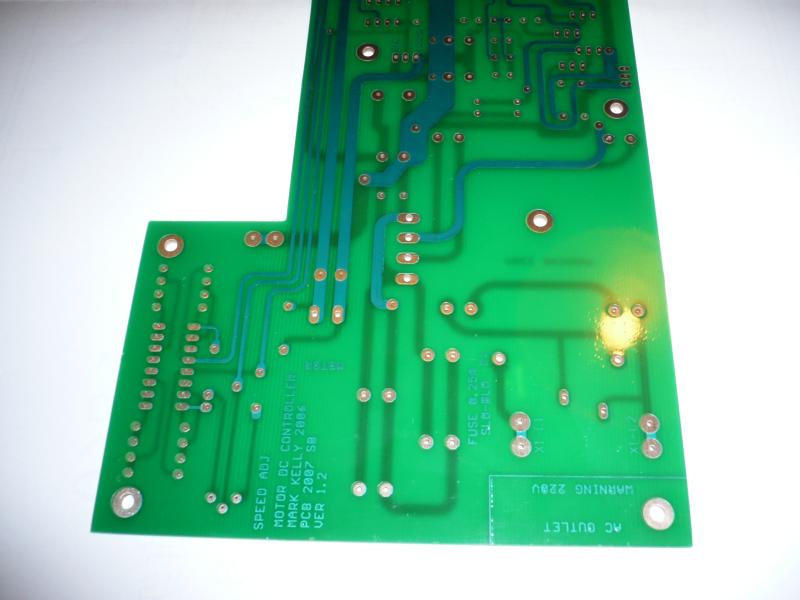

The prototype is about 50% tested. I found some corrections to be done on the PCB. The last version 1.2 will incorporate these corrections. I'm working on the enclosure. It will be done in birtch plywood to match my turntable insulation platform look.

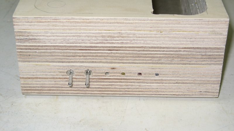

This is how I built the controller enclosure using slice of birch plywood. I started with the sheet of plywood cut to dimensions. Then using an hole saw for the corners and a router I removed the inside. Finally, I glued the parts together to get the enclosure.

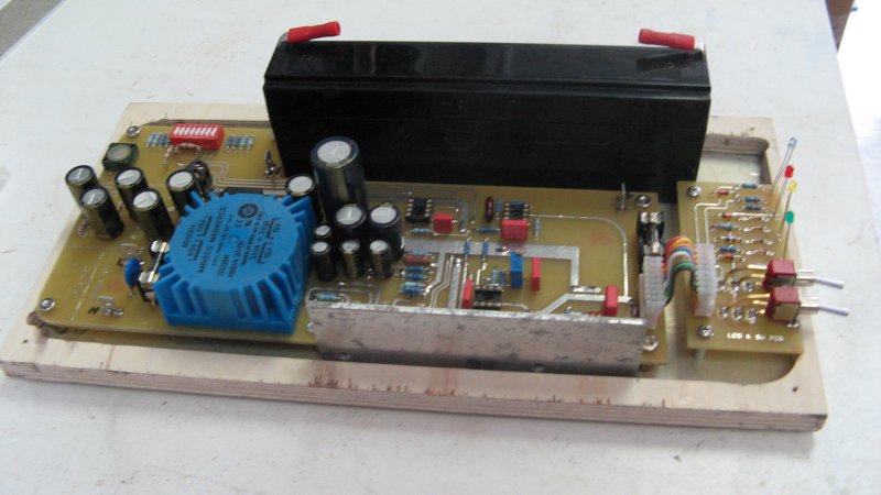

Here the PCB's fitted on the base plate with the battery, before I assembled the casing slices.
The enclosure's top will be made of a sheet of brush aluminium. The bottom is rigid, made of 1/8 alu. The transistors heatsink L-Shape piece of aluminium (seen on picture) further increase the base plate rigidity.
The Led & Switched small PCB can be seen on the front. To access the inside of the controller, I just need to unscrew the base plate and slide out gently the base plate. The front PCB allows the led and switches to just slide-out of the front panel.

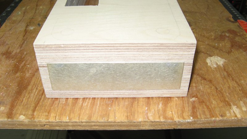

I installed a rear plate on the back to receive the connectors. I will also have access from the back to the speed multi-turn adjustement potentiometer. The piece of alu is inserted into the wood for a better look.

I'm gald to report that I completed the testing of my prototype pcb and corrected the few mistakes that I made .
The circuit is working just fine with a small 12V motor. I will try it this weekend with the real turntable if possible.

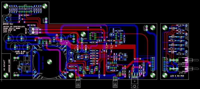

This is the latest version of my PCB, ver 1.2 that include all the corrections. I also added a fuse for the battery and reduce the pcb lenght.
