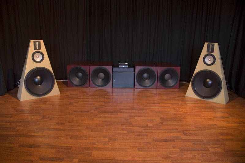

For a time I tried this: dipole 3-way with closed box subwoofers. I did not manage to integrate the subs properly, regardless of crossover frequency. They just sounded different than the dipoles.
As per Dr Geddes and Rudolf, you may try to asymmetrically distribute the 4 monopole subs in 4 sides of the room. Or how about the DBA concept as you already have 4 monopole bass units.
I don't have the monopole sub's any longer, so I really cant do that.
I have however four dipole woofer towers that are distributed to some degree - two centered on the front wall, and one on each side wall.
This distribution has virtually no effect on the frequency response in the listening position. The response from the two center woofers is the same as the side woofers, only with slightly less level @ 20 Hz from the side woofers. This lack of difference in response is possibly because they are dipoles, and I expect it would look very different with monopoles. The dipole's frequency response is not affected by the fundamental room modes in the height and width of the room, although the modes are triggered to some degree.
I have had a lot on monopole woofers in my room, and they all required a lot of EQ to obtain a flat response. The dipoles don't.
Subjectively I have no doubt that dipoles sound better in the important bass range from say 40 to 150 Hz. To my ears, and in my room. Purely subjective of course, but I'm not alone with this experience. Other listeners have said that the dipoles produce a totally different type of sound than monopoles, and I agree with that.
That being said - I do have a distributed monopole woofer setup (eight 10") in my home theater that works pretty decent. They can shake the whole room on movie soundtracks, a thing which dipoles simply can't do.

- My open baffle dipole with Beyma TPL-150
