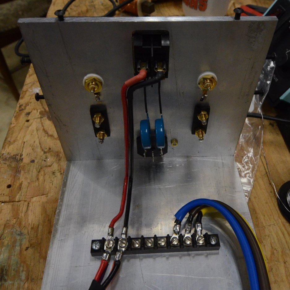

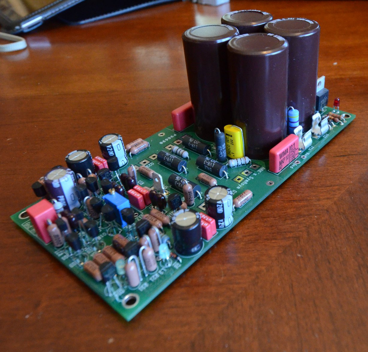

Greetings all,
I thought I'd share my 1.3 DTV build progress with you all and get a few questions answered.
I used LSK370 because I had them from another project. I even remembered to reverse their direction on the board
I'm running off 27v rails; a bit low, but I think it should be okay.
I made an error in my parts order and ended up short a few caps. You can see my replacement in the first picture below (hint: it's bright yellow).

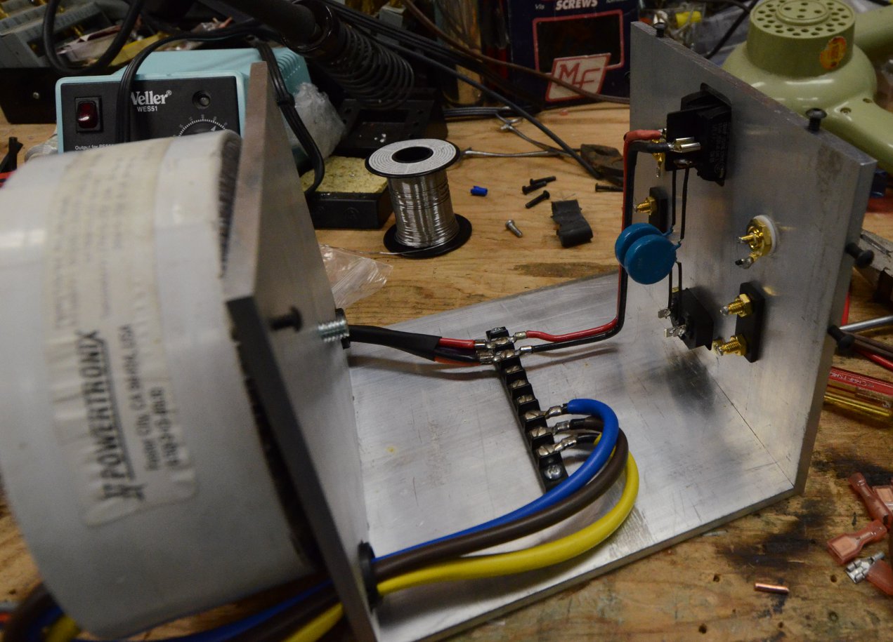

On to my question. In the assembly instructions AAK says to connect one of the on board ground pads to the heatsink. Instead of doing this I was considering connection my CT to ground (maybe through an NTC thermistor) at the terminal block. In my mind this creates something of a star ground. In the photos below CT is the blue wire. I still have to run ground from the IEC to the block and ground the chassis. Thoughts?
I will be posting more pictures when everything gets up and running.
Thanks all,
Nelson
