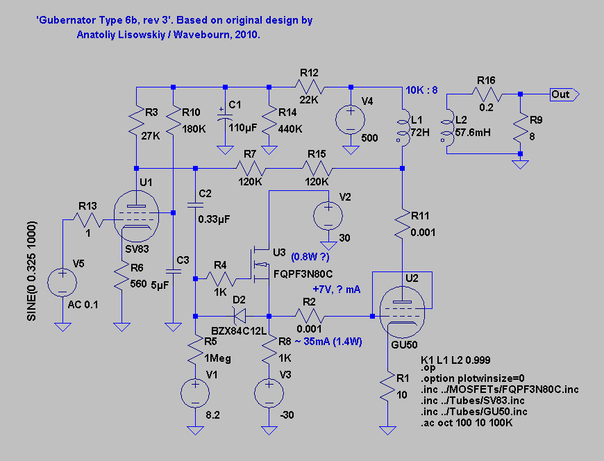

My new GU50 SE (all pentode)
You may try also in right-handed triode mode. It is similar to pentode mode in terms of curves and high anode voltage allowed, but needs positive drive of the grid (all grids connected together)
