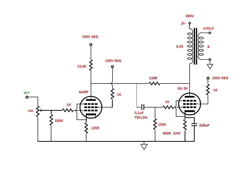

My new GU50 SE (all pentode)
Doesn't 0µ1 on 100k cutoff the bass to high?

No, with bypassed I have to much gain and no difference in sound. I must find the right NFB resistor, but right now I am out of 110K-1M resistors.
"No difference".....interesting. Pentode without cathode decoupling yields gigantic output resistance. What speakers do you use ? Open baffle ? With my bassreflex speakers this would be impossible.
Nice looking build, and I like the use of the regulated screen supplies. I am inclined to jump on the bandwagon suggesting a lower feedback resistor value instead of an unbypassed cathode resistor. By quick and dirty estimate, you are getting a plate impedance of around 4kOhm with the bypass and 10kOhm without it given the current feedback scheme.

My new schematic:

My new schematic:
I simulated your circuit a little. I had to use 6j9p as a voltage amplifier because I do not have 6j49p spice model, but those two are similar tubes, basically.
I got as follows:
- Open loop gain (no 110k feedback resistor) = 34,2 dB
- Closed loop gain = 25,2 dB-----> NFB = 9 dB
- Pmax = 13 W @ THD = 9,6 %
- THD = 3,1 % @ 2 W
- Zout = 4,7 ohms.
- Quiescent current of GU-50 = 70 mA, Ig2 = 5 mA.
Are these close to your results ?

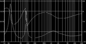

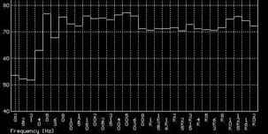

Artosalo I have listened to one those systems. I know what I am talking about. I don't need drawings and speculations. No offense. You can say what you want but the bass from that system I listened to was simply one of the best. No emphasis at all. There are also in-room (a normal one, without special precautions) frequency responses shown and they don't look anything different from usual.
These measurements represent the impedance and the in room frequency response of the Rebus speaker driven by the Paradox amplifier (Zout = 27KOhm).
Where is such 6 dB peak?
