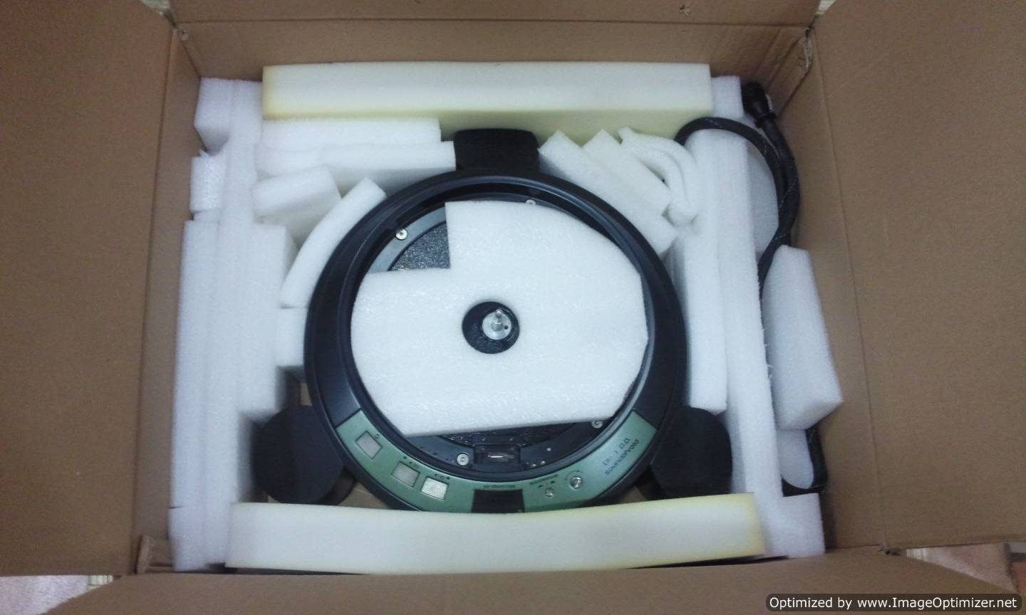

It's now packed.
In two big boxes-one wooden/carton one to carry the main chassis and a double carton box for all the smaller stuff.
About a 70Kgs in the big one and 30 kgs in the small...
It has been a long and very stressful build as i had to meet certain deadlines
and always something happened to push be back.
Having to do with all these vendors and parameters is exhausting.
I just wish the owner will enjoy it as much as i dreamed about it and sweated on it's details.
I now need to take a breath before doing it again...

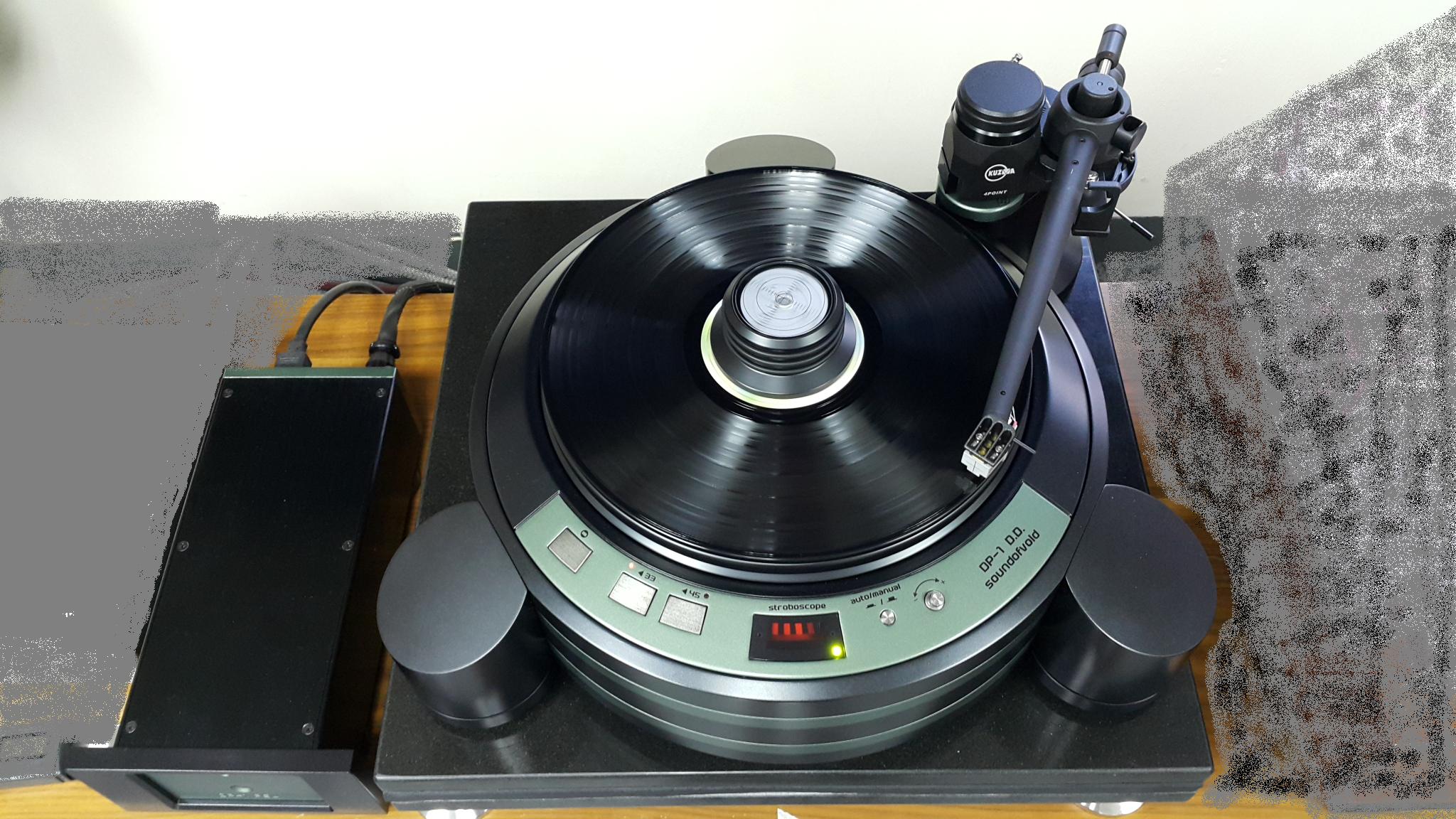

His comments are very favorable so far...
He has made a note of the bass slam,solidity of image,quiet operation and lack of feedback even playing at very high volume levels.
He is in love with the periphery ring and the things it does to the sound.
After testing with and without he said that he can't think of playing another record
without it.
And sent a photo of the setup...complete with two granite plates with damping material in between and the finite elememente adjustable feet...

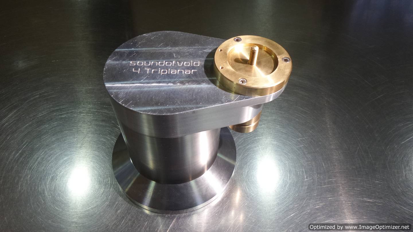

It has been some time since there was an update on the subject...
The dealer in question after having spent six months testing it, has decided to present the turntable at the Hong Kong audio show (7-9/Aug) and asked for a second tonearm base...this time for a Triplanar VII arm.
He provided me with the measurements i wanted and i have asked for the arm's base collar to see if i could improve on it.

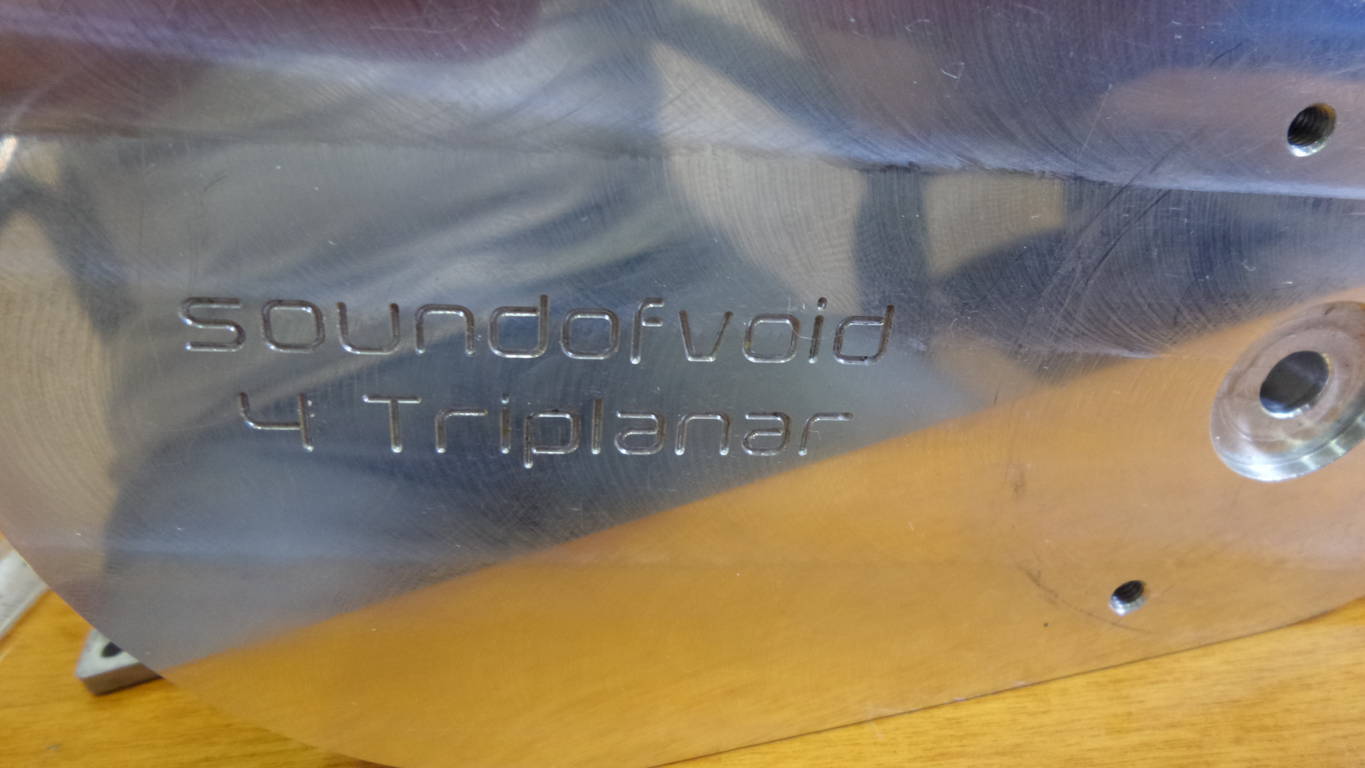

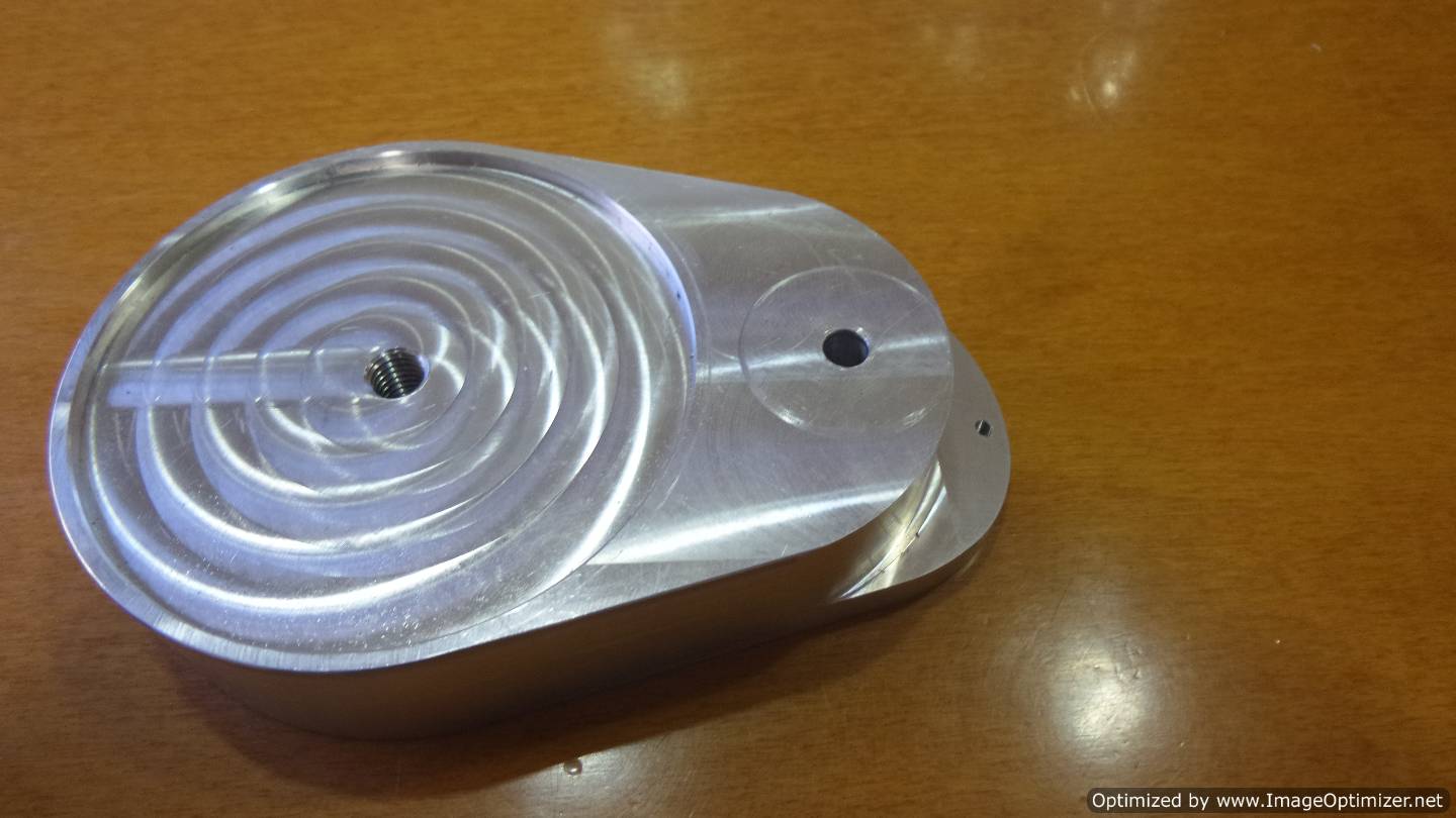

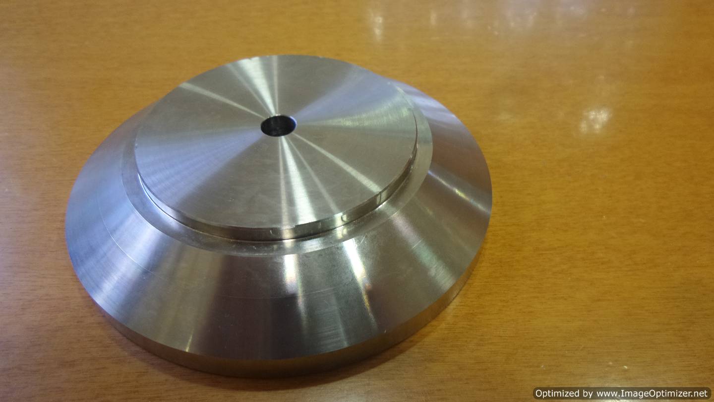

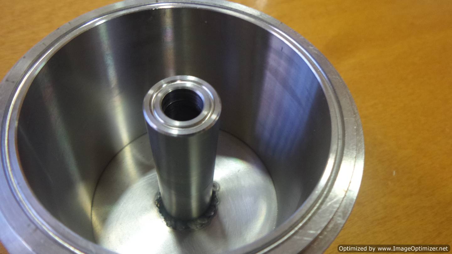

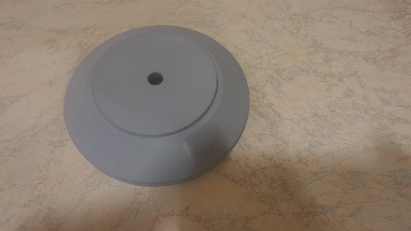

Having time to rethink some aspects of the original construction i have done some alterations to the original design...keeping the external look identical.
1) I used a thicker wall (10mm vs 5mm) main body.
2) I have incorporated o-rings on the top of the main body under the top plate to prevent oil spill in case the base is inversed during shipping - it has happened!
3) I have asked for welding of the base and central cylinder to make sure everything
was leak-proof. In the prototype they were epoxy-glued together.
All parts were cut from inox except for the top plate that is aluminum.
I would have liked cutting the base part from bronze but that would add cost a bit more and i was working against a specific price point.
Some other parts having to do with the securing of the tonearm were cut from solid bronze.

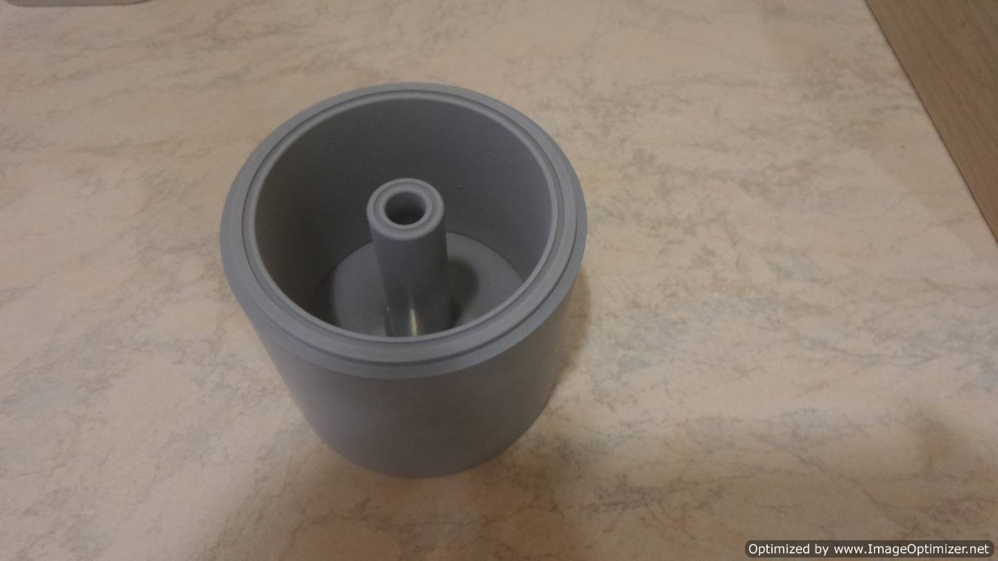

This is what i received for the main body...

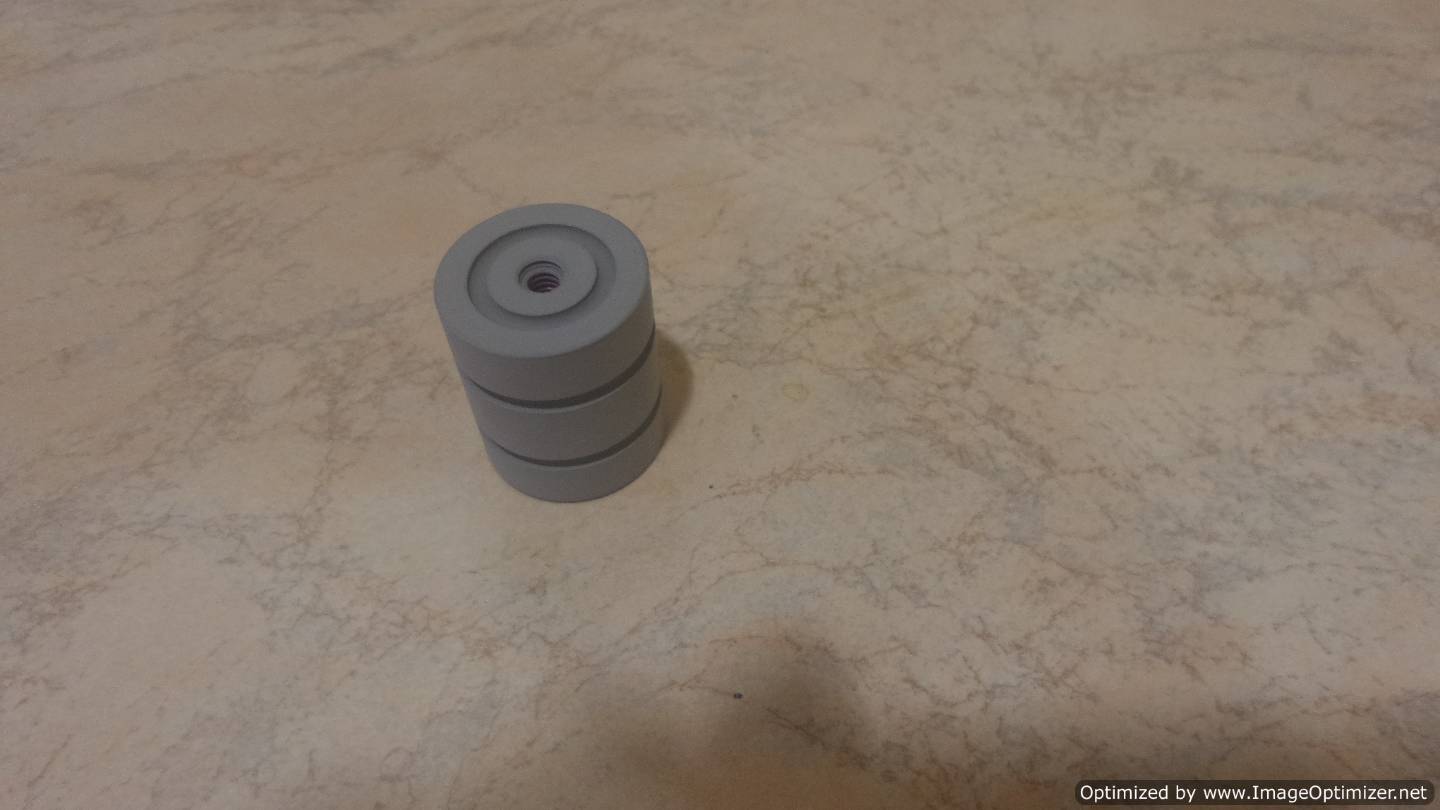

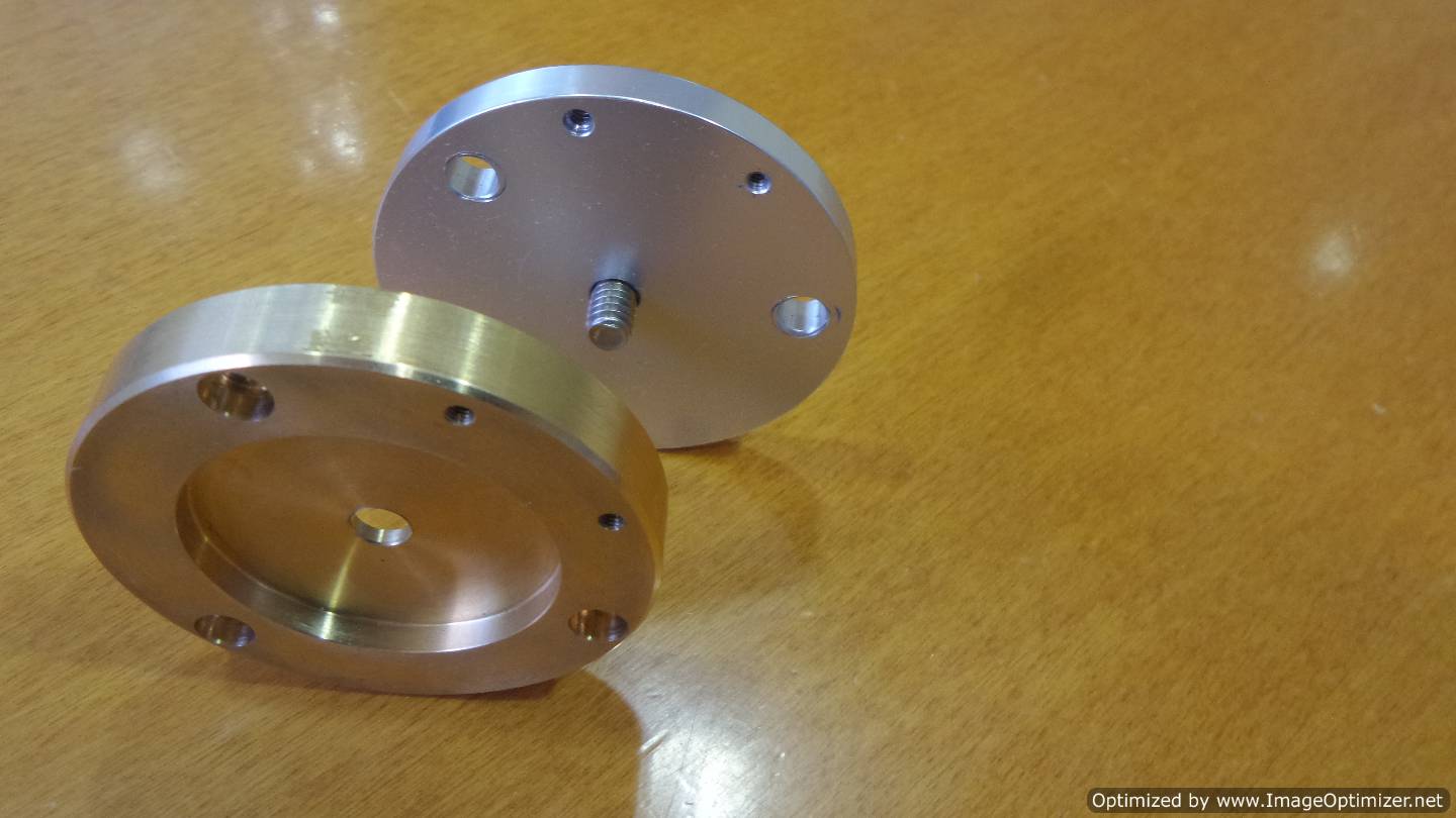

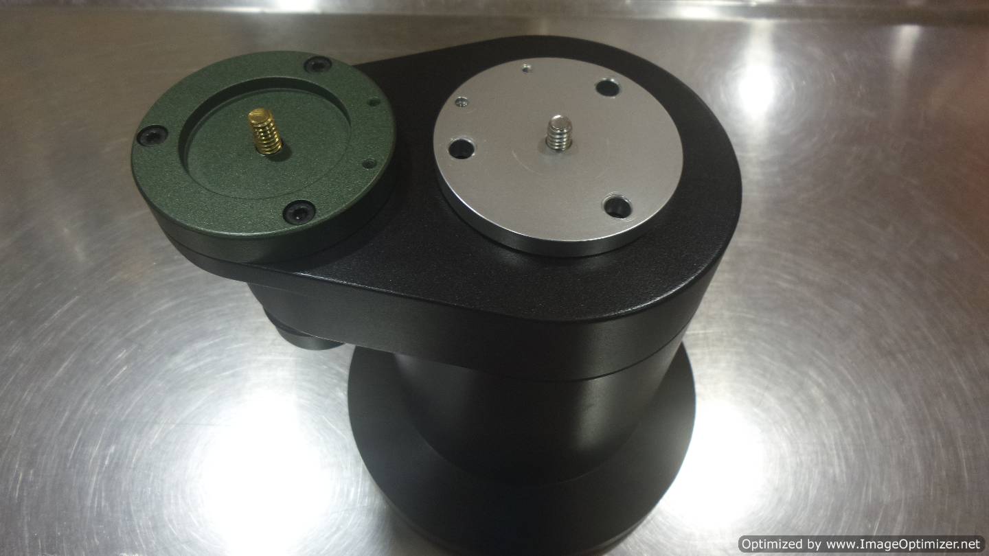

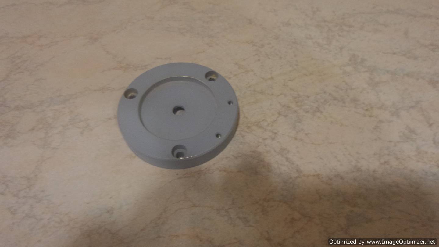

I have cut from bronze all the parts having to do with the fixing in place of the tonearm.
A new collar with an o-ring on the underside (to aid damping), a long headless screw that would replace the original one and a round stabilizer weight that would screw against the underside of the top aluminum plate.
This will have a thick o-ring incorporated to the contact point...
All this of course needed a bit of prep work before the final coats could be applied...

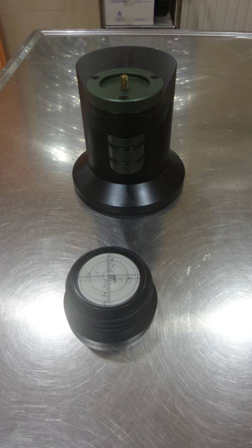

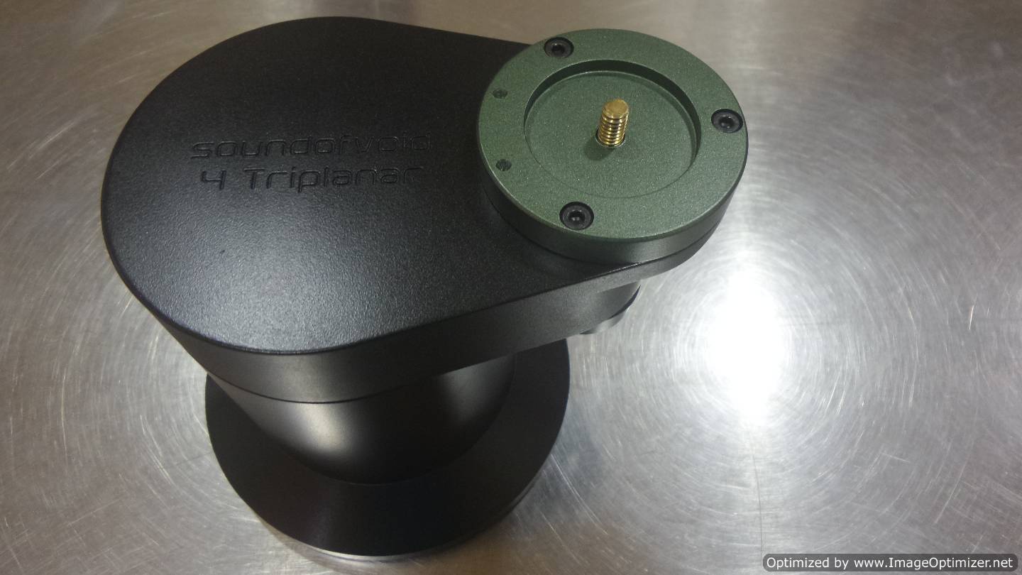

After that stage it was time for painting them...in the same BMW black and Nissan green.
Three coats of color and three coats of clear coat made the deal.

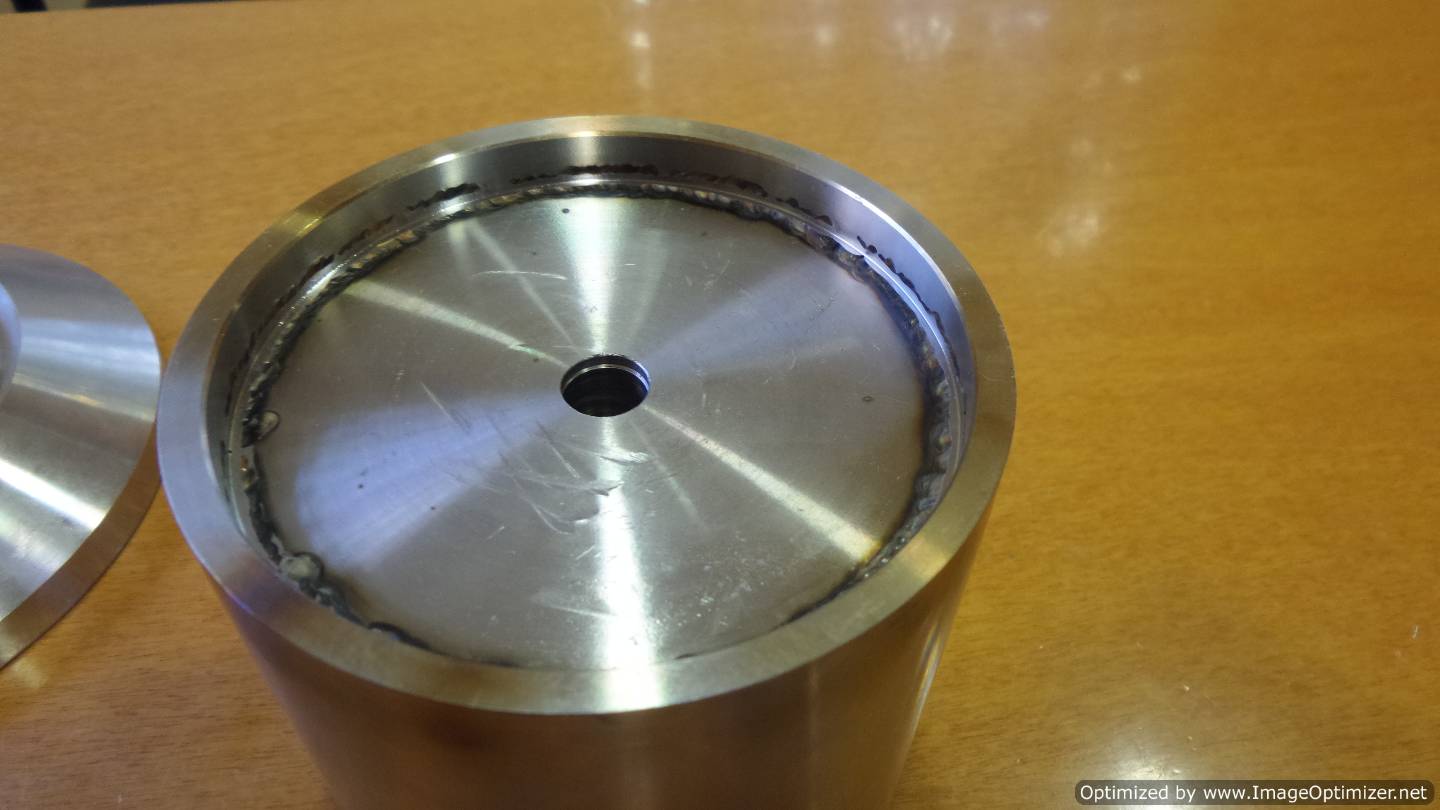

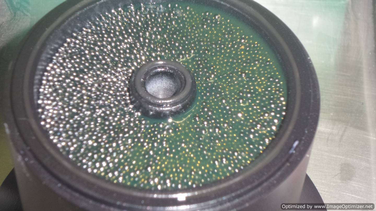

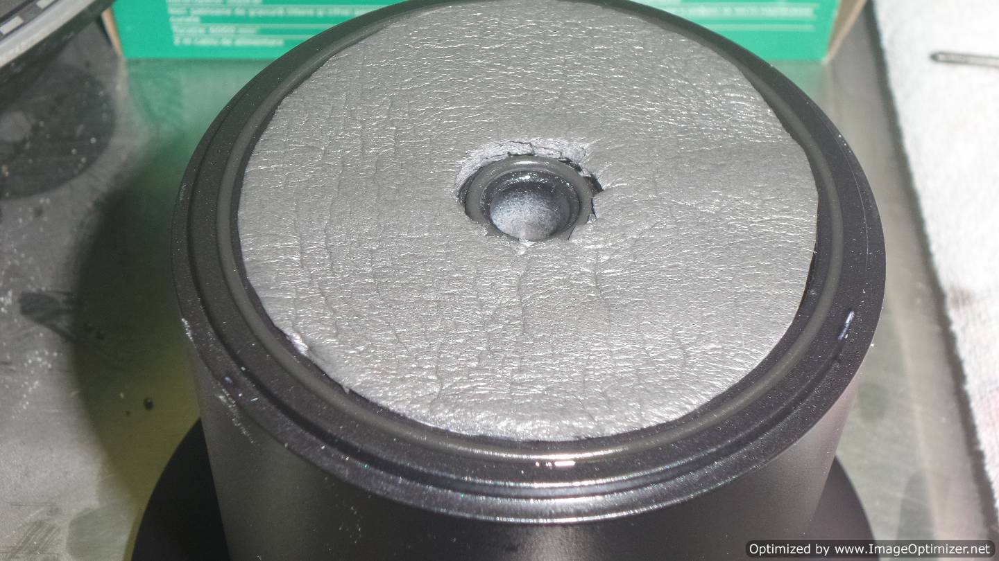

I have used the same technique for topping up the hollow body as in the previous tonearm tower:lead shot and gearbox oil.
Two layers of pliable material with lead sheet were used at the bottom and top of the main body for extra vibration absorption.
The o-rings made it a liquid tight seal and all looked fine.
Voila!
Voila!

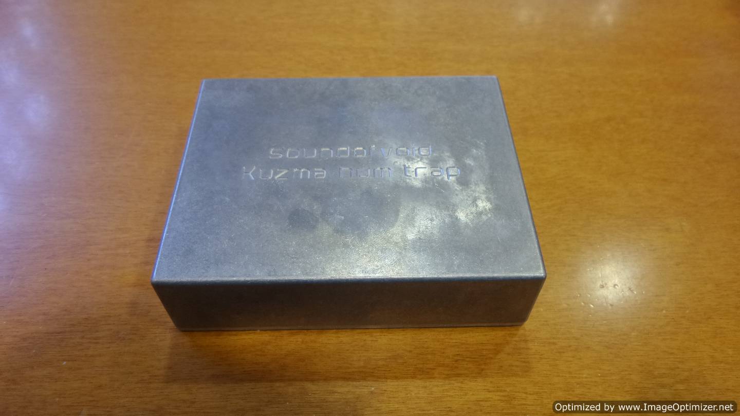

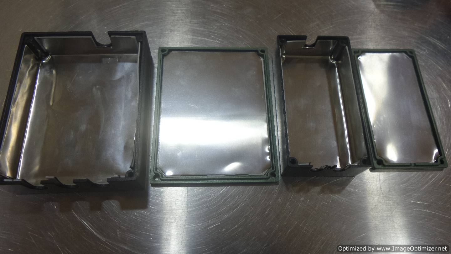

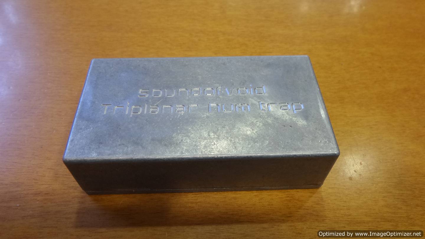

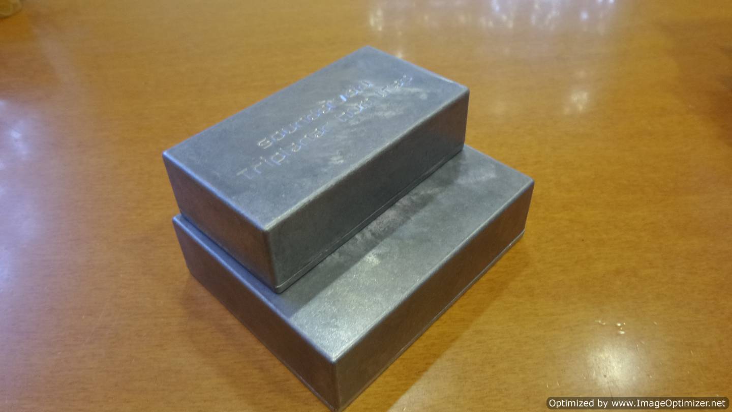

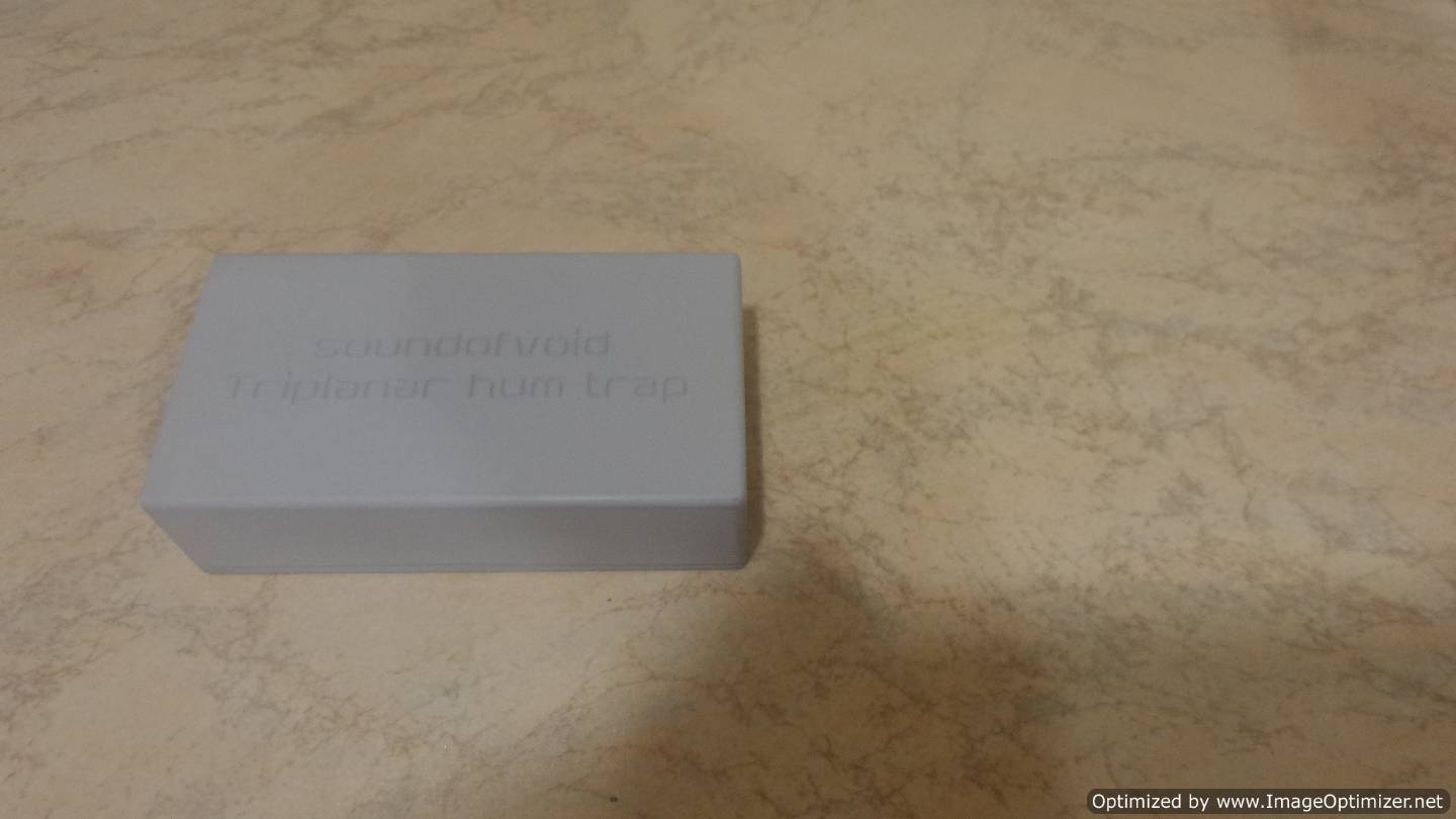

In our talks he mentioned a problem with hum picking up through the tonearm cables.
In the Triplanar arm more so than the Kuzma.
After trying to establish the weak points in the route of the phono cables, it was obvious that the junction boxes were the problem.
The Kuzma box was out of aluminum but had a substantial length of "naked" cable inside whether the Triplanar one was made from plastic!
I offered to make him "cover" boxes out of cast aluminum lined with Mu metal hoping that there will be an audible difference.
Here's what i finally made, finished in the same black and green colors...
