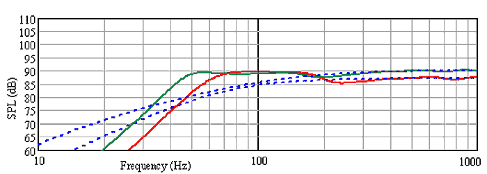

That's not too bad for a smaller room vs. the larger footprint of the supper although i like the driver height of the supper better.
I plan to drive them with my Fi 2A3 set amp and am wondering if it would be advantageous to drive the smaller A12 pensil's 50Hz F3 rather then the supper's 40Hz?
Efficiency above ~300 Hz should be unaffected by the box. My measures indicate 89 dB.
The MA drivers seem to be happy with less power than one would expect. I was quite shocked when Don (Doorman), with his 3.5W amp, swapped out his Fonken167 (92-93 dB) for CHR-Ken (10 dB less). I see A10.2 in his future.

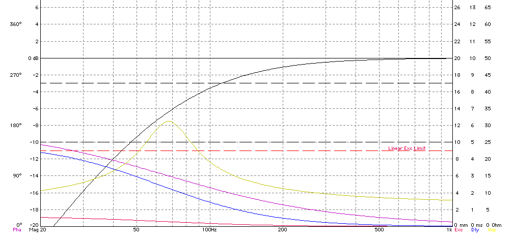

I've got 50hrs on my 12s in a simple BR. Sounds pretty good but vocals and mids a little thin. I used an EQ and bumping up 100 - 400hz area seemed to help quite a bit. Does this mean I'll need a bsc circuit after all, or is this likely to fill in w/ break-in?
24g solid can be VERY cheaply mined from CAT5/6 cable
How big is your BR?
I wouldn't be putting any EQ on the A12 until they have gone thru the mandatory breakin
http://www.diyaudio.com/forums/markaudio/154223-running-alpair-7-12-a.html
And you can't start making any real evaluations until probably thr 200-300 hr mark.
dave
How big is your BR?
dave
How big is your BR?
dave
BR is 19L (I know, not ideal - but it's what I have at the moment). Running sealed (plugged ports), crossed to sub. Ok, I'll reserve thoughts til they break in then.
