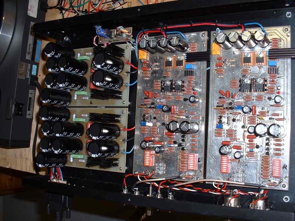

Hi. The PCB I use for the preamp and most of the power supllies are a design from an other forum member, Ed Robinson. I used its of pcb images and did some changes using a graphic editing program.
I design myself some PCB to interface its PCB into the Power Supply case and reproduce a real PassLabs Power Supply.
The Preamp is dual side with extensive ground plane and star ground. It is a very nice layout and give to the preamp a very low noise floor.
The Power Supplies PCB are in 2 main parts, Rectifier Unregulated and Regulated. They are single side, with large copper traces. Working on the preamp, I sometime did some short circuit between the ground plane and one of the supply line. It vaporized the copper! I can tell you that there is some serious supply power into this preamp...
If I would do it myself, I would combine all the Raw Supply PCB in just one PCB into the supply case. However, to put the noisier power transformer on a separate, isolated section is better.

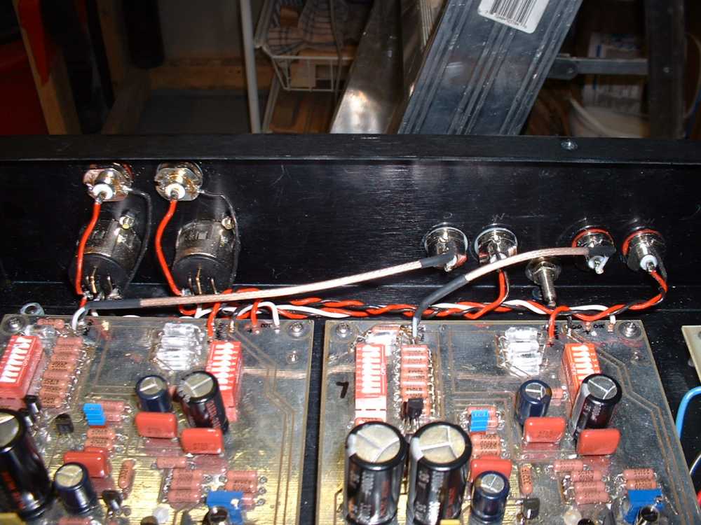

The rear connector view. The GND post is connected to the casing, then the case is connected to the power line connector using the DB25 cable shield.
I'm using coaxial cable for the MC input and twisted pair Kimber OFC copper wires for the MM and the audio outputs.

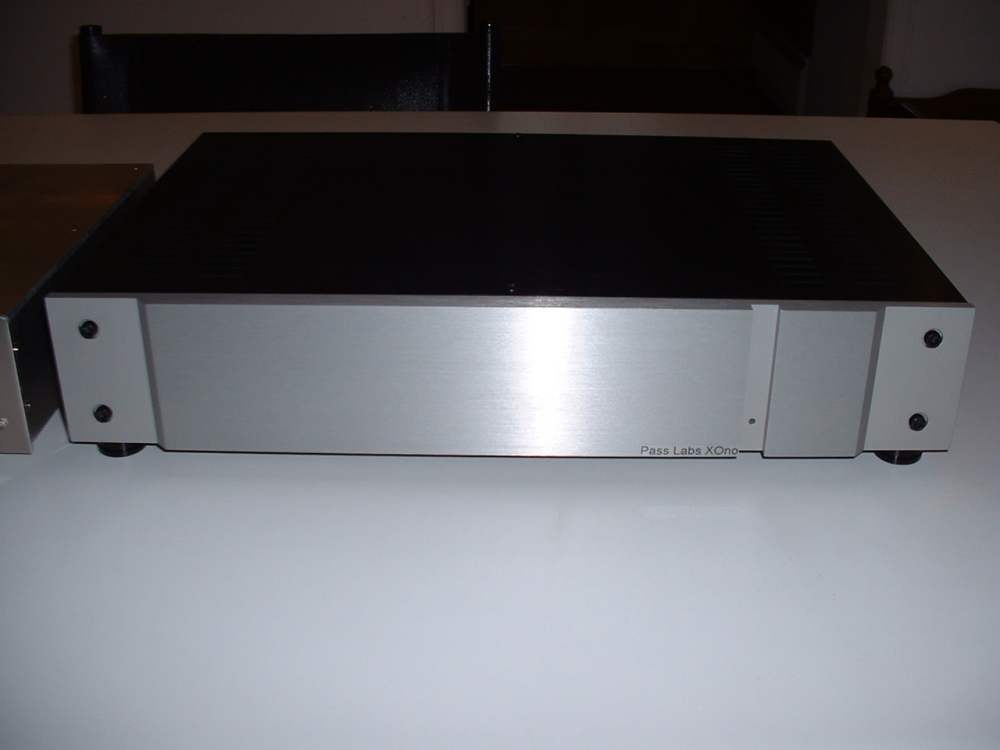

Looking very nice (also strangely familiar). I noticed you put heat sinks on the 9110s in
the inverting section. Was this out of caution or should I think of doing the same? I really
like the enclosure too. Do you think there might be more of these available? It's good to
see you finishing up and I hope you'll finally get to enjoy it.

Hi Ed. Nice to hear from you. Thanks again for sharing your nice design. And it has no faults, I must say . Worked like a charm the first time.
See my previous post on the 9110:
Some users suggested to change R57 from 221R to 499R to reduce the power dissipation of Q20-22 that are really too hot. It works well to keep the fets cooler, but by doing so, I was no longer able to adjust correctly the inverter DC offset to zero. Maybe it is because Q8 and Q19 are not matched at all. Anyway, I kept R57 to 221R and installed small heatsinks on Q20-22.

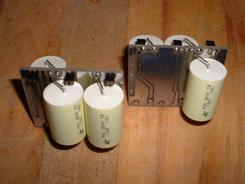

That may change, I built what I called an "ONO Caps PCB" to mount big MKP film caps on your PCB at the C7,C38 & C9 locations. It as jumpers to bypass the caps if I like. I may used coupling caps on the inverted output and use R57 set at 499R, so this way the ONO will run much cooler. Check the image. I will install them this weekend.
