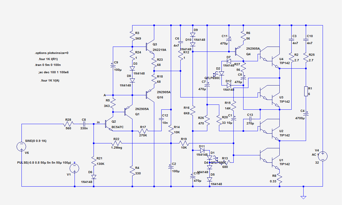

You are free to use darlingtons instead: the circuit will work almost identically, but with less headroom and a reduced linearity, but nothing really alarming.
And such a circuit will certainly be more placid.
Elvee, could you provide at least a sketch to show how manipulate NPN darlingtons on the original schematic?
It seems my to-do list will rise again by following your "little" designs. I like the way of your using big and small metal case transistors everywhere.. I like the oldskool fashion
Here is the adapted version, tested in sim only (but it should be more placid than the CFP).
As expected, it has less swing and linearity, but nothing catastrophic.
Thank you very much Elvee. I felt a bit ashamed by seeing redrawn of whole schematic. Your kindness as usual.
If different type of transistors were used (original or darlington), can you elaborate that which parts of the circuit going to be considered for fine tuning? I'm sorry but I can't read the circuits like many people here.

First, you could look at the differences between this schematic and the regular one, beyond the simple sex-change: there are many, some quite subtle.If different type of transistors were used (original or darlington), can you elaborate that which parts of the circuit going to be considered for fine tuning?
There is certainly still place for refinement on those departments.
Then you can test the effect of different values in the stabilization networks.
