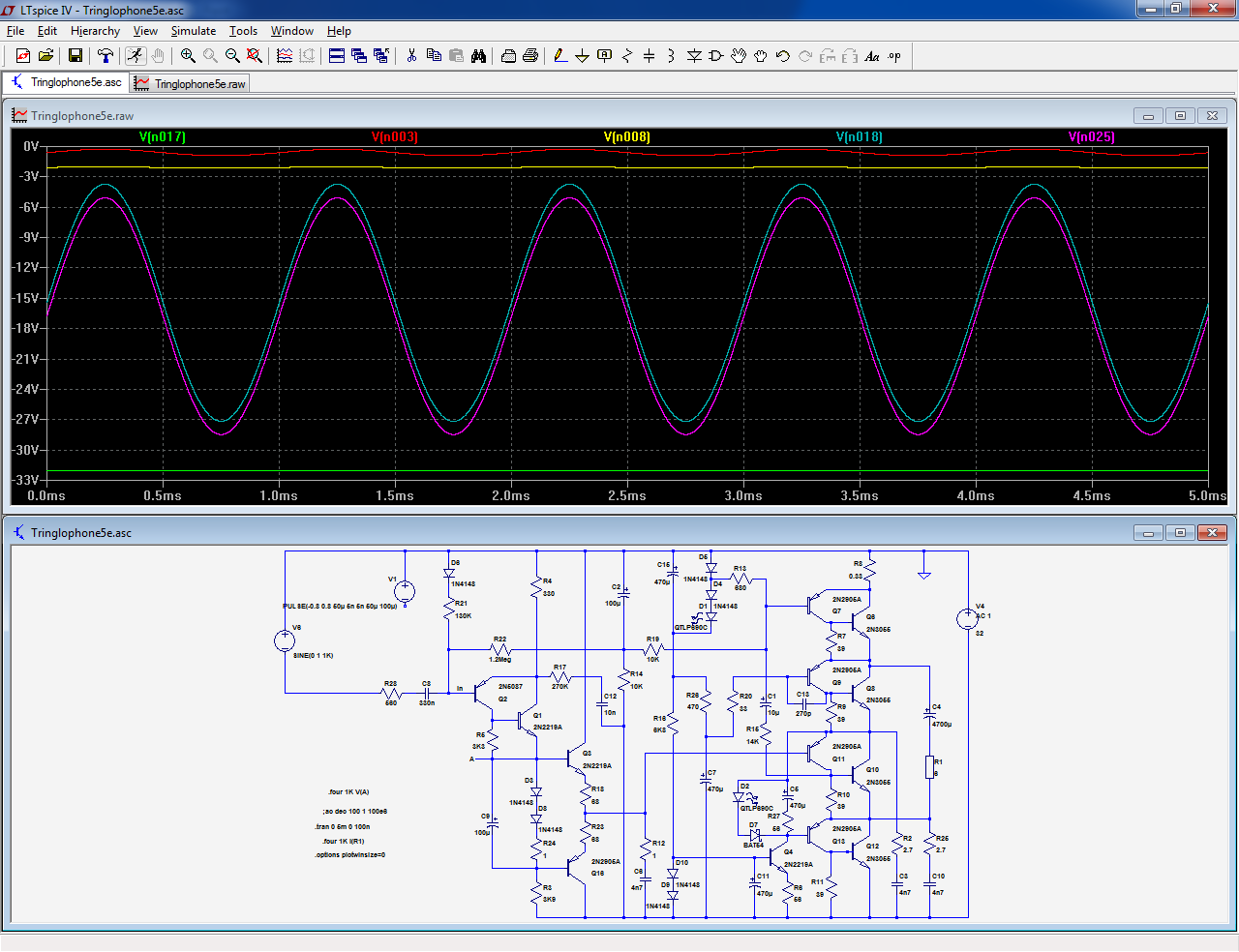

Let us have a closer look at the Tringlotron OP.
Compared to the basic topology described in the article, there are two main differences:
The operation is illustrated in the first pic below: the green trace is the 2Â output current, which is easily supplied using only 1.6A average quiescent current: red trace, Q6's collector current. When a current excursion is needed, the peak reaches 2.6Â.
As a side effect, this also means that Q8 has a lighter job to do: the yellow trace shows an excursion only half that of the green trace.
However, it is important to understand that Q8 is the sole output device: it is "helped" by the current modulation, but does not request nor need it: if the modulation is turned off, the operation of the circuit remains completely identical, except of course that clipping takes place if the peak output current exceeds 1.6A.
This means that the Tringlotron operation is not affected by the modulation, and the modulating path doesn't need to be clean or linear: the noble path is under the full control of the three transistors in the tringle.
The modulation simply improves the efficiency.
Even with this trick, the actual efficiency remains pretty low: in theory, it could reach 50% at full power, but in fact it is closer to 25% due to the various overheads and margins required for both voltage and current.

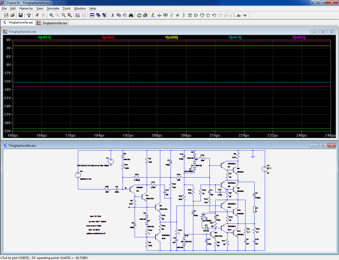

Each transistor needs a minimal Vce to operate properly, and there has to be some current margin to account for the real-life impedance of the speaker: unlike class B, class A requires to plan in advance the use of the current.
To ensure proper operation and minimize the losses, the voltages along the tringle have to be set very carefully, in order to make an optimal use of the supplies.
This is shown in the next two pics, first the quiescent levels for each collector and emitter, then the same with a near-maximum signal applied.
In the tringle, the "error" (non-linearity) caused by Q12/Q13 is corrected by an anti-error appearing at Q10/Q11.
No it is not a typo: it looks counter-intuitive, but that is the way the circuit works: upside down.
When Q11's base is pulled lower, its collector current decreases: the opposite of a regular follower; this creates a negative input resistance and explains the need for R12/C6.
This means that ideally, Q10/Q11 and Q12/Q13 should be matched. In fact, the behavior of the NPNs is almost completely hidden by the PNP inputs, and as a consequence only Q11 and Q13 need to be matched (for maximum linearity; it will work perfectly without matching)

PM-AB1 error correction amplifier
And, yes, thinking to that, it is "some kind of NFB in disguise", you're damn right.
To be honest the schematic you posted is pretty complicated (means not familiar to me) and i will need some time to analyze and understand-it.
May-i suggest-you to write a little 'theory of operation' ?
The operation of the circuit can be demonstrated by simply writing down the Kirchhoff's laws, but it probably does little for the actual understanding.May-i suggest-you to write a little 'theory of operation' ?
Let us try to do it in a pedagogic and intuitive way. There is no need to mess up with the complete schematic for the moment, the principles remain the same as for the simplified circuit:
Let us do it in two passes: first, the progression of the AC signal without consideration for the error signals, and then the analysis of the error voltages.
Starting from Vin, the signal is copied from Q1's B to E, is applied to Q2 through D1 and drives the top side of the load. Since Q3's B and E are at a zero potential in AC, the voltage is applied across the load and generates a current into Q3's E which is transferred to its collector and from there passes through Q1 to loop back at the top of the load: we have looped the loop encompassing Q1, the load and Q3.
Now, let us look at the error voltages generated along this path. The error voltages are caused by the BE non-linearity.
Two identical voltages are generated in Q1 and Q3 (neglecting the Hfe, the current is the same everywhere in the loop). The error voltage in Q3 is "normal", ie the product of the emitter current by the non-linear dynamic emitter resistance is subtracted from the voltage applied to the load.
The error voltage in Q1 is identical, but it is applied "upside down" to the top of the load: Q2's base is connected to the emitter of Q1.
This creates a subtraction of the error voltages as seen from the load.
There is still another possible error voltage in the loop, the BE of Q2. But since the AC current in Q2 is zero, so is its error voltage and the error cancellation between Q1 and Q3 is perfect. Neglecting higher order effects, like finite Hfe and Early effect, of course.
Compensations could be included for these effects, like in multi-transistor CCS's, but it is probably simpler to use devices like MOSFets having a negligible input current.
As a side effect, because the voltage appearing across the load is exactly Vin, independent of the output current, this implies that the output impedance is zero.

I have made some tests with a variety of devices, mainly faster ones.Here's some of the newer devices: NJL3281 MJL3281 FJL4315 NJL4281 MJL4281 At least it could demonstrate that output device speed in excess of the amp speed, is either turned into HF noise or "tamed" by going even slower than before. Isn't that about how it goes?
So, actually, I might be shopping for MJ15003? (doesn't need an amp rework) and trying for a ~17 watt amp phase linear up to 1Mhz? Or maybe more like 15W with the MJ21194 if phase linear to 3.5Mhz doesn't incur a lot of added transistors? Somewhere in that ballpark?
To my astonishment, it worked immediately, without even tweaking the degenerations and stabilization networks.
I guess I may have been somewhat heavy-handed in that department, as I wanted to remain on the safe side.
The devices tested were BD317, 2N5886, BDY58 and RCA 41013 and 64116 (I think it is broadly similar to the 2N6340).
Except for the 64116, I only replaced the two main transistors involved in the tringlo action, as I had only one sample pair of each type and the auxiliary transistors play a minor role.
I also noticed that on my prototype, the 47n C14 was left in place as in V5d.
This probably helps.
When the amp is pushed into clipping, a VHF oscillation is visible with the faster types, but nothing dangerous or alarming.
This means that the new Onsemi types should work transparently.
