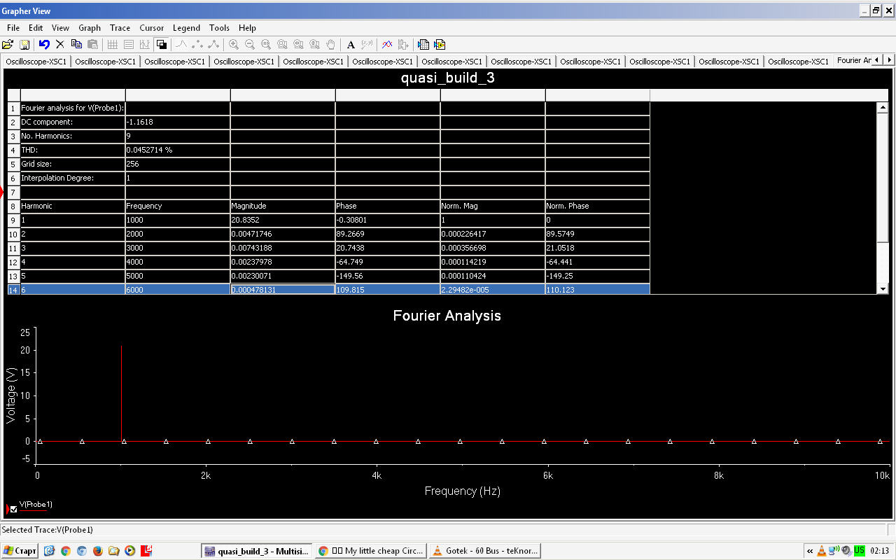

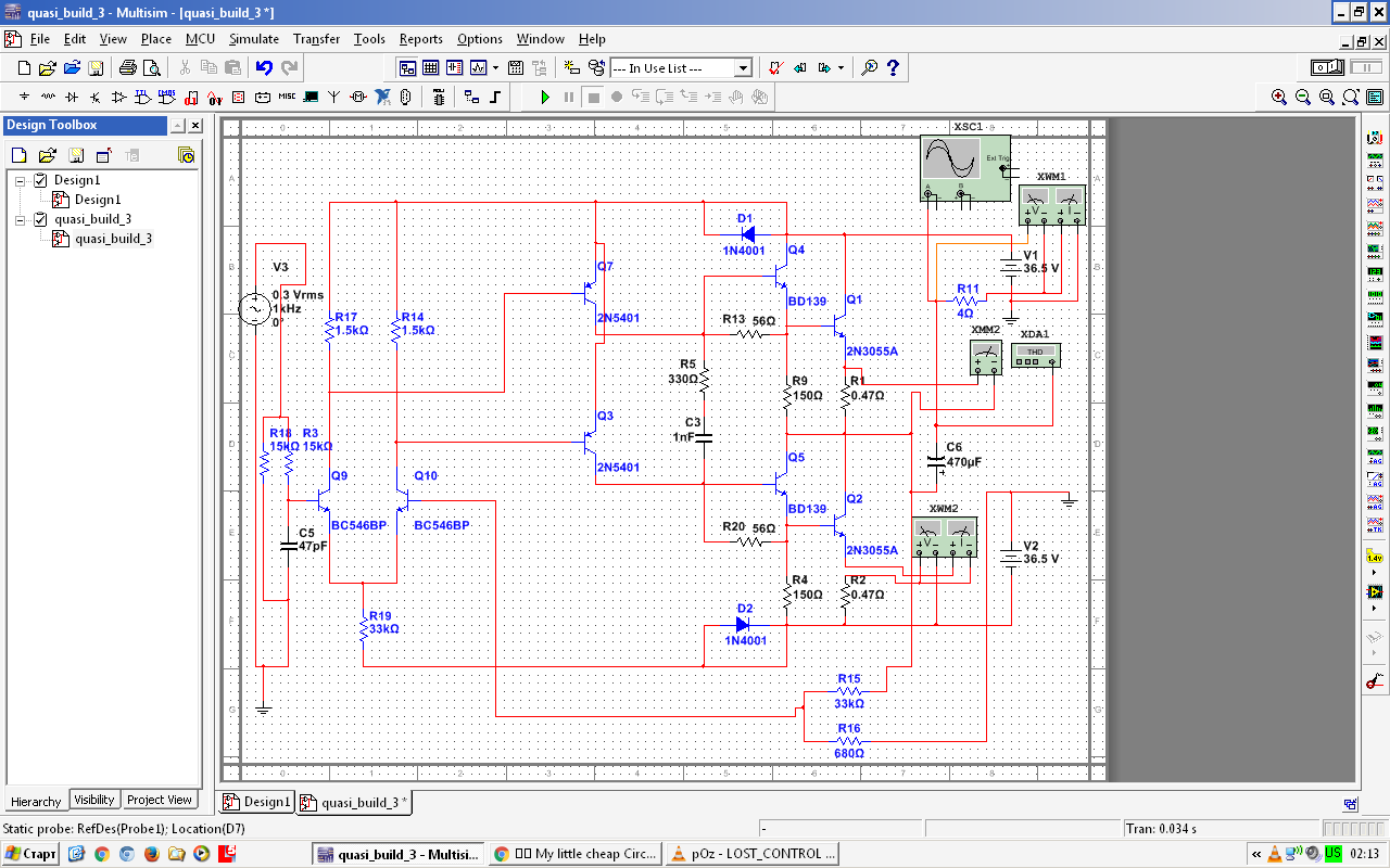

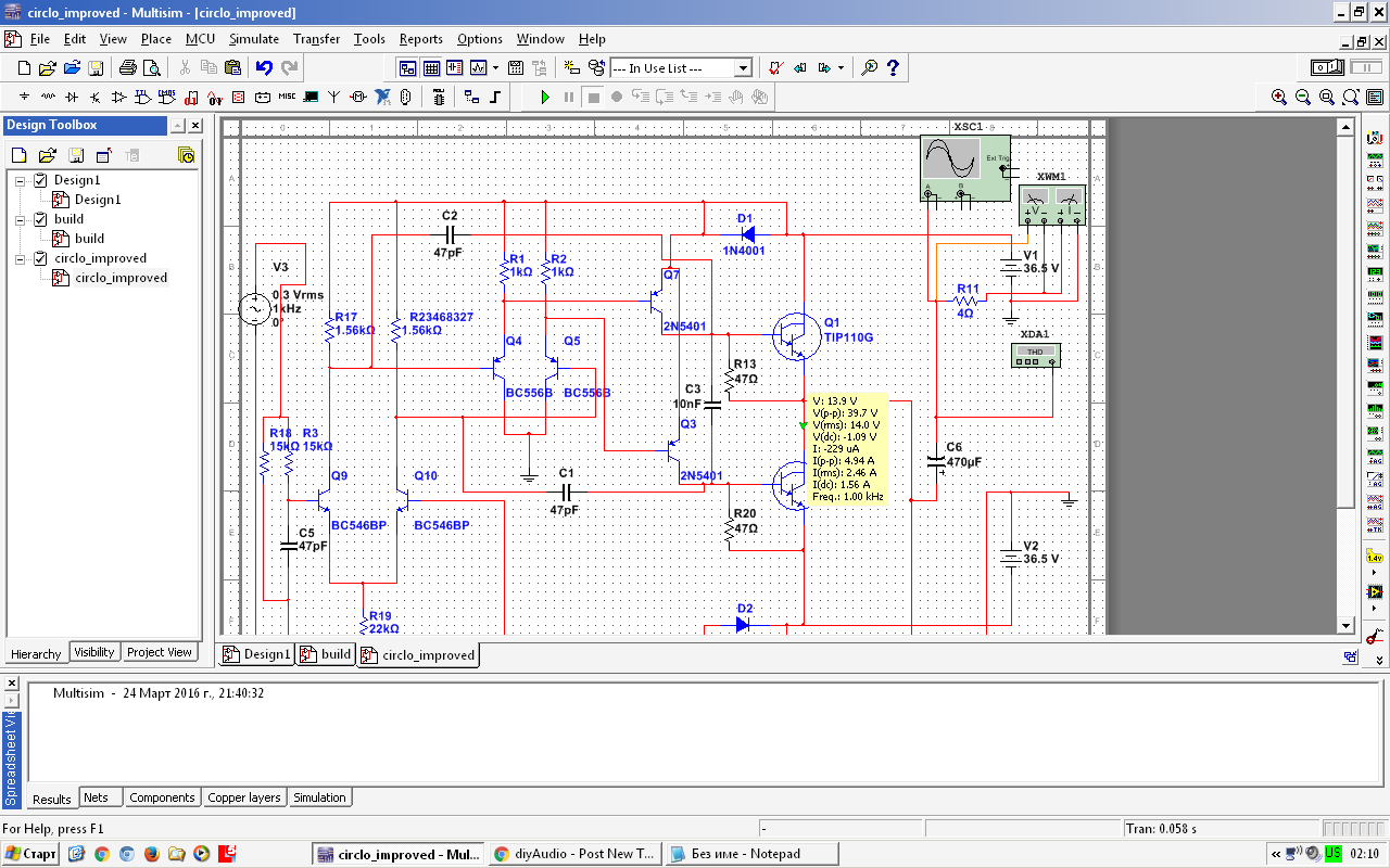

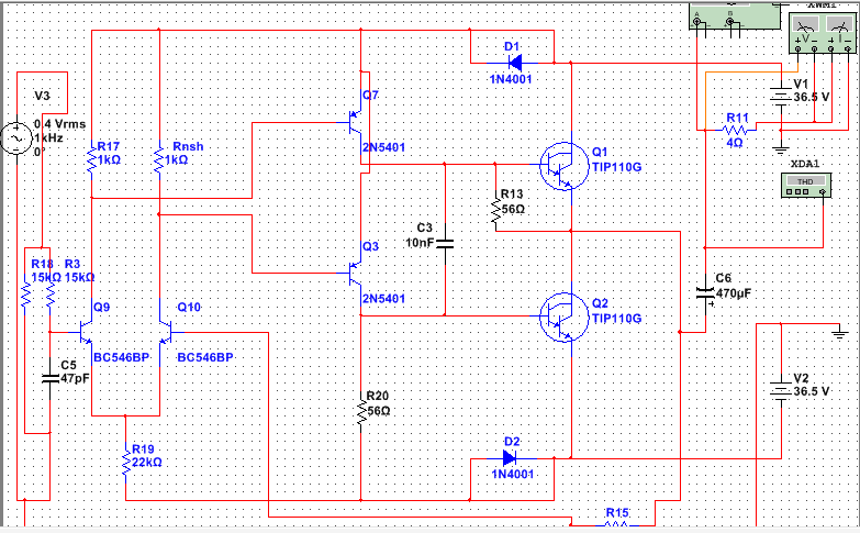

how about this reinvention of circlo <-- satellite, satellite
i want it simple as possible. <-- satellite, satellite
P.S. If I want to use two npn darlingtons as output devs, This allows me.
I dont need compensation here ? between Q3 and Q7 bases and collectors ?

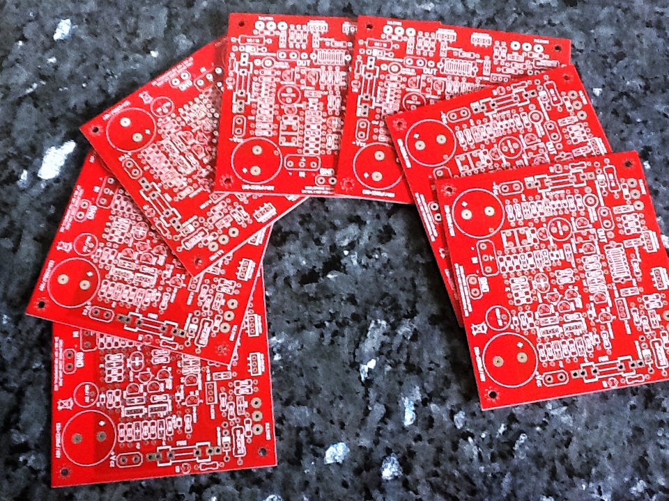

Update
to all members who subscribed to the Inverted J-FET Circlophone PCB orderlist: boards are expected to arrive within the next two days.
@Mosfet54 : please read post #1 of this thread, you're design has nothing to do with anything that comes close to Elvee's Circlophone.
I was mistaken, is this correct ?
The boards finally arrived and are all in mint condition.
To all subscribers of the Inverted J-FET Circlophone orderlist, please check your personal mailbox.
The first boards already went out!

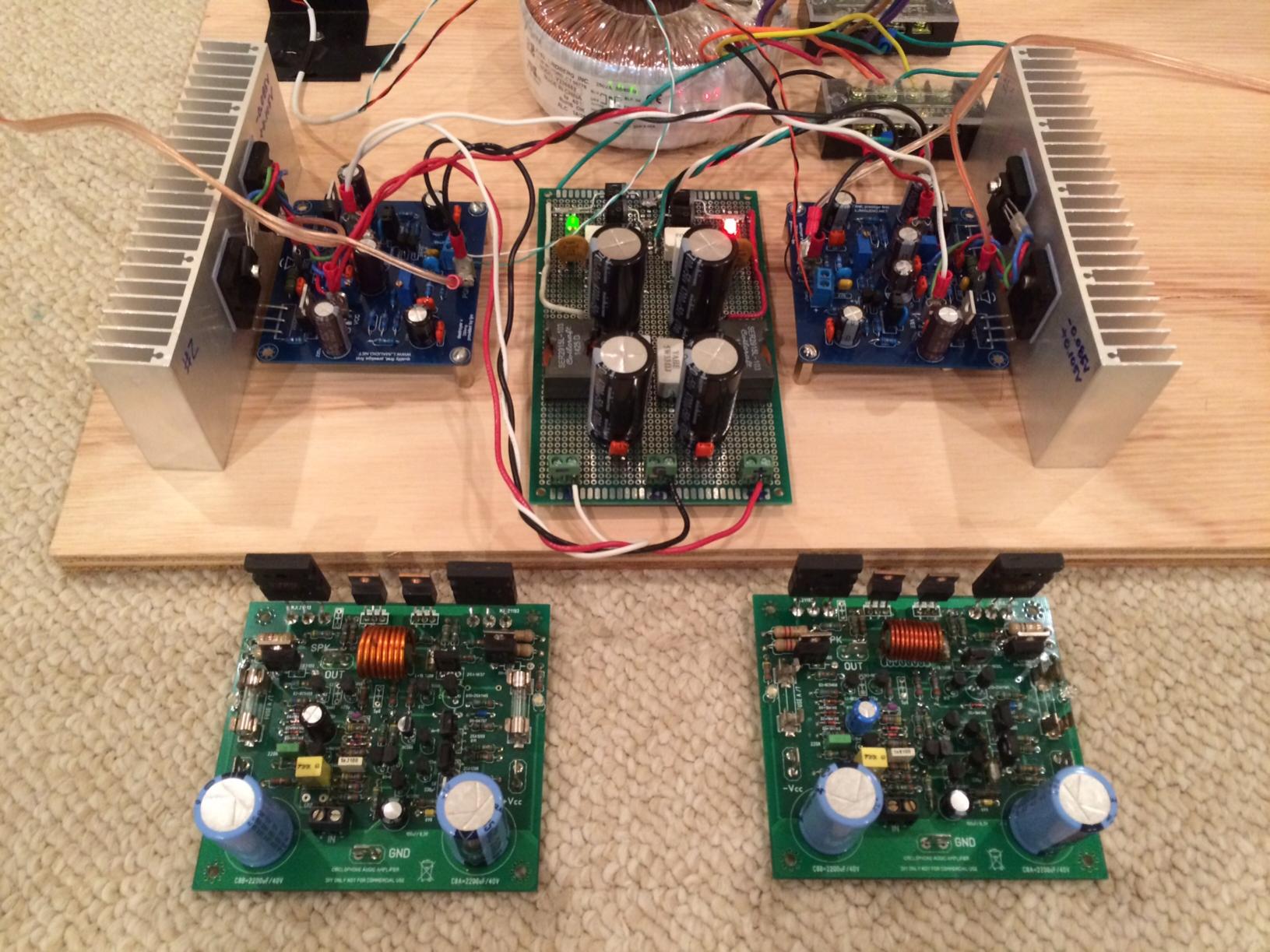

My inv jfet Circlophone arrived
My inverted jefet Circlophone amp just arrived - thanks Piersma.
I just finished the Dx PSU that makes a clean +/-37v with 6mV ripple. I still need to mount the Circlophone amp to a heatsink and can test it out with this power supply tomorrow.
Is it possible to do with darlingtons for output transistors ?,
I have many and only npns.
Hi mosfet54,
Darlington and Hexfet versions use same layout but with slightly different component values. I tested both and they sounded very well despite darlington version had an overshoot issue that seems requiring extra compensation work. Hexfet version doesn't have such behavior with values suggested by Elvee in post #16.
My pcb layout try-out is here:
http://www.diyaudio.com/forums/soli...n-parts-accessories-beginner-friendly-23.html

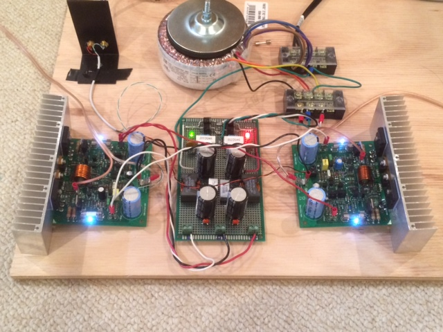

Inverted JFET Circlophone testing
The inverted JFET Circlophone works! On one of the amps, I had a problem with a micro-perforated insulator (Kapton tape punctured by a micro burr on the heatsink), after fixing that and replacing a fuse, it is now playing music. It sounds fantastic! Like a class A amp but with lots of power on tap. Very powerful dynamic sound with great bass authority.

What's the DC voltage feeding the CP boards and total capacitance fron PSU?
Thank you.
That's a 250VA 25v rated Avel Lindbergh toroid which produces +/-37v using the Dx PSU with qnty 4 x 4700uF 50v Nichicon caps.
Here is closeup of PSU - it's very simple and works quite well.
