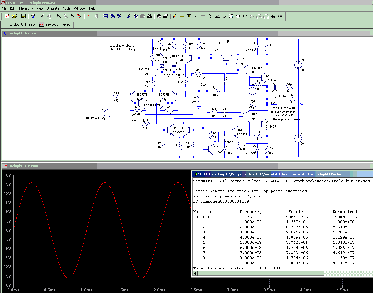

I have tested the idea of darlington and CFP inputs.
Darlington doesn't look promising: there is a notable degradation, whatever the configuration.
CFP is much more attractive, but is also more demanding on compensation.
The amp was stable with a simple plug-in replacement, but it was marginal, and I doubt the physical circuit could be made to actually work.
I redesigned the compensations, at least the differential ones: as I took care not to interfere with the bias loop, it should remain more or less OK.
With the redesign, the stability margin is huge, even better than the original Circlophone, and now exceeds 110°.
The improved loop gain has had a very favorable impact on the linearity, and the THD is now under 10ppm, with a remarkable profile, almost pure 2nd and 3rd, and negligible higher order.
The bias current is now well under 100nA, meaning source resistances of up to 100K are no problem.
The increased loop gain also means very high closed loop gains are achievable without loss of quality.
It just needs to be physically tested to confirm the good auspices.....

Though I mentiond that it would increase open loop gain,
you had already declared that removing R1 was unstable.
All it would have taken to be CFP...
Input was already in CFP with Q5 Q6. You have now insert
new transistors that also Darlington with Q5 Q6. Drawing
them over by the input pair doesn't change this ambiguity.
CFDCFCFP with a sideways loop back to the beginning....
Add more stages toward infinite open loop gain, soon you
will have another fine oscillator to beat in stereo with mine.
I'm not saying it might not work, only that after you comp
the hell out of it, will it have improved anything?
Not not really. It is actually a CFP in the input, not a darlington with Q5 Q6: this is because the collectors of Q7 and Q8 are tied to the LTP, not the collectors of Q5 Q6
Removing R1 has no benefit for the differential gain, but it increases hugely the common mode gain, which is problematic
ok, how about input stage linearity, do you really need very high open loop gain?
This variant has been studied to meet the requests of Daniel: high output power on 8 ohm (~150W), with a high input sensitivity. This requires a closed loop gain of more than 200x. Without a sufficiently high open-loop gain, performances will be seriously degraded.
Now one could question the philosophy of it all.
What we see is that an increase in the input gain provides an equivalent improvement in linearity.
This seems logical, but in fact it simply means that the gain supplement provided by the CFP is clean enough to be used "raw", for example to reduce the errors of other parts of the amplifier (here, the output stage with its clumsy 2N3055's).
So, why would you want to linearize something that is already better than the context it is going to be used in?
I think that's simply sensible resource management. Now, you have the right not to like high open loop gains for ideological or other reasons, but that's completely different.

I think you are too smart at analyzing the circuit: you "know" how it works, and you use that knowledge to draw conclusions, but that prior knowledge is preconception.
You have to play the game fairly, work the way a simulator does.
The dynamic inter-emitter resistance remains the same, with or without R1. Since the operating current in Q5 and Q6 is 13mA, that resistance is ~=2*26*13^(-0.9)~=5ohm
That resistance sets the transconductance of the stage in differential mode.
The common mode transconductance with R1 is a bit smaller than 1/R1 when present, and 1/1.25 when it is absent.
That's a big difference, and that's the only thing that matters for the circuit.
The common mode exists regardless of the circuits operating conditions, and it has to be made stable, and preferably independent of the differential loop.
Without R1, the mode mixing is maximal.

The initial purpose of the CFP was to decrease the bias current, increased loop gain is just a bonus. It could be thrown away with some degen, but why not use it constructively.

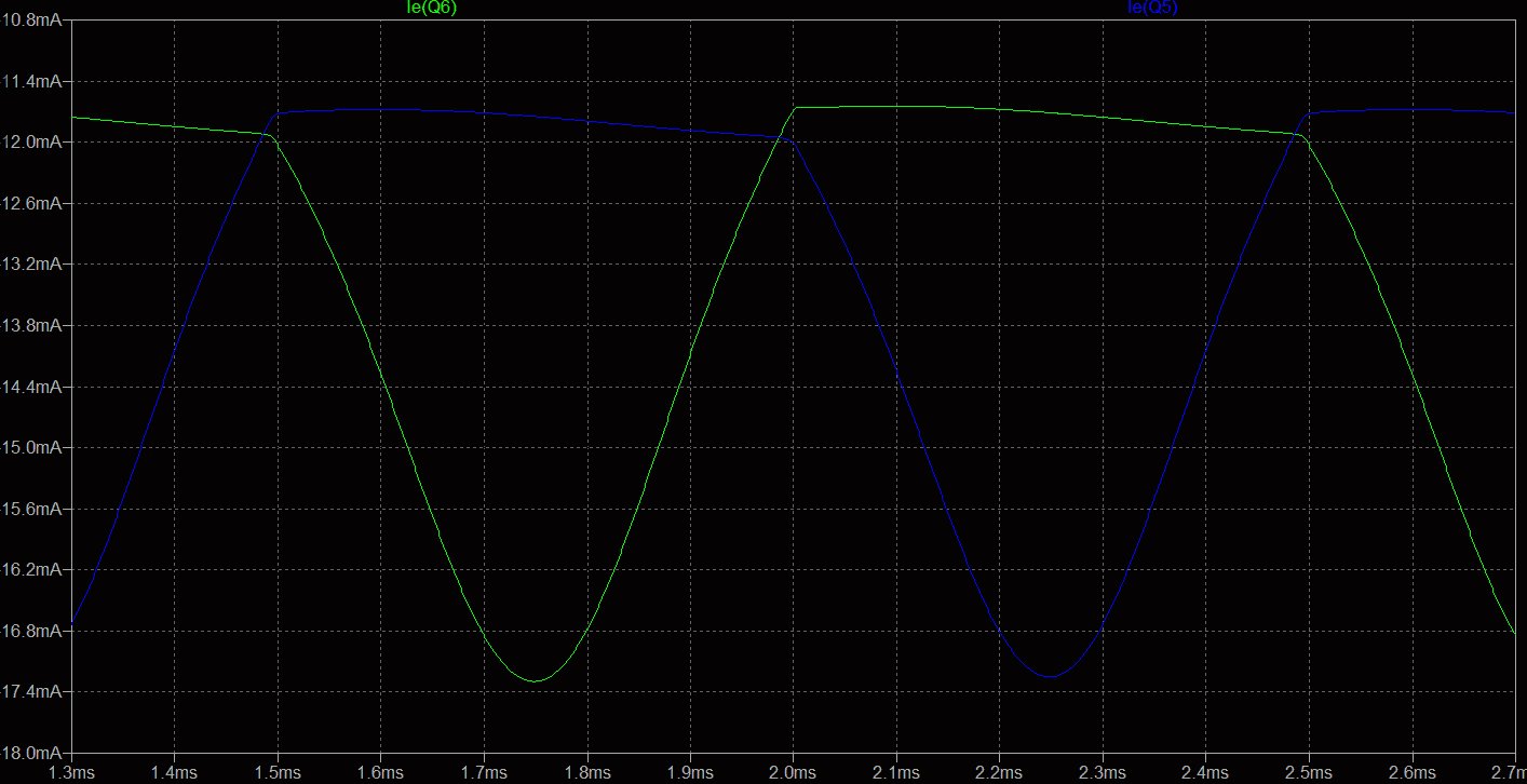

Together with common mode feedback, one emitter must be at constant current.
Simulation confirms this. Effective emitter resistance is, pluggin' numbers from
the graph into my calc. Taking out the tilt and going by the hump in the middle.
oh about 1.1K??? R1 clearly becomes significant to the differential by way of the
other emitter. The other one, not jammed to constant current by a logic threshold,
maybe a few ohms per your numbers.
