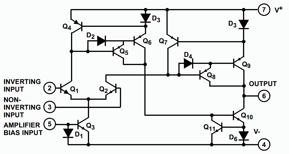

http://www.ti.com/lit/an/sloa054d/sloa054d.pdf
Fully differential paper seems somewhat relevant, maybe useful?
Though we have both explored fully differential current outputs
rather than voltage... Does that make what we have done to be
discrete operational transconductance amplifiers instead?

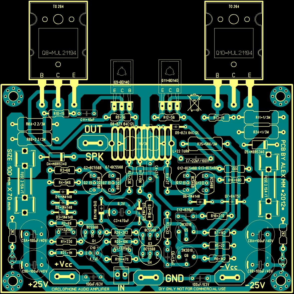

..... PCB was layout in few hours ,just to improuve, my skill and have, a new PCB in my collection
Regards Alex.
Hi Alex,
Nice to see another one of your very nice PCB´s ;-)
Karsten
Yes, very nice work indeed. Even if I spent more than a few days on it, I couldn't match that...... PCB was layout in few hours ,just to improuve, my skill and have, a new PCB in my collection
Regards Alex.
That's exactly what a forum is about: everyone contributes to the best of his abilities, and the final result is awesome.
Differential topologies do have clear advantages: cancellation of some types of nasties, etc.http://www.ti.com/lit/an/sloa054d/sloa054d.pdf

Transconductance amplifiers do not normally belong to the category of "quadrature" amplifiers: they are regular class B amps, but with a current output instead of voltage.
Yeah, but put your style of sensing between an OTA and rails,
and feed back to Iabc. I think you might have a circlophone?
An actual circlophone, though with chip limited dissipation.
Maybe enough for a headphone or something?
My point was really that FDA's and OTAs have a common mode
input that could be abused for some quadrature fun and games.
FDAs output voltages, and center upon a common mode voltage.
OTAs output a current, and center upon a common mode current.
Same exact things, except completely different.
It would be helpful if an OTA fully brought out the two currents
as differential drives, rather than collide them inside the chip.
Maybe some existing OTA already has a differential current
output configuration suitable to drive something external?
If such a chip exists, I am unaware of it, but searching...
Maybe this is doable with a conventional OTA as a CFP?
By abusing the currents to either rail as-if they were drives...
You are using class B, current sensing, and the threshold of
a logic based rule to nudge the bias up to ideal AB + CCS.
I am using enriched class A, current sensing, and threshold
of a curved sum rule to nudge the bias down to AB + CCS
(very non-ideal AB+CCS rule, but also very low part count).
Once you breach the OTA chip no-no, might as well bust
out with LM3Whatever output devices. I know you gone
there before too, so no playing innocent...
Excellent looking 30 watt amp...... PCB was layout in few hours ,just to improve, my skill and have, a new PCB in my collection
Regards Alex.
Here's a few notes for wider range:
D4/D5 MBR745, a TO220 size part (a "solar" shottky de-rated barely)
D8,D9 11N4744 (some 1w zener de-rated slightly) (~32+32vdc rails)
D7 one of these: BAT83, BAT86, BAT82 (make the label say "BAT8X")
Q12,Q13 one of these: 2SC1845, 2SC2240, 2N5551 (voltage tolerance up)
Q9/Q11 2SB649 (better than fake BD140 and easier to find than real NOS 8w Philips BD140)
D1,D2,D3,D6,D10,D11 = 1n914 (higher availability than 1n1418)
Possibly R17=12k (gain up in proportion to potential up)
C12=330pF (average value of real usage examples)
R21=47k (~32+32vdc rails)
other notes:
The current seen by R8, R11, R24 is low because of the paralleled heavy duty schottky diode.
Consider relocating fuses to mains side of transformer so as to avoid catastrophic offset fire hazard.
You can mark D7 as "BAT8X" because of the difficult availability of BAT type diodes.
If ~32+32vdc rails, D8,D9=1N4744 and R21=47k (50 watt to 8R, 100w to 4R)
If ~37+37vdc rails, D8,D9=1n4746 and R21=56k (70 watt to 8R, 140w to 4R)
So, instead of a 30w amp, there's a 70w amp.
