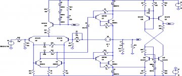

Is this about right?
So far:
2SA1209 or 2SA968 or 8w BD140
2SD1047C for output (330pF for C12)
BF819 or 2n3019
2sa970 goes where?

For an example of the considerations. . .
TO126
-BD140 from Telefunken (at least, that's the way they are marked: TFK, black epoxy, + stripe of green paint on the top edge): OK, no problem whatsoever, even with relatively slow VAS.
-MJE350 (Motorola): OK with normal VAS (like 2N3019, 2N1893, BF819, ..).
Not stable with slow VAS (requires additional compensation):
-BD238: idem
TO220
-BD242C: idem
-2SA968 OK under all conditions
-2SA1011: marginally unstable
-2SA1306: marginally unstable
The case of the 2SA1011 & 1306 is curious: they are quite similar to the 2SA968, yet they show signs of instabilities.
The instability manifests itself only when the transistors are completely cold, on negative output excursions on a low load (high negative output current).
It is merely a thickening of the trace, barely visible: 100 or 200mV at several MHz, and totally unresponsive to the usual cures, base stoppers etc.
Probably something to do with the layout.

The composite OP transistors are equivalent to PNP's, thus the lower half of the PP is immune, that's not in doubt.
But the top half is being current-driven by Q5, and except for the Early effect and the minor compensation network, it is also insensitive to voltage variations on its emitter.
It would be possible to achieve complete freedom by using an NPN for the top transistor, but then it would become a more conventional symetrical amplifier, and the quadrature control would have to be implemented differently.
It could certainly be worth investigating.

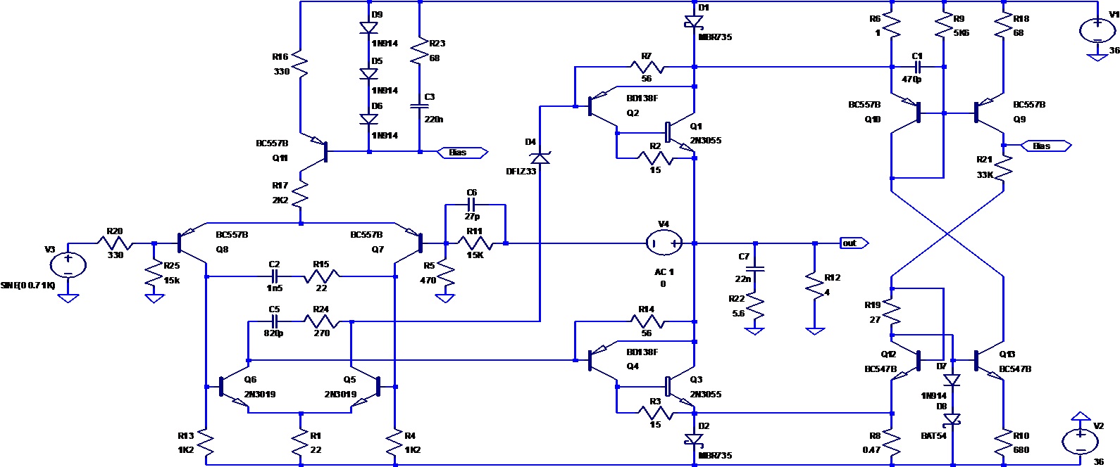

Q9 in your schematic of Post#1. Imagine it's emitter at plus 25V rail.
Now both your sense diodes are entirely hidden from the noble loop.
I suppose it was already hid by collector of Q5, but now doubly so.
More to the point, now exactly just like the other half, though the
difference for you (your hiding was better than mine to begin with)
may be more subtle.

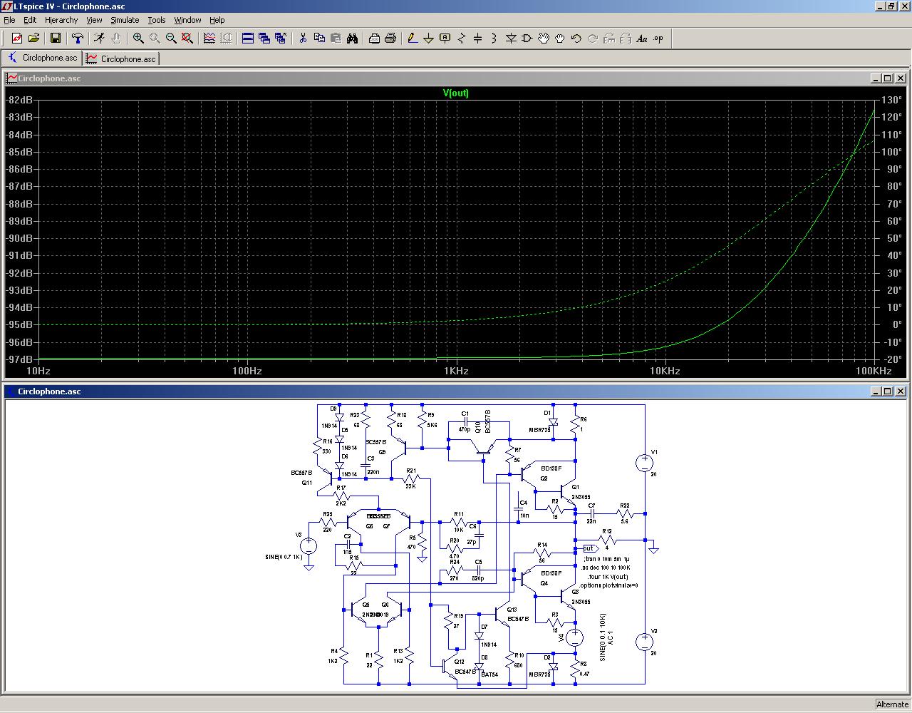

For the moment, I have some difficulty figuring out exactly what would happen.SRJLH...
may be more subtle.
If it were class B, that would be a disaster, but in class A, with the contribution of the lower transistor, it is much less straightforward.
The bottom line is: no change in the control loop has to require a corrective action from the noble loop.

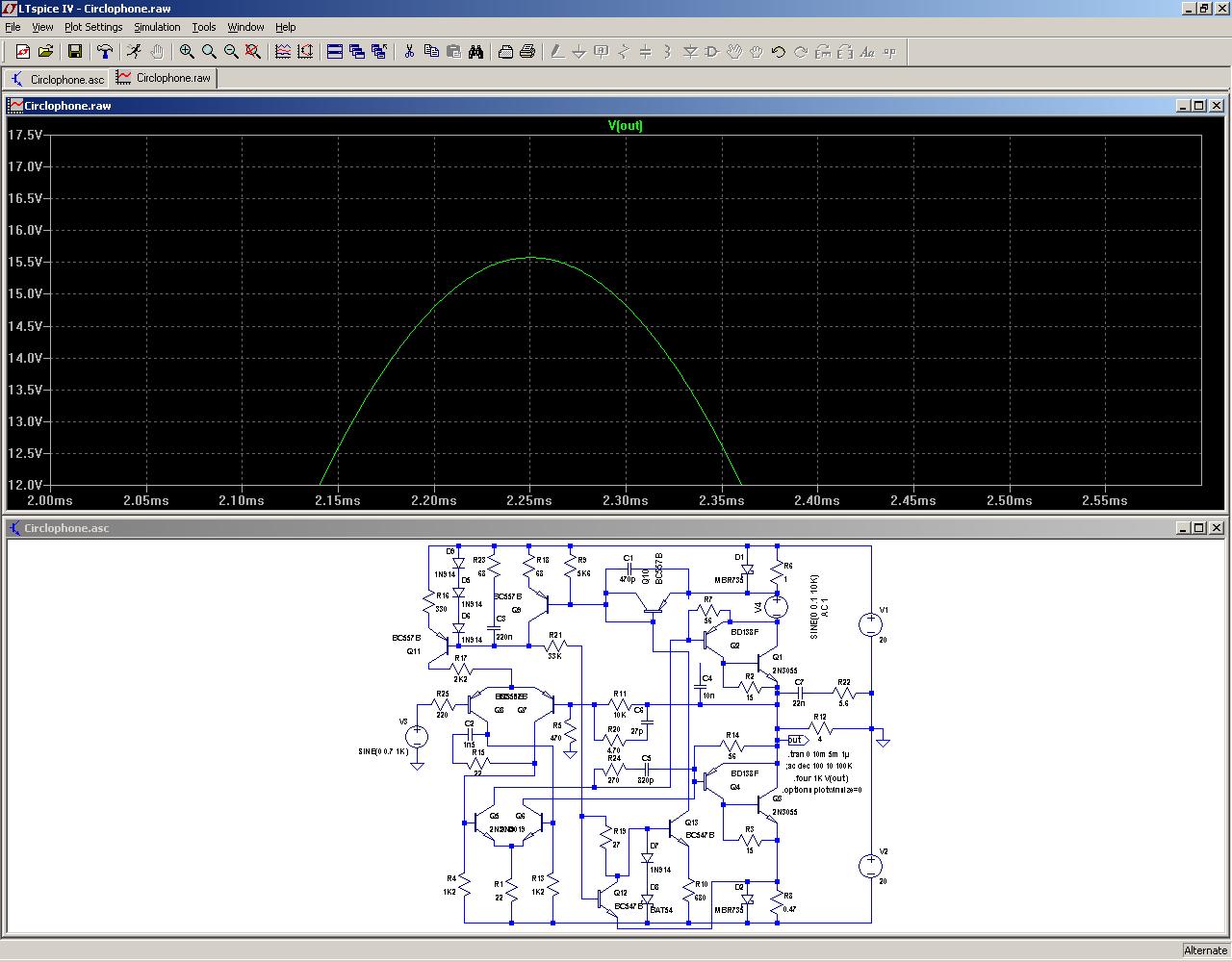

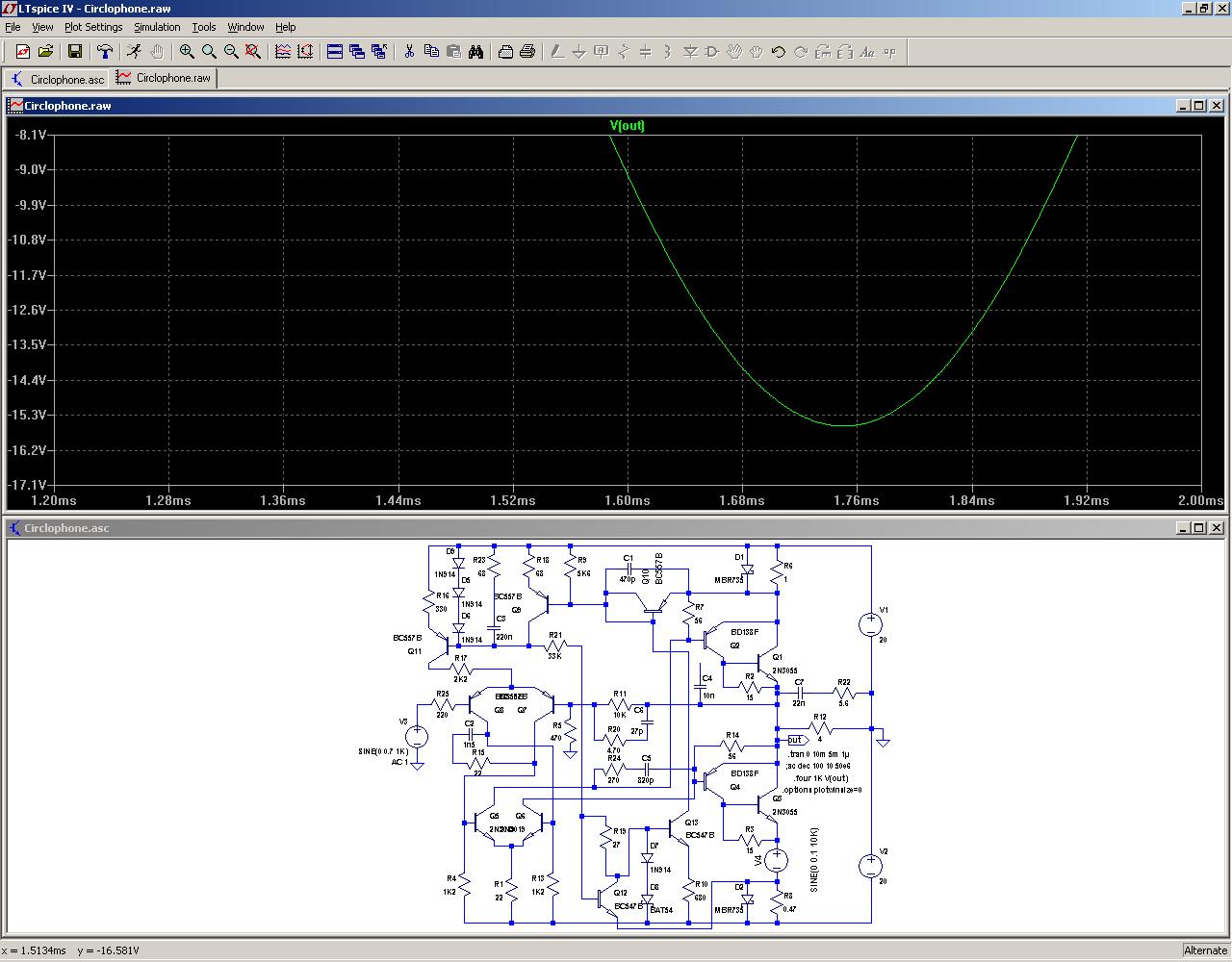

One way of investigating it without too much headache is to use the simulator's capabilities (yes, I'm getting lazy).
If a parasitic voltage in the control loop doesn't leak into the main loop, things are OK.
If not, it's always time to be wise "a posteriori" and rationalize (and get a well deserved headache).

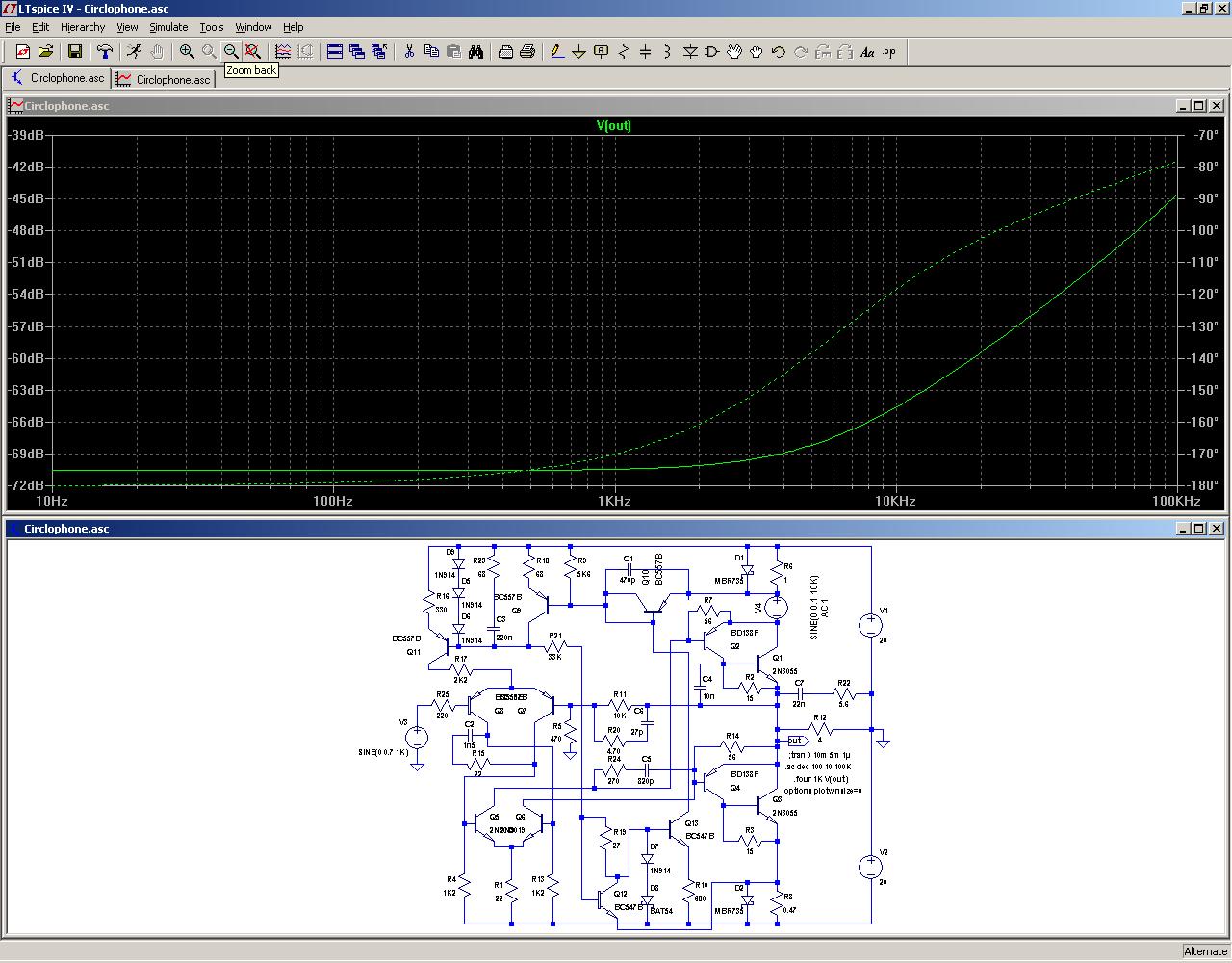

Here is what it gives in the case of the Circlophone: a small amplitude perturbating voltage is injected along with the regular audio signal.
The frequency is 10KHz to differentiate it from the noble signal, and the amplitude is 200mV peak to peak.
The behavior is also looked at with a Bode analysis.
One rail (the "clean one") for reference, then the other.
The upper rail is clearly "less clean": it is first order against second order of rejection, but it remains at ~60 dB for the audio band. Perfectible, but certainly not bad.
In the case of the Circlophone, the schottky diode's only role is energetic: they keep the ohmic losses at a minimum, while allowing the sense circuitry to operate at low currents without accuracy or matching issues.
I encourage you to discuss this kind of test on your SRJLH thread, since the Circlophone one is already overloaded with distractions of all sorts.
I accept your sim as reasonable proof. Nothing wrong to be fixed here...
Nonetheless, moving the emitter of Q2 to the upper rail in your most
recent simulation, does it make even a tiny improvement in rejection?

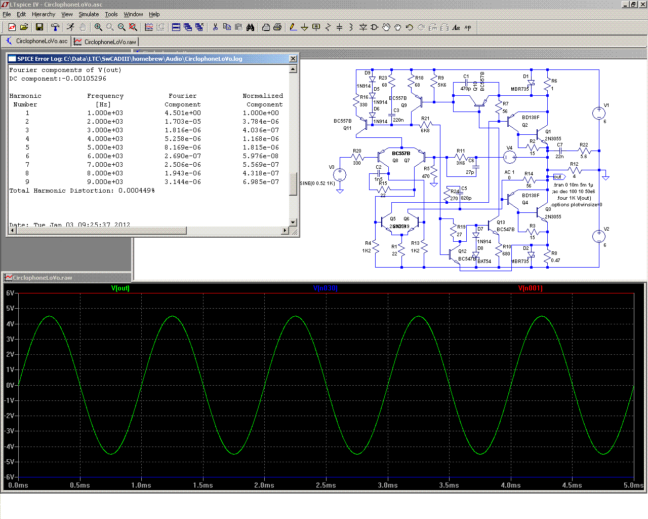

Elvee, I'm curious, does the Circlophone run out of useful headroom if the supply rails are halved - such as using a single rail +25V and 0V ?
(p.s. I recognize that an output cap would be needed)
No, not really: here is how it behaves with a total supply of 12V. It is in +/-6V, I didn't bother to make the conversion to a single supply, but it would be a mere formality.
You can see that it not only functions, but it retains all of its performances and doesn't run out of headroom.
Of course, it's only a sim, but I am pretty confident it would work identically in reality: I made tests a low voltages (not that low though), and it worked perfectly.
The only adaptations that were made were the value of R21, to keep the ~1.5mA bias, and the removal of the zeners and R26.

In a classic complementary PP, this condition is easily satisfied by placing them in series with the collectors of the OP devices. - You have to inject the common-mode correction signal (the "vertical" signal) at a place where it doesn't interfere at all with the noble, differential signal (the "horizontal" signal) = perfect quadrature.
That is much trickier when you use a vertical symetry, as opposed to a lateral one, as in the Circlophone (same sex transistors).
It also has a side benefit: it can very easily encompass the totality of the amplifier, from the input LTP: this means that the output drive is not limited by the class A conditions of the small signal stages: normally, both LTP's operate in pure class A at a fixed level, but should the OP stage be starved because of a very difficult load for example, the servo will raise the operating points to whatever level is needed to remain in non-switching class B.
This is the key to the Circlophone's remarkable healthiness.
Note that the vertical loop could be more limited: stephTSF has suggested that only the phase splitter and OP stage should be included in the loop.
That is a viable option, and it has the advantage of eliminating the parasitic input current modulation, but it is less powerful than the solution I finally adopted for the Circlophone.
It would be difficult to attain such a level of flexibilty with a more conventional, vertical symetry amplifier without adding complexity.
The simple things baffle me most.
Why R8 is half the value of R6?
I'm sure those values are right,
just can't form a clear idea why...
The value of R8 is not the result of some erudite calculations, it is rather empirical.
The heart of the servo is the summation process occuring at the base of Q9 (in Bigun schematic).
The current information from the positive and negative sides of the PP are ANDed there in an analogue fashion.
Ideally, one would need two transistors connected like Q10, and the sensing resistors could be equal.
There is just one problem: R8 sits at the negative rail. Thus, one would need to transfer the information to the positive rail, without error or offset or temperature sensitivity.
This is quite possible of course, using a properly scaled current mirror + resistor + buffer.
As I wanted to keep things as simple as possible, I decided to cut some corners, and instead of making a true linear translation, plus proper ANDing, I directly added the current of Q13 to the base of Q9, and I tuned the values of R8, R9 and R10 to achieve a near perfect fit in slope and offset, so that there is a smooth and seamless transition between the two halves of the PP.
That's the result of trials and errors, and the values are not cast in bronze: it is probably possible to find even better tradeoffs.
One could also implement the whole thing properly, without shortcuts, but it doesn't seem necessary: it works well enough like that.
