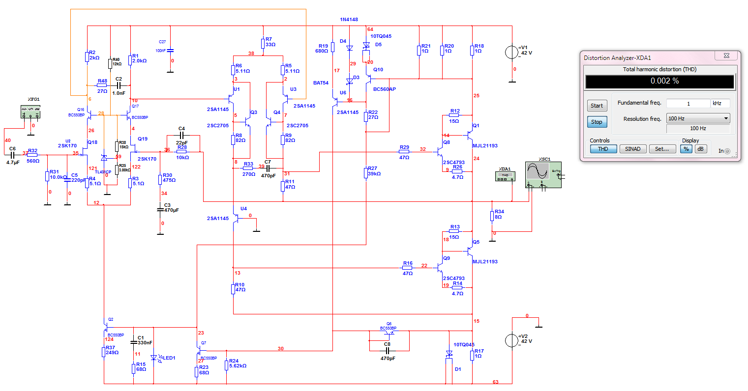

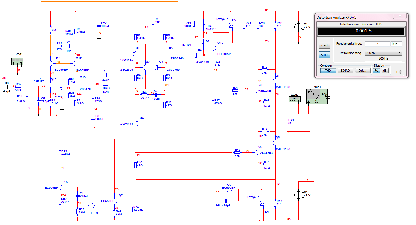

the complementary Elvee circlophone.
Waow! this circlophone is not "little and cheap" anymore: it is the "Posh Circlophone".
There are many worthwhile improvements possible over the basic topology.
The posh version includes one of the most useful: a FET input, that eliminates trade-offs between bias current modulation and input impedance.
The other modifications are quite sensible too.
I see one other point where easy improvements can be gained: replace R27 by a 2-wire current source (I have described some suitable varieties in other topics).
This will improve the PSRR, make R22 superfluous, and allow the same circuit to work from +/-10 to +/-100V without alteration.

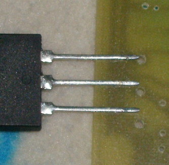

I etched and drilled one pcb yet. When I try to fit 2sc5200 (to-264) and some similar transistors (including mt-200) as output, but i saw that layout's leg distance was wider to fit. I checked original TIP3055's leg space dimensions in datasheet and I see that it is match to those I had to try. My measured two leg distance on pcb is about 7mm.TIP3055 in datasheet and other devices i tried are about 5.5mm.
i used TOP3 package, since that's what i can get 2n3055's in except for TO3.
but i can change to TO-264 no problem. i prefer 2sc5200/2sa1943 myself.
pinning is the same tough.
if you've found other problems (such as packages, clearance etc. not another redesign), let me know and i will correct them. attached TO-264 version.
