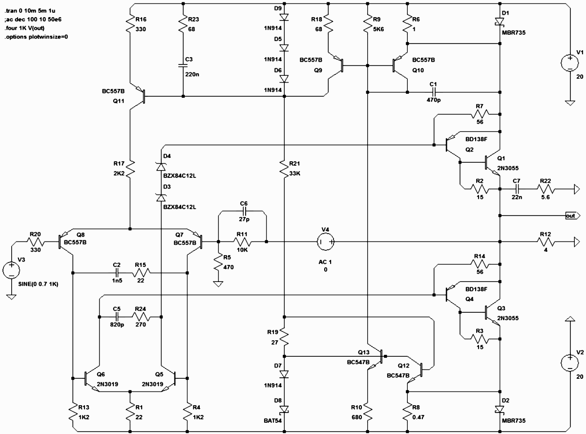

Since you make modifications, it would be nice to take the feedback directly from the output pad: this will avoid asymetries and distortions caused by the track resistance.
I still think more could be done to clarify this schematic.
I prefer your (cleanup of Elvee's original) way drives are
routed, over my re-drawn. Much less confusing to keep
the drives together as the pair that they are.
But I still prefer my way of drawing diodes straight down
the middle, as they are all in a series. Also current mirror
style of drawing transistors paired near the top, better
shows how the emitter voltages are forced to be equal.
http://www.diyaudio.com/forums/atta...tle-cheap-circlophone-circlophonem-redraw.gif
Obviously old -M ref designators won't match current PCB.
If we merge these best of both ways of drawing this circuit,
I think it would become much easier to introduce to those
yet unfamiliar with its rather unusual theory of operation.
R14 (new ref) probably deserves special comment added
to the drawing, PSRR function is not at all self-evident.

i do realy like your drawing, i must have overlooked it when scrolling this thread. not much to improve there!
if we would merge our versions the whole readability of the original schematic would be much improved.
i now see how to group the "mid-section" with the series diodes. my PCB could be improved by that :)

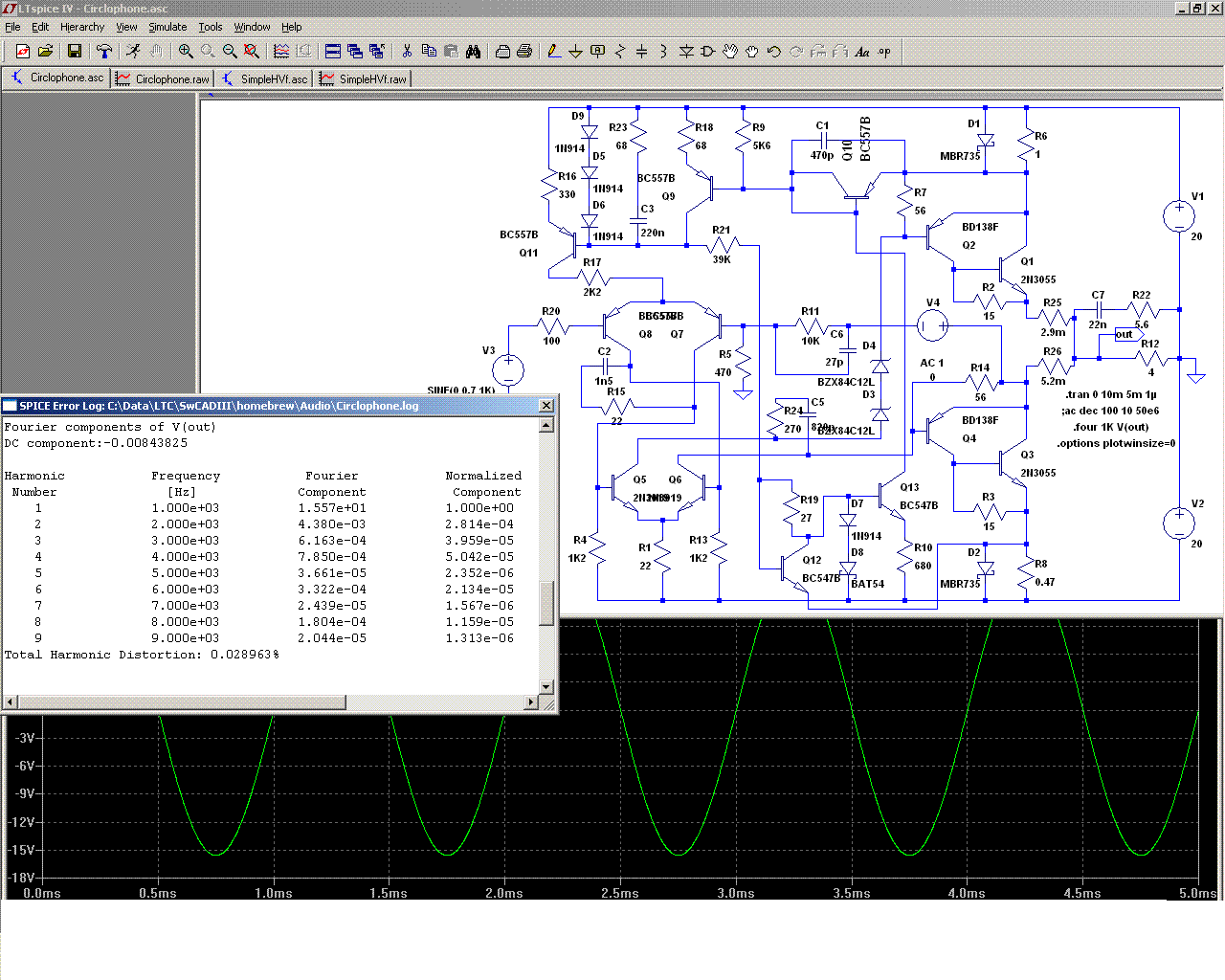

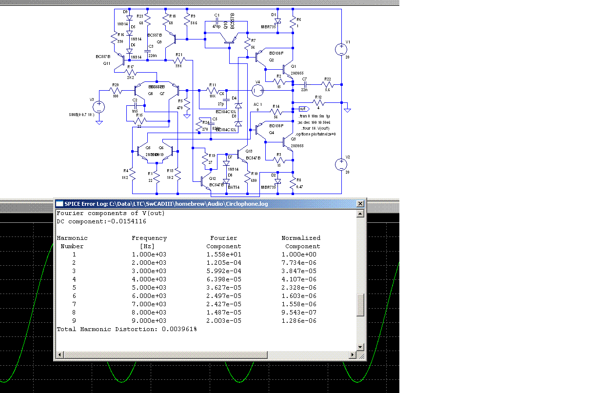

I am not sure it is a good idea: without a local decoupling, it won't be possible to achieve the transient cleanliness displayed in the oscillograms at the beginning of thread.
There is still plenty of room in the middle of your PCB, and it would certainly be possible to include at least a minimal on-board decoupling: nowadays, 10µ/63V caps are tiny, and they would make a big difference if there some length of wiring to the supply caps.
If you choose to include them, place the supply pads in close proximity, to avoid creating low impedance loops in the tracks.
I reiterate also about the respective placement of the output pad and the feedback take-up point: as they currently are, they will easily cause a doubling of the THD.
will place the decoupling capacitors back in, and will try to re-route the feedback.
however, i don't think that the trackresistance makes the difference.
my main problem with placing the caps is that the central ground plane at the output doesn't have a large trace to the rest of the ground. but i will fix that.
I can assure you it does, and it even has a more dramatic effect than what I had first guesstimated.
I ran two simulations to compare the situations: first, a "normal" one, where the track routing is state-of-the-art, and the other one based on the actual layout, including the tracks resistances and configuration estimated from the drawing, assuming standard PCB process.
You can see the effect of several misplaced milliohms: the even order distortions shoot up by a factor of more than 10!!!!
The overall THD figure increases from ~39ppm to 289ppm.
On the first version of my prototype, the initially measured THD was in the 40ppm range.
After a careful clean-up and some component rearrangements, I arrived at 15ppm, better than in the sim.
This means that the effect of the layout is not benign at all, it can very easily ruin an otherwise excellent amplifier.
That is the reason why I am so finnicky about those seemingly secondary "details".
PS
If you tin the tracks, or if you use heavier than standard PCB copper, the observed effects will be attenuated, but they will remain significant.
Even with superconducting tracks, an inductive effect would remain. I didn't model the inductance in the sim, this means that in reality, the situation will be even worse than predicted
