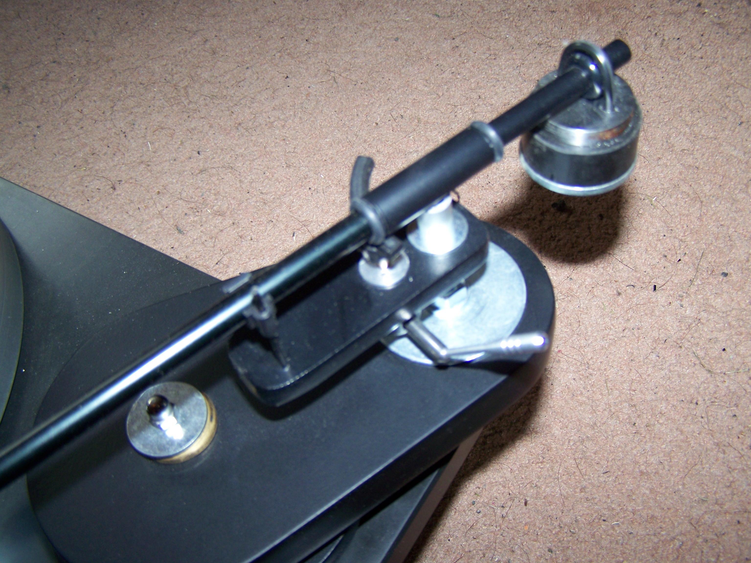

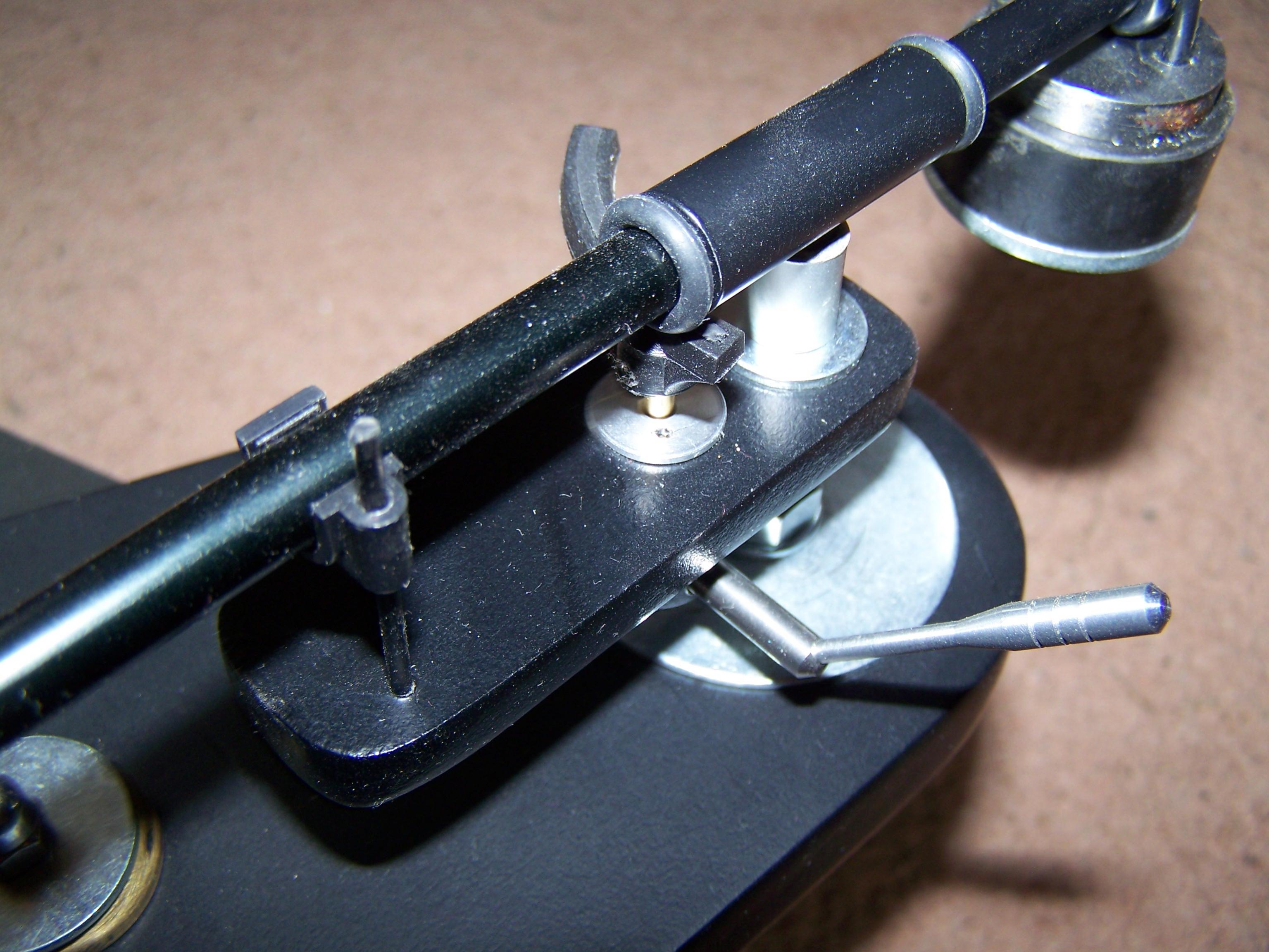

I've been spending my time trying to get the fit and finnish to a level that folks may actually put out their hard-earned money for, and that they can have some pride of ownership in. So far the single largest issue is the arm cueing lever/mechanism.
I still feel much better about using a proper set screw for the female bearing vs. using a fuse end cap. At least this way it could be changed to a jewel Vee bearing cup easily enough as an upgrade if so desired. I really don't see the need to vary from a pen nib for the male bearing though.

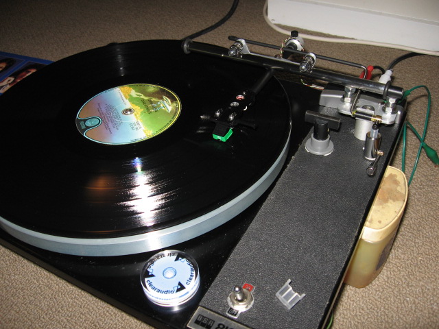

How about something like what is usually used on Colin's linear arm?
http://www.diyaudio.com/forums/atta...761-diy-linear-tonearm-linear-tonearm-001.jpg
Just a rod that pushes the arm tube.
It can be used on the back pushing the arm down, or on the front pushing the arm up. Whatever fits your design best. And you don t even have to do it like in the photo. You can just do a lever with a single pivot to push the arm.

I ve live with an RS-A1 for a while and I have to say that having no arm lift is a PITA for me...
So, design one.
Rega style arm lift
sachu ,
great to hear from you!(and I hope all is well with you and yours)
I looked at the Rega lift and it does look like it could be a possibility. I always "assumed" that an arm lift would be the easiest part. I have a Linn Akito II arm here that has a pretty simple lift as well. I'll look closer at that one. too.

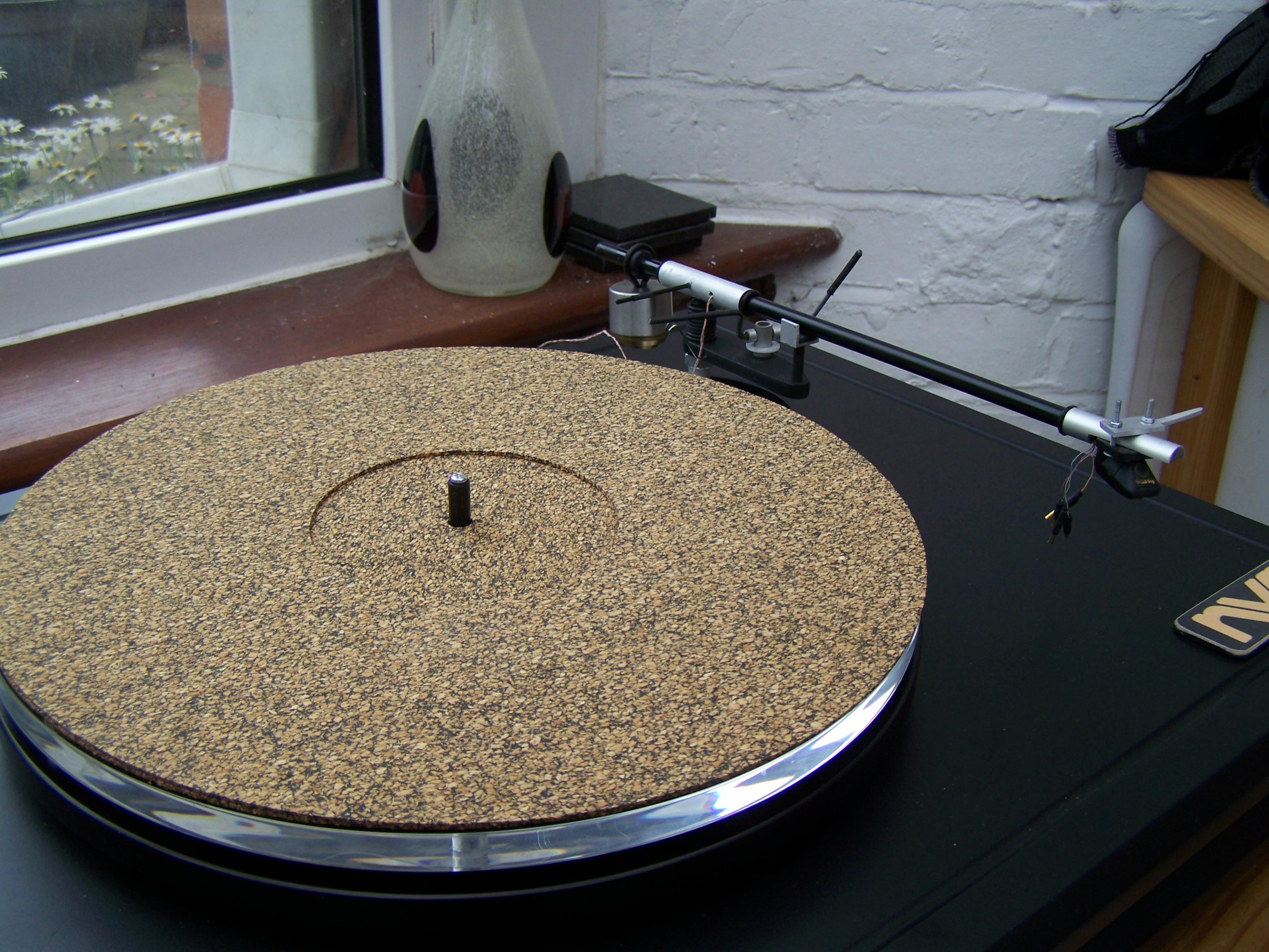

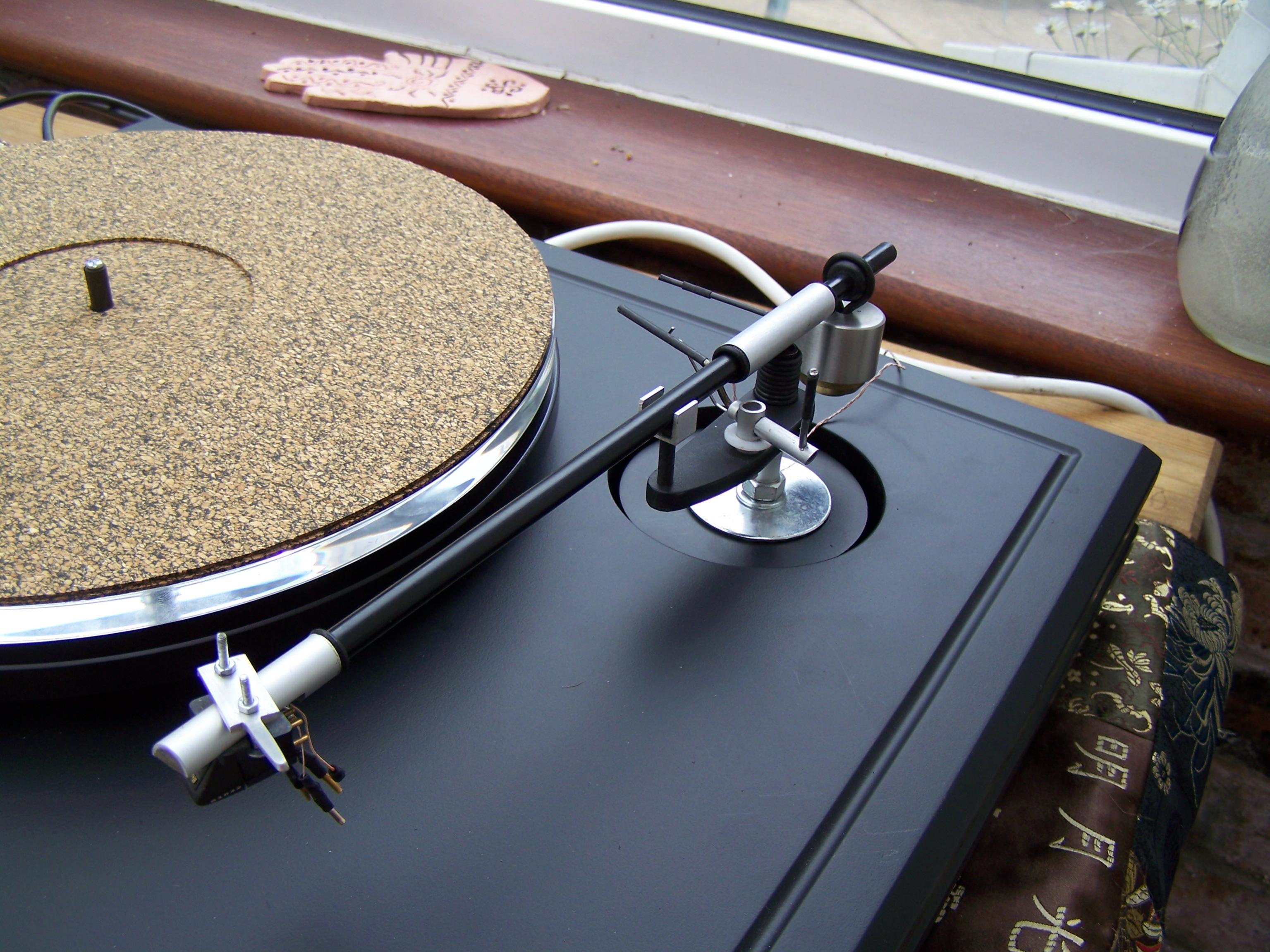

Lift/Lower Device
Hi Folks
I've been very quiet on this thread recently-my work contract was terminated and I had a lot of other things to think about! However the new job starts on Monday (phew!!)
I'm offering three versions of my design of unipivot:
Regards
Chris
Hi Folks
- No lift/lower device
- My design which works very well. It's undamped but very easy to use and looks pretty good to me. No extra charge for this.
- A version with the genuine Rega lift/lower. This is expensive at a £25.00 premium but people seem to be prepared to pay as the total arm is extremely good value.

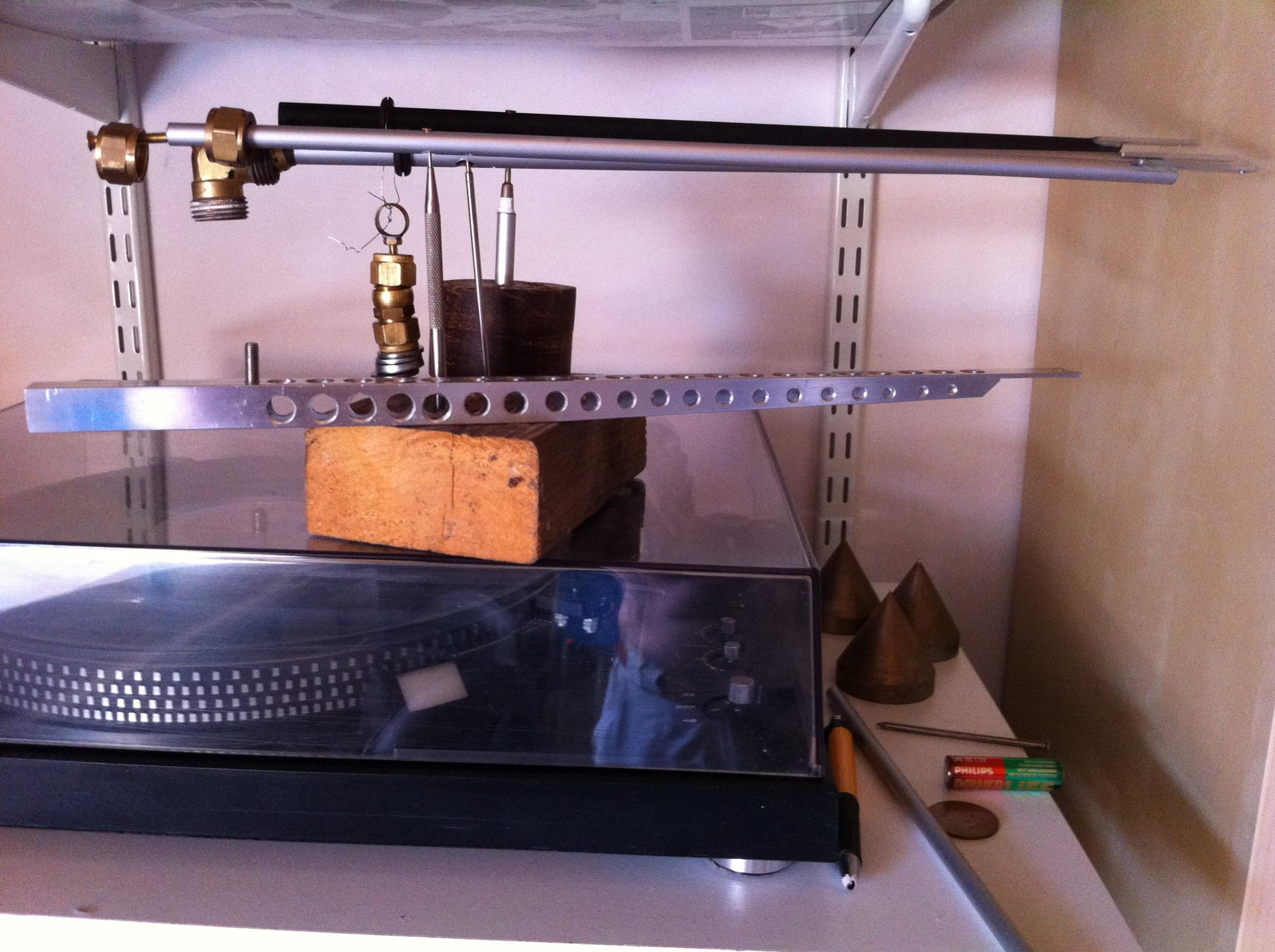

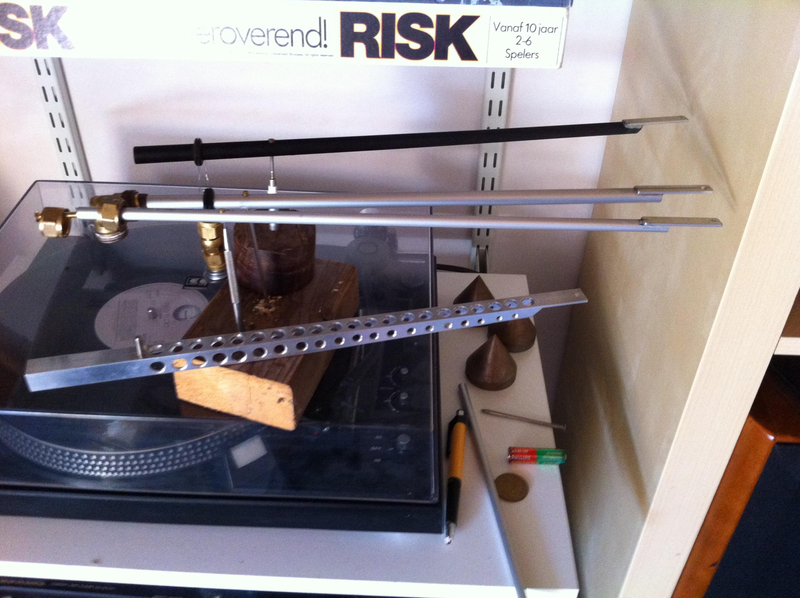

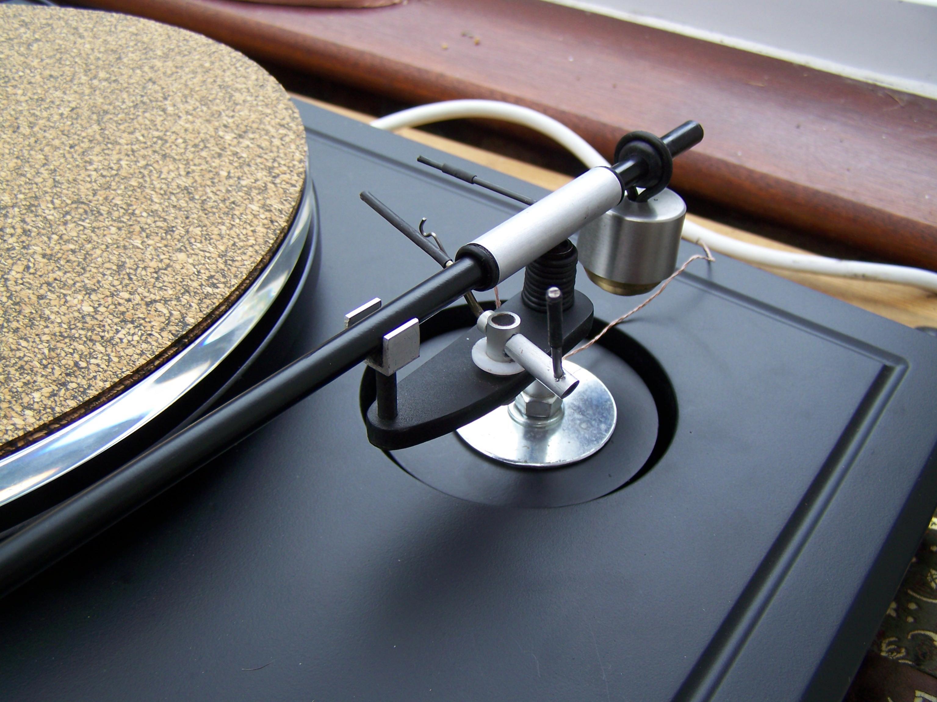

I started with a piece of carbonshaft of a golfclub, and ended with the question "how to make a headshell". Ok , use a piece of 10 mm alu tube, cut and sand it in shape en fix a small alu piece on it.
So done... then the question who don't use the alu tube as an arm...
And why not do the same with an 8mm alu tube...
And seeing an old Gray unipivot tonearm... why don't do something like that with some alu stuff lying here doing nothing.
So instead of one 2.19... it became an "8.76"
Next is an armbase, and a "twinpivot diy version"of the simplicity tonearm...
