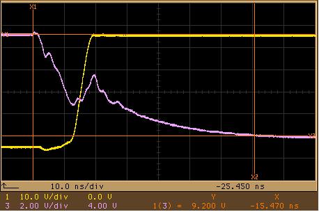

Attached is a picture of a “budget” 120W output stage – with no snubbers or tricks – its really not the greatest design (the simplest I could do at lowest cost) – however it does switch 50V in about 2nS with NO ringing – note we are looking at the Pch switch event – always the worst from the Gate charge perspective.
The Yellow (10nS / Div, 10V / Div) trace is the output swinging 50V in about 2nS notice NO ringing, the Purple trace is the Gate, also notice how the Miller charge reverse couples into the Gate and brings Vth below Ton for about 10nS (remember we are looking at a Pch device). The probes have been “time compensated”
This is not a great OPS however total cost including drivers was about US$2.20 – for a 120W 8Ohm output stage – less then 2 Cents per Watt, and distortion open-loop was still below 0.08% at full rated power.
John

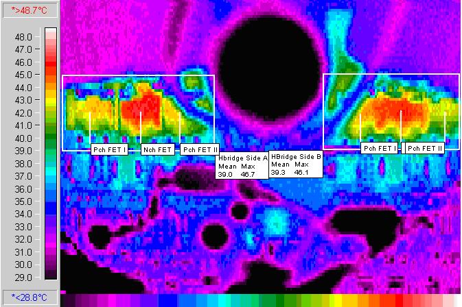

Below is a thermal image of a 2x SUD10P06-280L & SUD15N06-90 (per HBridge side) output stage, it’s been operating at 110W into 8 Ohms for 30 Minutes continues – the only heat-sinking being the 2 ounce copper PCB. Clean / fast switching, with no ringing is the secret to this performance.
John

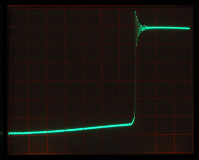

Mikeb, is that without load? Yes, I think that's too much ringing.
It can be caused by excessive inductance in the switching node, or poor decoupling of the supply lines (the caps should be very close to the mosfets).
I also wonder why do you have a not flat negative phase.
Best regards,
Hi Mike,
You don’t give a V/Div for you scope image – so it’s impossible to comment – also what type of scope/probe you are using – if you’re using a 100MHz type scope then it most likely will be much worst – but I would be unhappy with the ringing…

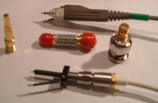

The trick with probing fast rise-time signals is to use a Scope Probe with a very short Ground connection next to the Tip,
Below is a poorly focused picture (my camera does not have a decent “macro” function),
Top to bottom: -
Tek P6245 1.5GHz active prove – ok to about 15V, notice how both the Ground lead (the head is laying in it) and probe tip can be soldered directly to PCB – for fine SMD work
TEK P6150 resistive probe tip (Gold object – on the left corner of the picture) – limited to 12.5V RMS, very fragile “Tip” and no easy way to attach to PCB – but good to 9GHz and above
DC block & BNC to SMA for scale
HP54006A Resistive Probe (with X10dB Head (450 Ohm resistor)) I use this with 60V swing output stages – easy to solder to PCB – good for 6GHz+ A Great probe for OPS work.
I guess that with a decent piece of COAX and a 450 Ohm resistor (the HP54006 x10 head uses a Caddock MD1247 450R 1%) you could construct your own 50Ohm HF probe.
John

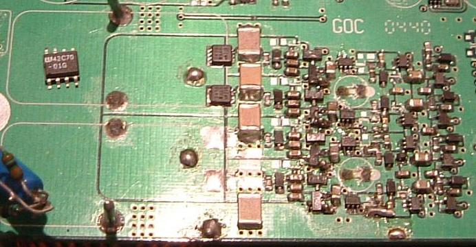

Hi Mike,
“Few cm away from the MOSFET’s” Wow – that might as well be KM away….
Here’s picture of one of my typical output stage designs - 120W full bridge – note I’ve blown one pair of output devices and these have been removed (the lower pair in the picture - now just exposed solder pads), along with a decoupling cap.
But notice how I have 1uF 1210 HF grade ceramic decoupling CAPS as close as physically possible to the MOSFETS – these caps decouple the output devices on each HBridge half side AND across the bridge (load current flows across the bridge).
The MOSFET devices are the VISHAY – SILICONIXS Si7414 /15, and notice the Limited PCB heatsinking required for 120W 8 Ohms. (The SMD SO8 device sitting near the "Heatsink PCB area" is there for "Scale" only)
