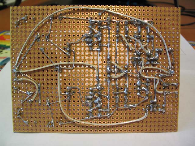

You mentioned using the heatsinks as some sort of shielding.... they might be making better transmitters, which your coil might pick up nicely. It seems well worth bolting a small HF bypass cap to each heat sink, espcially given where you take your feedback from.
Seriously I'd like to see the bottom side of that board. Excellent work as well.

Chris, i attached a shot of the first prototype bottomside...
(This one used folded cascode for levelshifter)
It misses the 3 paralelled 1nf-caps... :D
I added one 1nf after the other until i reached near overshooting !
Yes, a PCB would help improve the signals, and should greatly
reduce ringing. But my intention with this amp was to make a simple
amp, easy to build (this excludes SMD) using standard components,
so that everyone can build this. Just to get back to the DIY-spirit like
it is with solidstate-amps. Just build and listen... No exotic parts...
It took me ~4 hours to construct the whole thing... (and 2 weeks to design...)

Well Mike thanks alot now I'm ashamed of my work after seeing that. I'm not shy to say this either, the bottom of your board is cleaner than the top of mine. I was keeping my "good perboard" for the second project though, this one has traces, and by using them I see now I've compromised my layout, which I'm paying for now because it's noiser than it was on a protoboard. Before I give up on it though I'm going to try re-routing a few things (is it there yet?).
Hey you know when I said "crappy class d" I didn't at all mean "your crappy class d" but rather the non store bought, tuned to perfection with many hours of listening tests along side of an AP2, using the very best construction techniques going ..
Basically class d the DIY way (they said it couldnt' be done!).
I fully agree with you anyway, the dynamics from them put your average amp to shame, and I find you can tell that right away, well before any optimizing has been done.
I placed my PNP turn off transistor right on the mosfet pins on the underside of the board. The turn on transistor is about an inch away on the top side, would have been closer but I had to place it around the heatsink.
