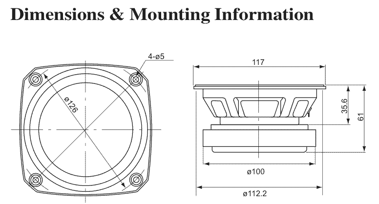

italynstylion said:Does anyone know the diameter of the mounting holes for the Fostex 126's?
Fostex published data
dave
dave
One important dimension missing from that sketch is the actual driver cut-out size - which I just calipered at 104mm. While I'm fortunate enough to have a CNC available to route these with flush rebate for the pincushion frame, I've found that an exactly 4" holesaw has just enough tooth set to work for the drivers with this basket size ( FE126/7 & FF125K). Hand bombing the rebate with a router is less fun
With less than 8mm margin on the narrow sides of the basket flange, and with only 4mm diameter difference (i.e. 2mm gap) to the magnet, the FE126 is a tight squeeze.
