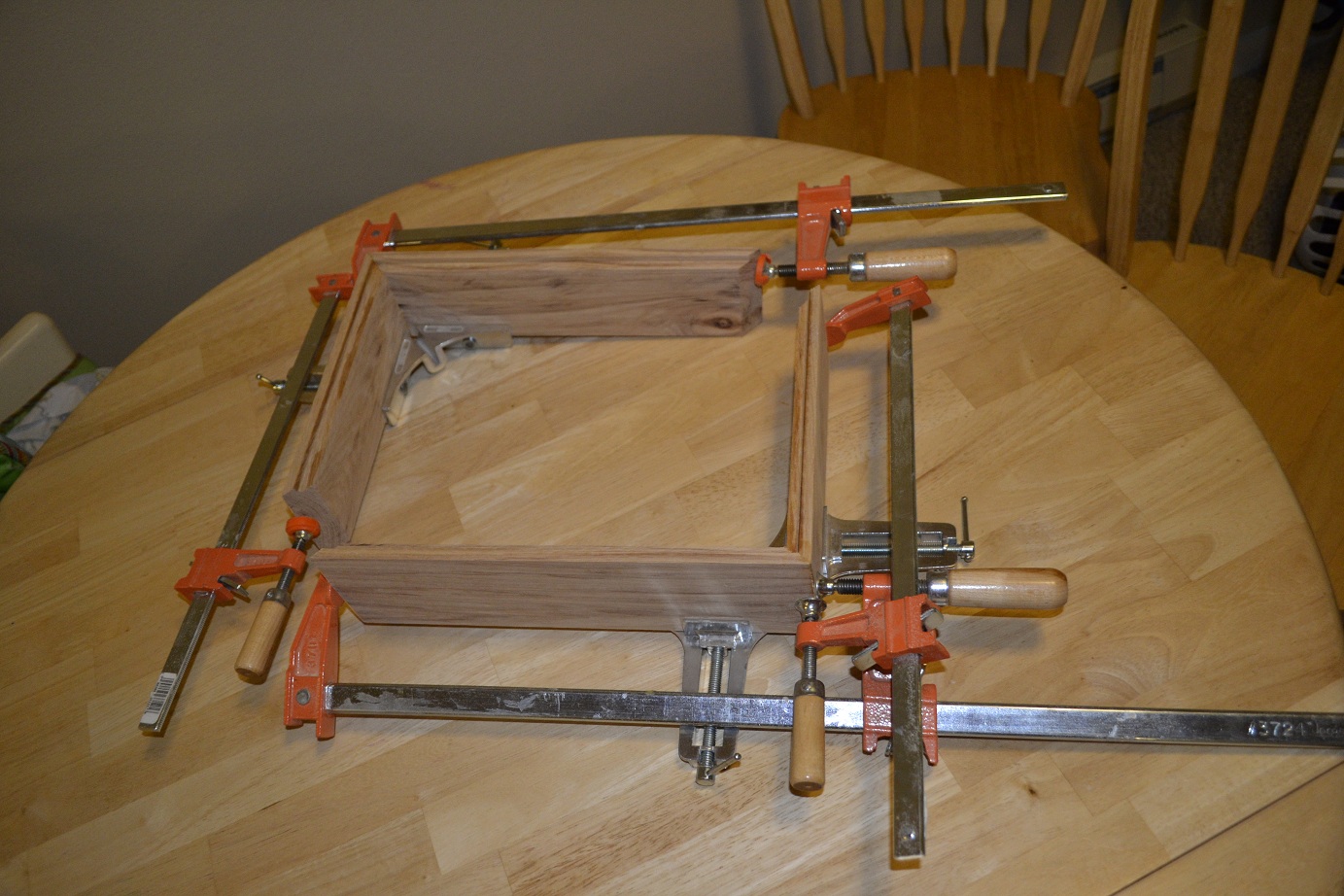

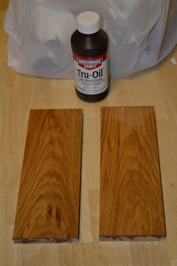

Here are the side pieces for my preamp.
I picked up 24 sq. ft. of 3/4" x 6" unfinished hickory hardwood flooring on clearance for $10.
They are tongue n' groove which is nice since I will be flush mounting aluminum on the top of the chassis.
This stuff is beautiful.
I'm just going to finish it with gun stock oil and wax.
Final outside dimension of my preamp chassis will be 8.75" x 12".

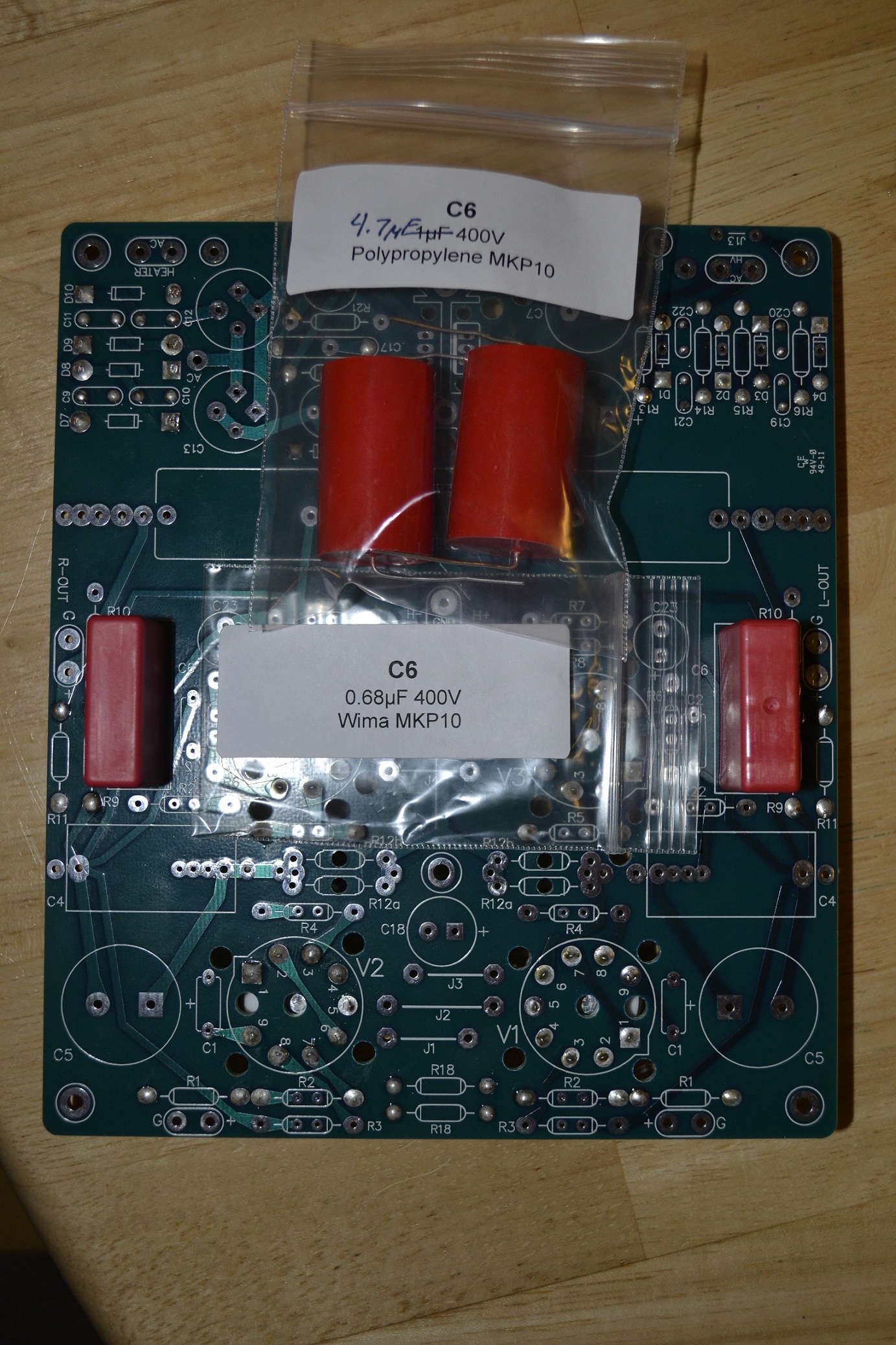

C4 Quandry

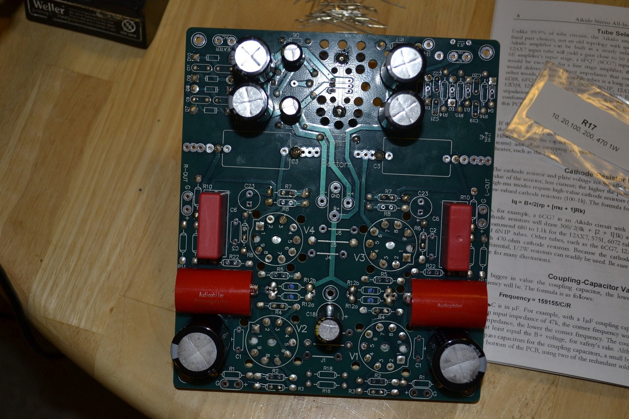

So......I have two baggies with C6 on them.
One is a pair of .68uF WIMA's and the other is a pair of 4.7uf Audiophilers.
I placed the WIMA's @ C6 where the silk screen has a nice rectangular space for them, is this correct?
Are the 4.7's really supposed to be for C4? It looks like there is ample room for them.

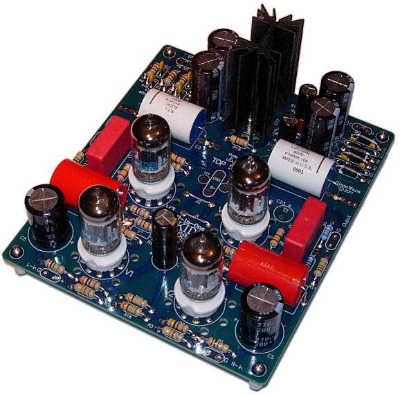

I know John messed up some of his kits, because he cut and pasted the PSU from one project onto the main circuit from another, so sometimes you get things like this.
The wima caps will be something in the PSU. The 1uF/4.7uF would be the coupling cap (there is only one coupling cap in the signal path, or maybe two if that board has two outputs, as some aikido boards do). Can you post pics of the pcb from the top showing the whole lot, along with a photo of the schematic from the manual. Then we should be able to figure it out.
Joined 2011
The picture that Globug posted is exactly what I ordered and those two red round caps are the ones in question.
All is well for the time being.

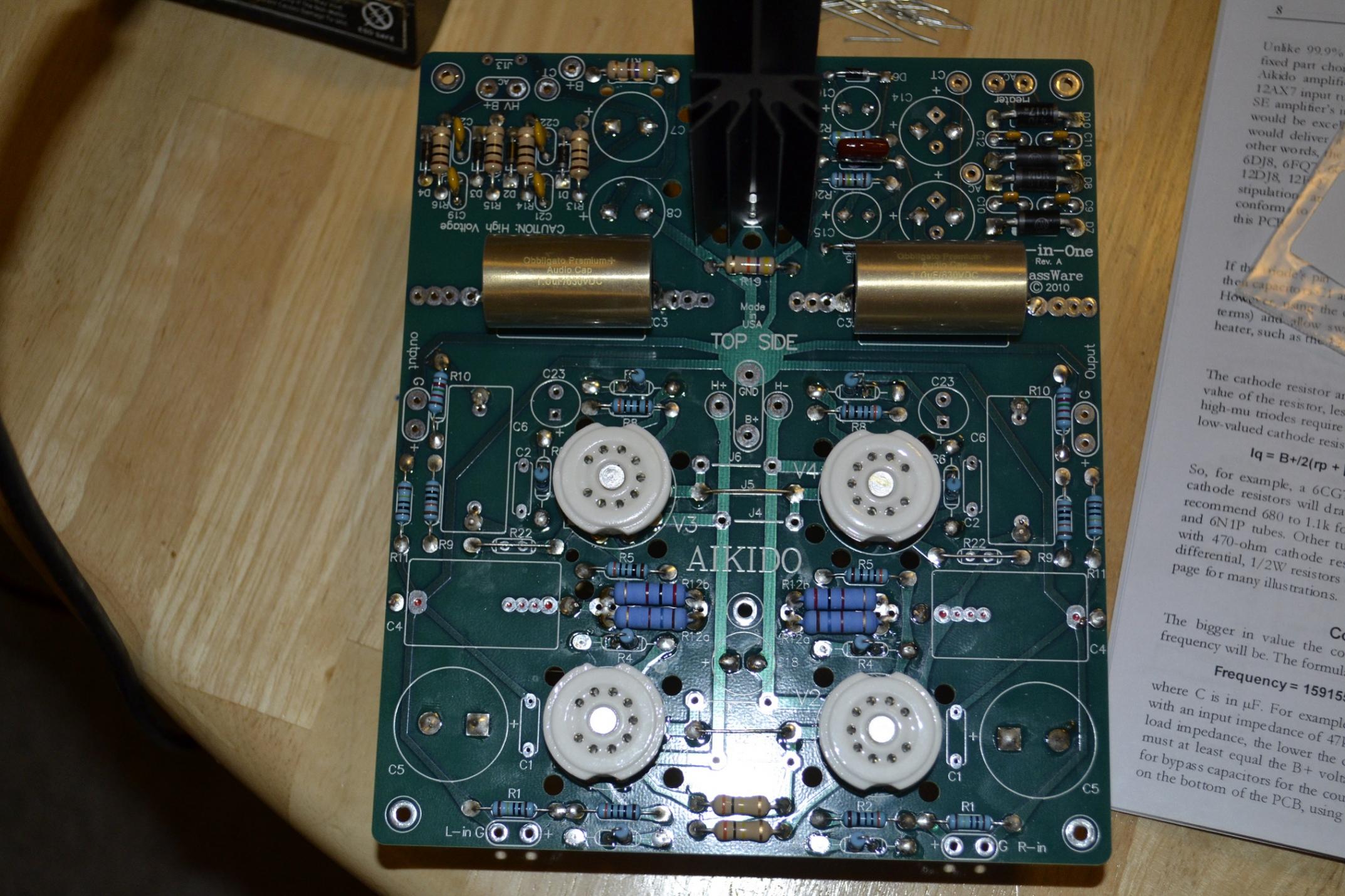

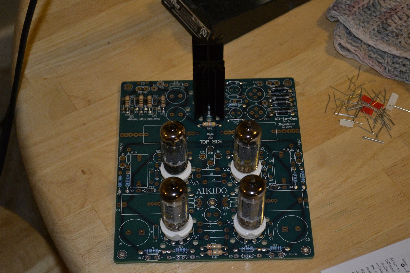

Progress Pictures
Here is a picture of the topside & bottom.
I have placed all of the large caps on the backside.
The tubes, heatsink & obbligato's will be coming out of the top of my chassis through an aluminum sheet.

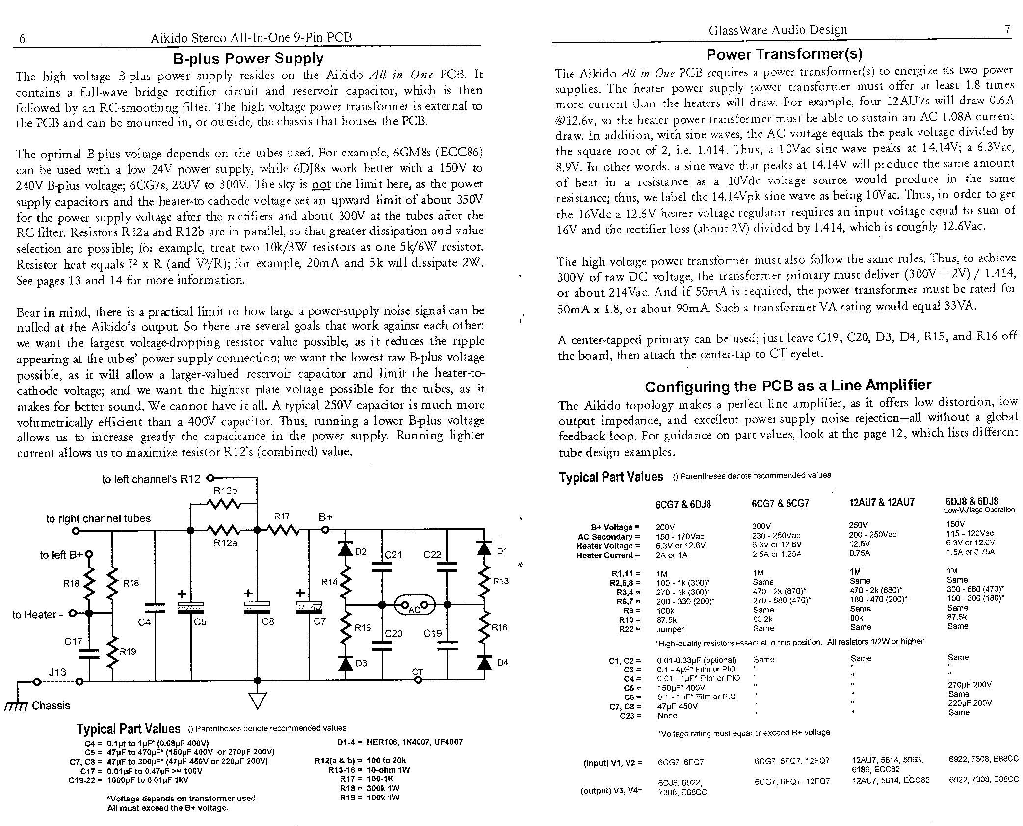

It appears that many of the variable value parts are tagged "This value takes experimenting.".
With this in mind I just guessed 470Ω for R17 since it was close to the middle of 100 & 1k.
I hope I don't blow anything up.
This may get powered up by Friday.
It all depends on how chassis building goes.
Joined 2011
I've got the 4.7uf handled. Tonight I will continue with chassis construction.

Here is the R17 portion of the manual.
