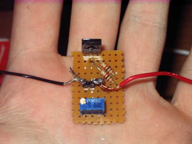

Here's my board. A problem though, I cant seem to get readings off of it; has my bd139 blown? I'm getting about 0.03 ohms all the time... almost normal conductor, but with a tad bit of resistance. I'm pretty sure its wired up right... let me know if I'm wrong. I've checked for short circuits... Its not the prettiest solder job, but there's definitely no shorts.

Ouch Johan that makes my eyes bleed....
Very scared of those exposed bits of wire, and would recommend a solid core wire rather than stranded with those veroboards...
Make sure to leave only enough exposed wire to make it through the hole..., the heat normally makes it shrink back even more...
Even better buy some heatshrink and push it up the wire first do your soldering and slide it down against the board to insulate the exposed bits..
Did you look at the bias servo boards on Greg's site a little...?
I see you went with a layout I have not seen before for this piece... which brings with it, its own risks.... try to build onein the standard form... I find a veroboard strip of 7 by 3 holes is perfect...
While you have the board off, desolder the bd139...Now you will learn, next time to solder that transistor flat, as opposed to in the holes... (they just make it hard to remove afterwards)
Test the transistor with your multimeter on diode check mode...
from one pin on a transistor (base), there should be one way connectivity to the two other pins.. will show a forward voltage drop in the range of 500 to 700mV on the screen.... it must not conduct when you invert the probes or be able to cunduct between the other pins...
You don't even need to know which pin is which to test... start with the negative probe on a leg, and test to the other two... if nothing, invert probes, and do again.. if nothing move to the next pin until you find the pin that conducts to the others, then make sure it does not conduct when probes inverted...
http://users.tpg.com.au/users/gerskine/dxamp/dx amplifier-04.htm
now rebuild that little board into something that will not be a permanent hazzard :D
this is called a diode test...:D

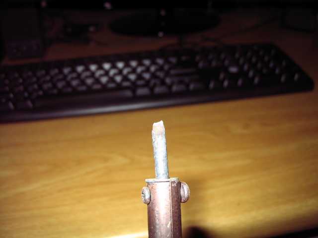

Hmmm.. long day. Some bad news; my soldering, she is broken! Completely; seems at some point today it got knocked off my desk, took the entire tip off on the way down. Put a photo up.. Its alright I guess, wanted to get a new one, that thing wwas old and rusty
But now I have to wait to get paid before I can buy one and get soldering again, or cart all my stuff into varsity and try solder there. So, I thought I'd push on with that diode test... my iron acts as a pretty good area of effect solder nuker now, so getting transistors out shouldn't be too difficult =)
Sorry about my messy bias.. Never been the neatest designer :/ A couple questions; I have used 2 1k resistors to make up the 2k resistor; this should be fine, not too much leakage? Guess I could go buy some 2k's... Just lazy, and petrol to mantech costs so much, especially from tomo on. I can probably build those boards at uni, so small, and I can run one of their nice soldering irons with some extra solder along all my bigger board's tracks, sounds like a plan.

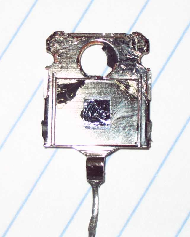

Lastly, I'm gonna get the 2sc5200's out my burnt amp, and scrape it away, but im pretty sure its a fake... My best bet for getting the real thing is Communica I guess?

Yep, man throw that iron away... it belongs on an oxwagon...
It is like doing waterpainting with a stick to try and work with that. You will thank me later when you get yourself a nice little station.. I know times are tough... but I would insist on a decent soldering station before a good multimeter...

I broke mine open... Quite the mission, messed my hand up a little doing it; only got the big pliers out half way through and did it properly... You can see from the scuffs. I've included the picture of mine... It doesnt look like that fake you put up nordic, im not too sure if it is, let me know what you think. A question though, not too sure how technical it is, and just out of personal interest; Why aren't the other two legs soldered on? I've studied JFETs, BJTs and MOSs theoretically, but never physically; Why are these transistors built like this?

Yep, those don't look too bad...
much better than the one I got.
the die is mounted on the rear plate for heat dissipation... the tab at the back is, as you can see, directly connected to the centre pin, this gives a solid subtrate to handle i nthe machine as well as allowing for heat dissipation through the PCB traces.., the other legs are just connected with silkthread thin wiskers of wire to the die.. kind of puts the wire thicknesses we use to shame... if the other legs were soldered on, it would be a dead short with the centre pin

I have really tough week up ahead, work wise, so I won't be able to get much done. I should be getting a soldering iron during the week, a R500 effort, it looks quite nice. A couple of questions on soldering though; I've always considered myself quite good with an iron, but maybe I'm not. Variable temp control is only really required for IC's, not so much transistors, hey? I attempted to apply heat at even intervals; I'm not sure how much damage irons are capable of doing to some of these components. And could someone send me a photo of good-looking solder on a board; I would send in mine for judgment, but my digital camera just died on me. Finally, the solder itself; nothing special required there. I have.. solder.. don't know where I got it, had it for quite a while and I've almost run out so I'll need some more, but for the most part, electrical solder is electrical solder, am I right?
Nordic, so these transistors look good? Think I should be buying another one to replace the one I broke, or waiting for something other than toshiba's to come in locally. I've got the 2sc5200 datasheet on me... cant figure out a worthwhile diode test for it though, to check out my other one. and there's no possibility the 2sc1943's are fake?

I think you should increase the size of the 2k2 resistor to the next size up next time, and see if you can adjust bias over a larger range...
As explained before the negative rail draws less current than the positive side... so you just need to measure the + rail during bias.. for now.
I would continue useig those transistors.
I think you will enjoy your nice soldering station... it realy moves things up a few notches...
I think it is nice to have an adjustable temp... too cold, and you have to linger on a component before the solder flows, too high, and the flux has evaporated before you start, and the solder turns to balls of useless snot.
I use about 350C and try to keep a count in my head of about 5 seconds max to apply solder... then waiting a few seconds (maybe solder a leg on another component). Generaly though 60% of sodler spots probably takes less than a second..
Remember to get some diffirent sized points, a nice fine pencil point, and a smallish flat screwdriver tip shape..
