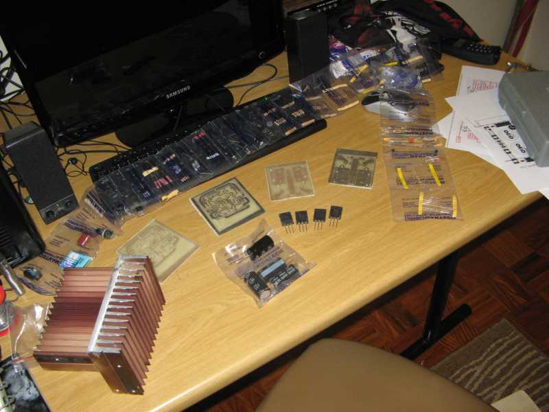

I ordered my components today, should have a quoted price by tomorrow, but its pretty cheap; R180 ($30) per channel, for amp and PS. If I get the parts by the weekend, I'll get building soon.

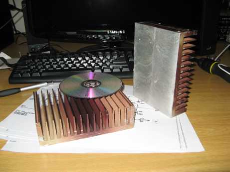

So yeah.. got some nice heatsinks, threw up a picture of them, they look pretty at high quality, had to scale them down so the jpgs were small enough :/ Still, should be enough for 50W per channel im sure. Just gotta grab a nice enclosure now; trying to find a suitable base.

Where did you get that sink...? its lovely

They are pretty sinks! I got them off one off the senior technician at uni, traded him an old text book for them and the printing of my 4 PCBs; his son has just started the same degree as me. He was really supportive of me anyway, gave me some great guidance on building the amp. So, a pretty sweet deal! I think they were supposed to be used for motor drive transistors, but the company went under, had to dump most of their stuff, my senior technician got donated a whole lot of them, and now two of them are all mine. They were custom made by a company here in Durban i think, rather tasty looking.

I'll get my PCBs tomorrow or friday, throw some photos up when i start building. I think Im pretty confident from here on out, at least as far as construction is concerned, but I will need some of you wizened amp-builders' help afterwards; on how best to set up that bias.
