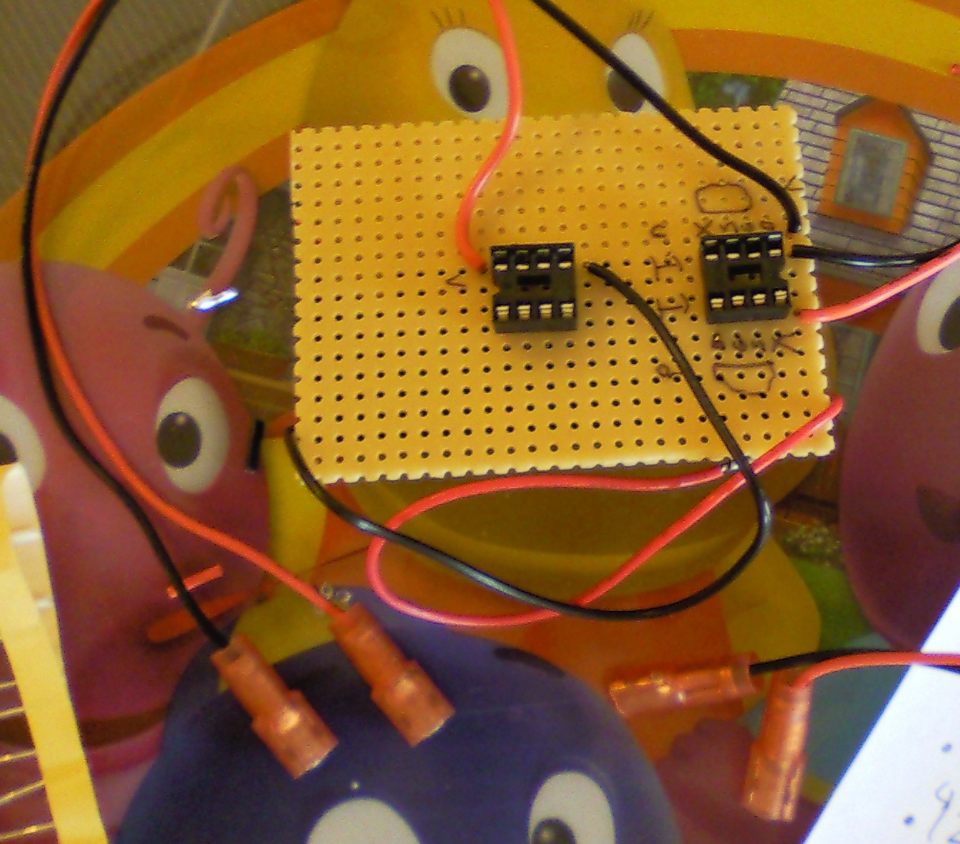

I have just finished building a 4wire measuring board for matching my .47Ω resistors, a bit of a pain in the *** but worth it.

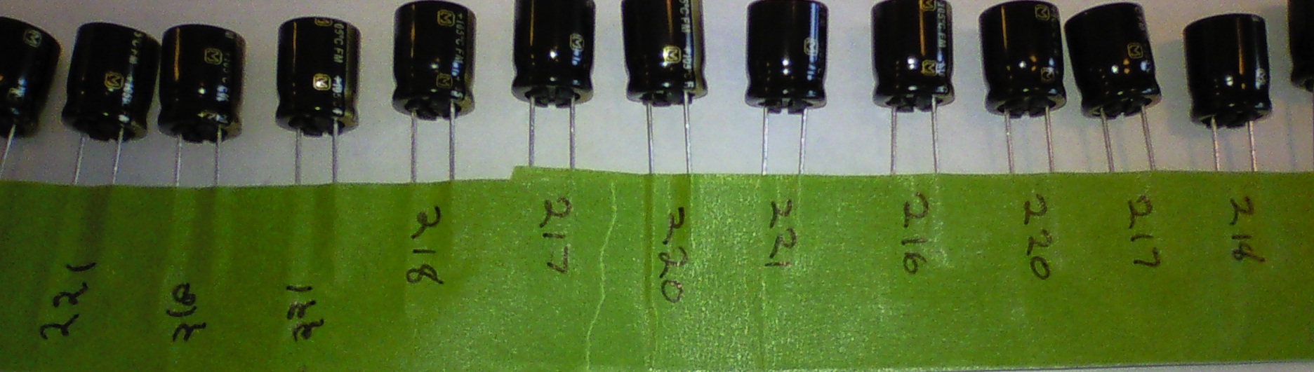

I have matched my .47's and my 220µF's, I don't know if it's really necessary but I suppose it couldn't hurt.
Now I will work on getting the Binding Posts installed.

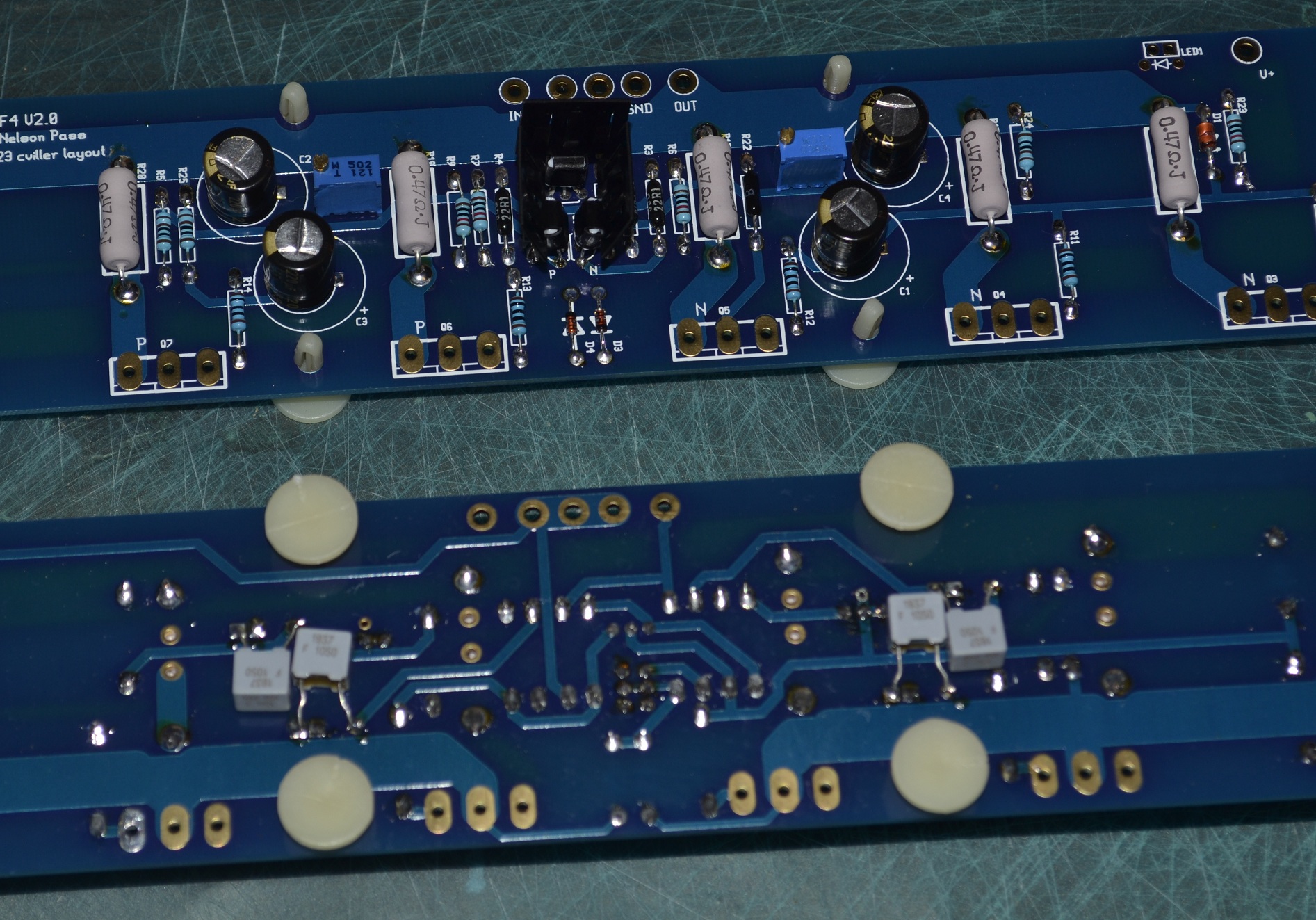

Boards Finished
I have both boards completed, It was a bit of a pain to get the old fake J-Fets out of there but the new ones from Spencer are in now.
I ordered a few TO-92 heatsinks with my last Mouser order, I don't know if they will help any but they probably can't hurt.
I also bypassed the 220µF FM's with some 10nF 1837 MKP's, also figured it couldn't hurt.
Now will be a bit of a wait before I will have the P/S done so I will be focusing on the chassis in the mean time.

Joined 2011
Would it be ok if 2 of my output FET's per channel were hooked up with wires instead of soldered through the holes?
Or should I just hook them all up with wires in that case?
There is some mounting hardware on my heatsinks that is in the way of the inner two FET's.
