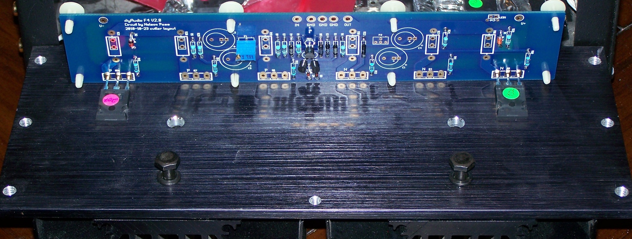

Well......It looks like I am at a bit of a stall on the PCB's.
I'm hoping the rest of my parts from Mouser will arrive on Friday so I can complete the PCB's minus the JFET's.
Now I guess I will move on to the chassis.

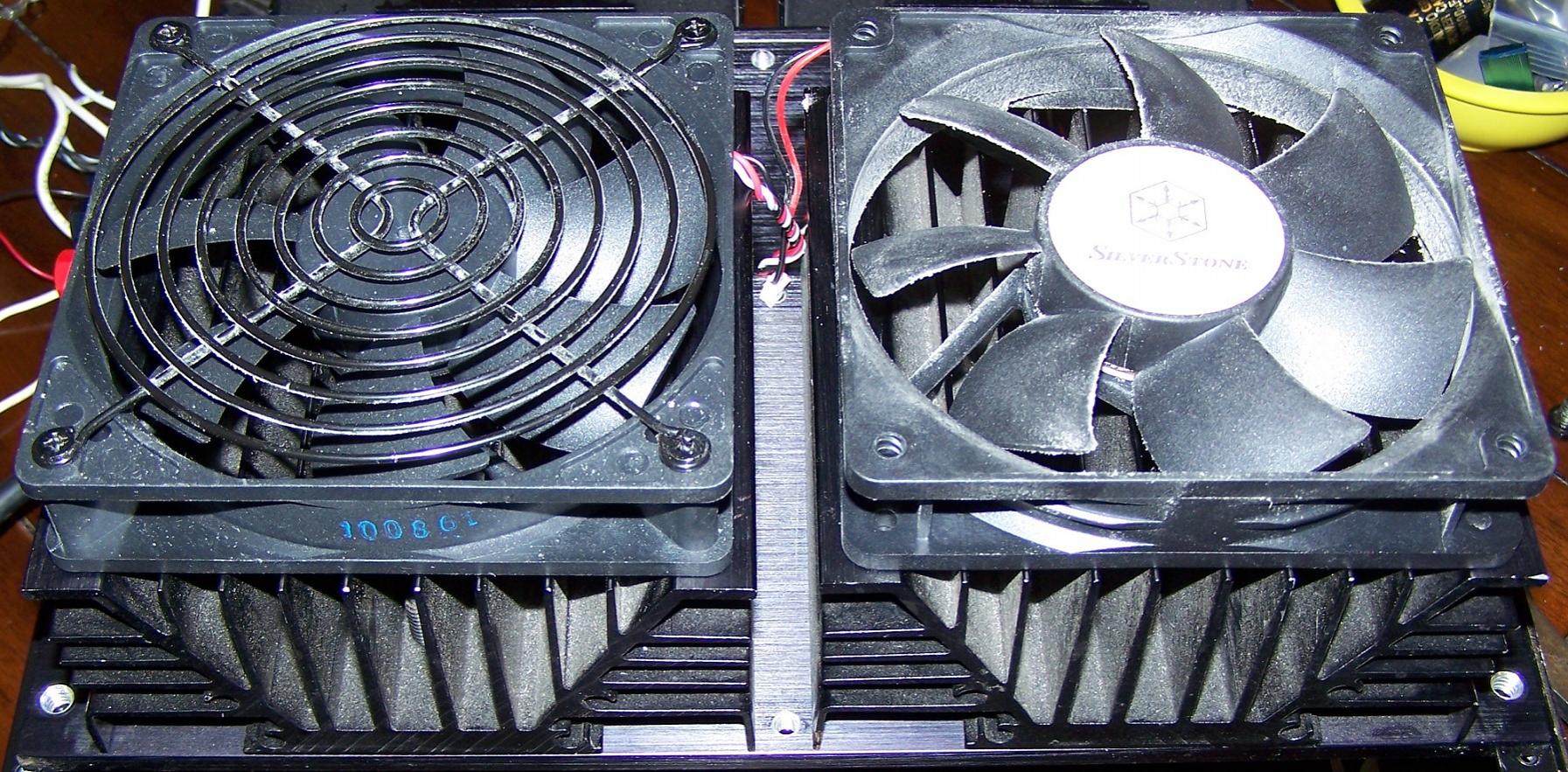

I will fan cool these with each heatsink having 2 120mm fans for a total of about 100CFM per side.
These are not the fans I will be using but they represent the size of what I will use.
I'm hoping that will make up for my heatsinks only being 5" tall.

I was looking at the Arctic Cooling F12 Pro.
They are 54cfm at .5 sone, I was already looking at using some type of thermal sensor to adjust fan speed and bias current for max bias at 50-55 degrees.

Hi Einric
2 comments on the fan.
1. 'Fluid Dynamic Bearing' ?
What the dar.gon. is that ?
Ball-bearing is what's needed, surely ?
I hope 'FDB' is not an acronym for 'CHEAP' !
2. Not in a standard fan 'form-factor'.
Possibly makes it difficult to atatch things from both-sides...
...ie. suck OR blow...
...and ducting/guides etc.
Also possibly difficult to REPLACE if need be.
Just a thought.

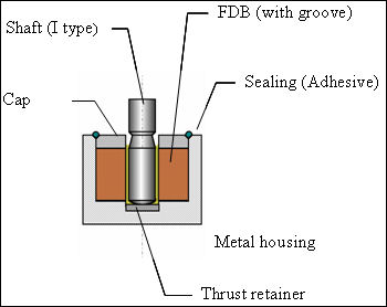

Fluid Dynamic Bearing is a technology invented by Sony that floats the motor in a magnetic fluid type thing that eliminates the need for a physical bearing.
I only need to attach it as a "Blow" fan so no biggie there.
At $5 US each they are cheap and well reviewed on the Net.
If I need to replace them I will just use standard 120mm fans on an LM317.

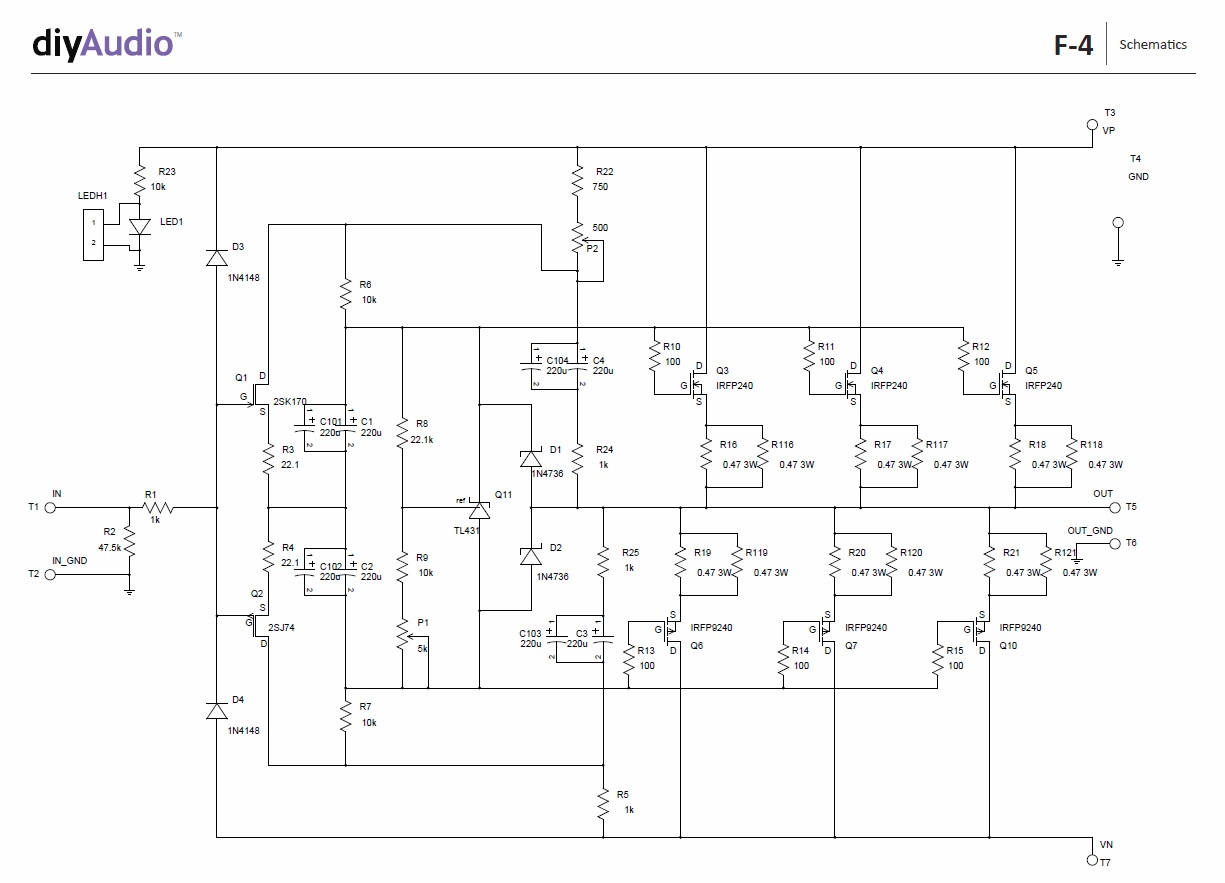

Here is the schematic.

I will be running +-24V ish, with probably somewhere around 500mA to 1A of bias per device I believe.
I'm basically following the DIY Audio F4 Build thread for my information.
The main difference being I will be using bypassed Panasonic FM capacitors instead of the Silmic II's.
Current all depends on heatsink temperature 50-55 degrees C.
