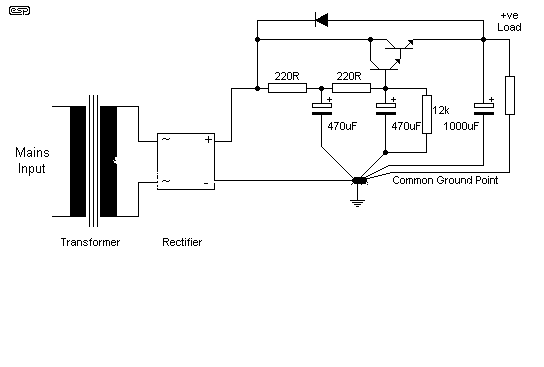

I have a little situation, hopefully you guys can help me out. I have a capacitance multiplier from Rod Elliots design. And I have 2 x 10,000uF capacitors with a 0.1ohm resistor connected between.
Should I place the 2 x capacitors before or after the multiplier in order to gain maximum benefit?

Could someone explain the purpose of the different components in the capacitance multiplier to me? I seem to have trouble figuring it out.
Referring to the attached modified pic from ESP, how does one increase the ratio of the capacitance by modifying the values of which components?
By the way, i'm not too sure if I have wired out my circuit correctly for a supply rail of +63V and 0V.
As suggested by an earlier thread, I should connect my CRC network of 10,000uF, 0.1ohm, 10,000uF after the capacitance multiplier.
Regards and thanks to anyone who helps me clear up my confusion.
Chua

My understanding is that the capacitor at the base of the transistor acts as a reference, but without any significant current passing over it, this allows it to smooth to a much greater extent than if all the current was passing over it. The Transistor then takes this relatively smooth reference current and uses it to control the flow of current through the transistor. Splitting the base capacitor into two and seperating them by a resistor improves the effect, though I left it out.
I would leave off the the 12K resistor from the base of the transistor to earth as it made it sound much harsher this way.
