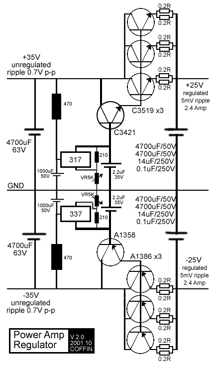

Could someone explain the purpose of the different components in the capacitance multiplier to me? I seem to have trouble figuring it out.
Referring to the attached modified pic from ESP, how does one increase the ratio of the capacitance by modifying the values of which components?
By the way, i'm not too sure if I have wired out my circuit correctly for a supply rail of +63V and 0V.

My understanding is that the capacitor at the base of the transistor acts as a reference, but without any significant current passing over it, this allows it to smooth to a much greater extent than if all the current was passing over it. The Transistor then takes this relatively smooth reference current and uses it to control the flow of current through the transistor. Splitting the base capacitor into two and seperating them by a resistor improves the effect, though I left it out.
I would leave off the the 12K resistor from the base of the transistor to earth as it made it sound much harsher this way.

What is the largest capacitance value that anyone reading diyAudio has used at the output of a capacitance multiplier?
I'm thinking of using a single IRF140 for positive polarity and an IRF9240 MOSFET for negative polarity (with a bleeder resistor from gates to ground), at a standing current of about 1A.

Earlier in the thread, Shoog stated that he had used 44,000uF after his capacitance multiplier, which used 2 pieces of MJ2955 (TO-3, 15A, 115W, 60V rating) to handle 5.2A standing current. OTOH, Rod Elliot suggests that the output capacitance not exceed 4700uF, because of excessive changing currents.
It would be useful to know what levels of charging currents can be expected as a function of capacitance value (perhaps modified by capacitor ESR or ESL), or equations to define the relationship.
Setting that aside, however, I am interested in knowing if other builder's experiences suggest that 44,000uF will work with a 30A device (15A parallel) and a 5.2A load (peak 7A), or whether someone happens to possess exceptionally large gonads.
If the above works consistently then I'd assume that 10,000uF after an IRFP140 (TO-247, 27A, 94W, 100V rating) to handle a 1A load should not be a problem (which is what I am planning to try).
