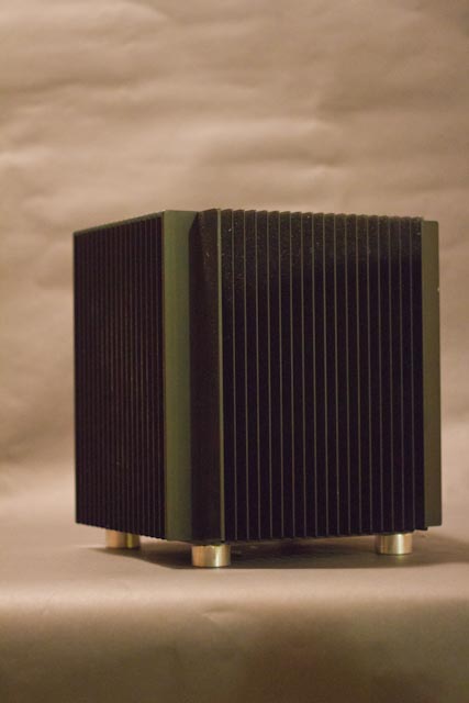

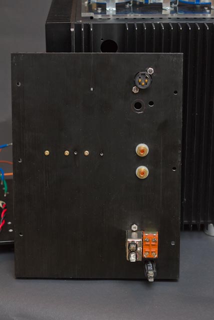

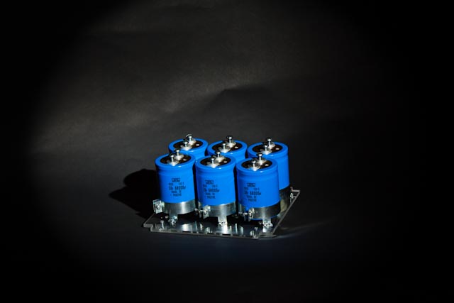

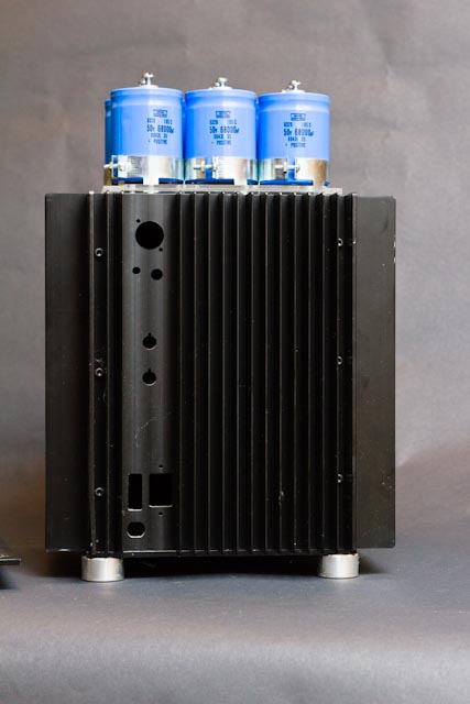

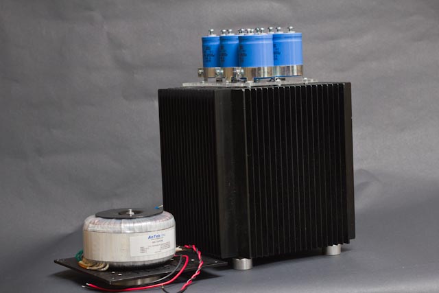

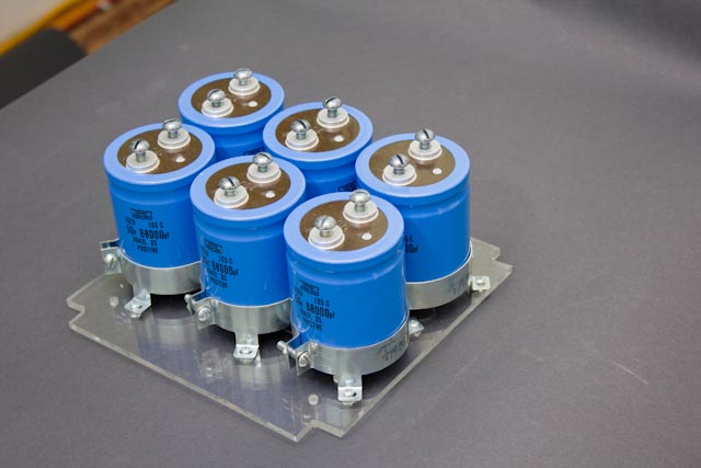

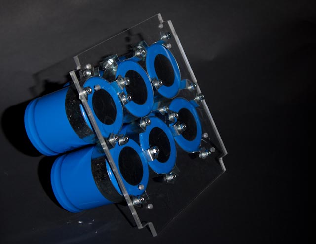

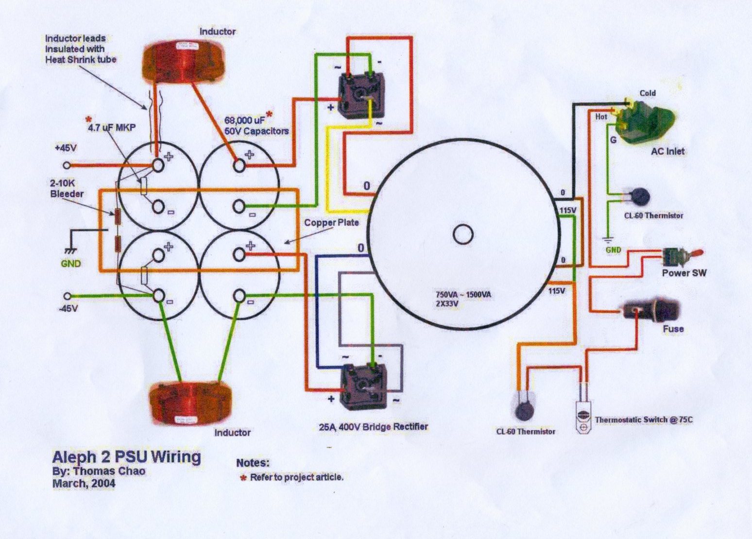

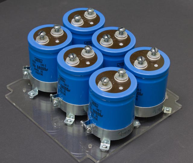

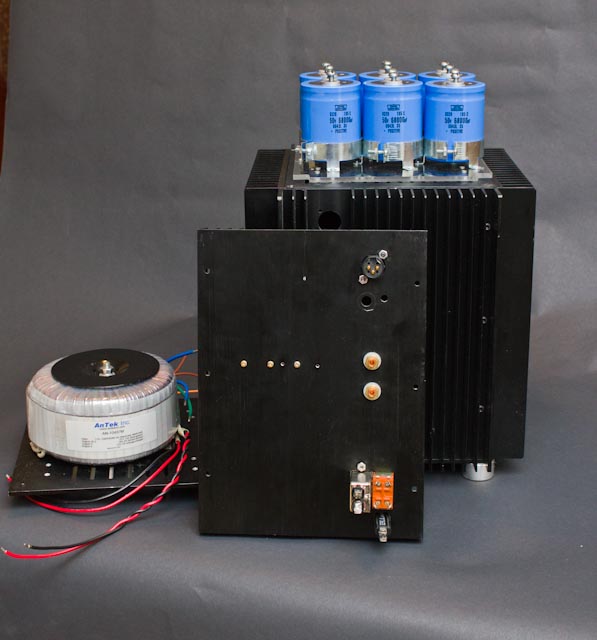

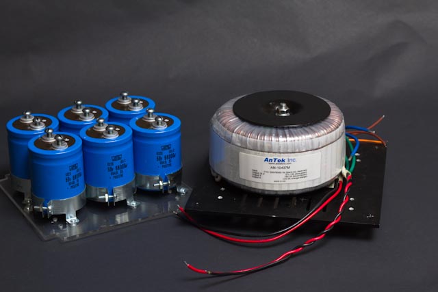

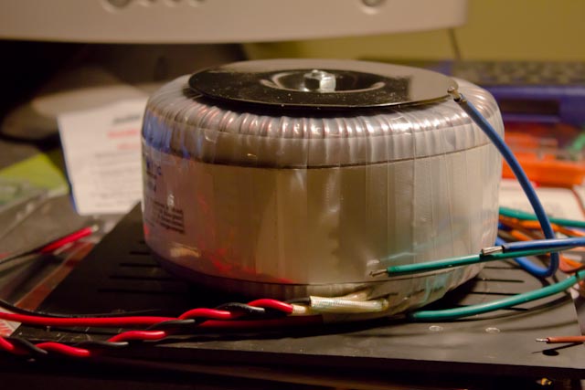

Hello everybody of this wonderful forum, I started this project more or less 6 years ago and then stop suddenly , now I don't see the day that I finish it but I know is very close, but have some simple questions to finish it. Trans are Antek 1000v 2 x 37 secondaries and 6 x 68000uf caps. 1- Is 2.00mH 14 gauge fine ? Trans primaries has a pair of cable with 115 w red-black red-black , that means only one pair is to be use red-black. Sorry for this newbies questions but need to be 100 % sure. Thanks in advance. I'll post some photos through the entire building process. Thanks in advance. JP Duarte.
Official Court Jester
Joined 2003

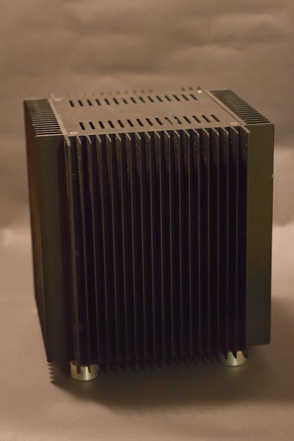

Well, I'm planning to mount 3 fets on each heat sink and the rectifiers on the side panel and mounting everyone with Bergquist thermal pads K10 including the rectifiers. One question about the fets, do I have to use any kind of isolation like a plastic washer for the screws that hold the fet to the chassis?
