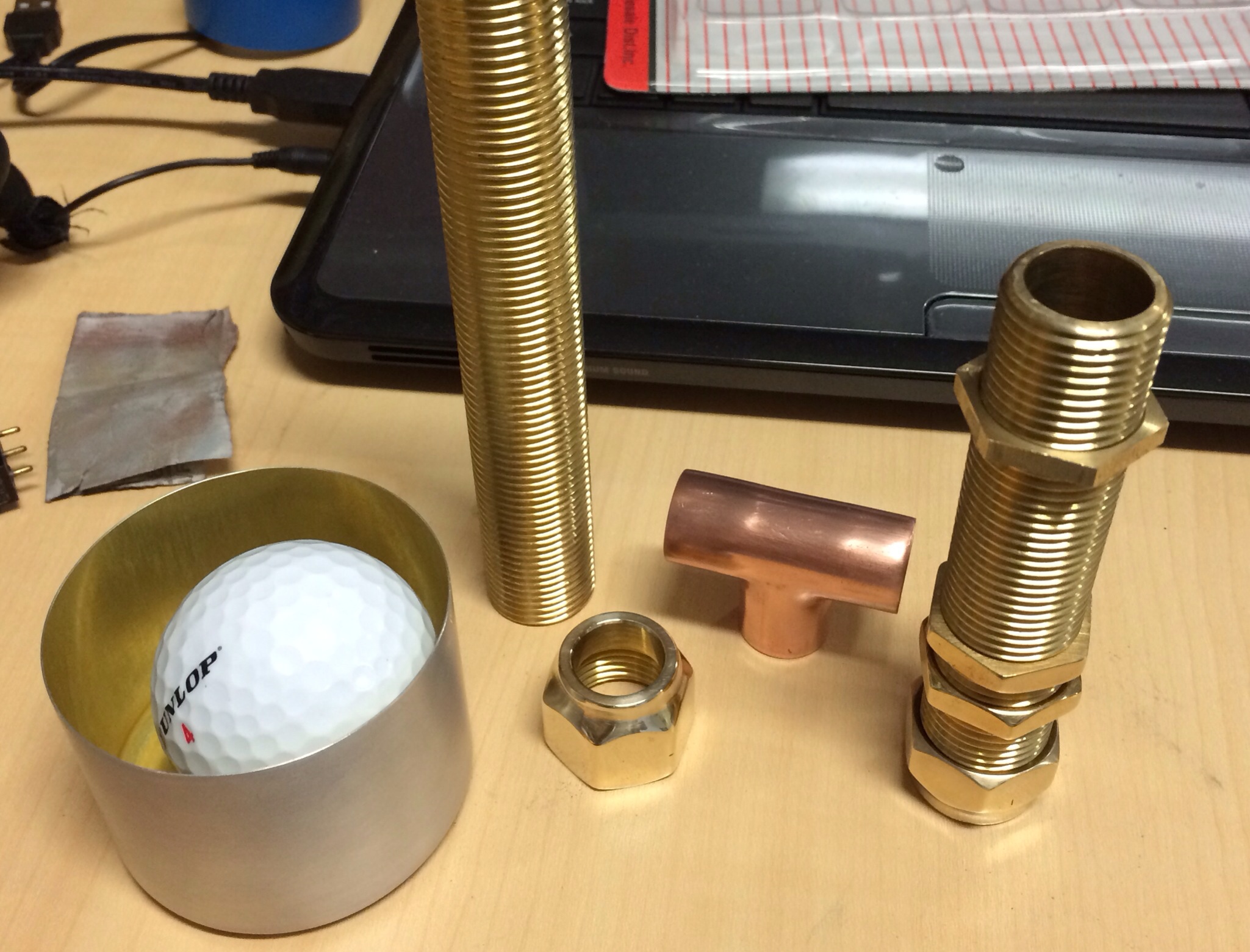

I have be contemplating this arm for a while, but what has stopped me is the method of drilling a hole so close to the edge of the ball. I would really love to know how it was done, as this seems to be the sticking point for in this project.
I was even thinking about making up a wood jig to house it in while drilling?
Any suggestions.......
Nice work on this set up.
I just used my Bosch drill press with the golf ball sitting in the central hole in the base and the drill offset the appropriate amount.The ball was hand held in place.I started at 4mm and used a wood bit with the sharp point and worked up to the final 7.5mm.The bits easily clog up with melted rubber so need cleaning regularly.

Has anyone used the cheap plastic practice ones? Fill them with a silica based paving sand or sterilised fish tank sand?
Easy to drill, and easy to attach arm to the top while experimenting with filler?
It would help if you didn't have a good drill as this would negate the need to try and put a shaft through the top. Then you could use a small heated rod to melt the cross holes for the string?
Golf Balls and other spherical objects
You don't need to drill-see pictures of my design earlier in the thread. Also -forget anything but a golf ball for this design-it needs the weight and the density to work-remember- the golf ball is suspended in the fluid-it doesn't float.
