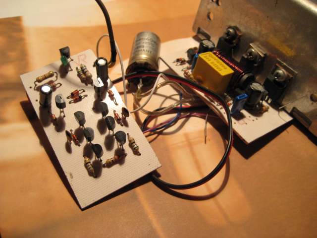

My DIY UcD amp from the junk box
Hi...
I'm proud to present my first UcD amp circuit.
All components come from the junk box (!) Yes, no money for this amplifier, no smd, no ic, no gold plated connectors, no strange japanese transistors.... on two homemade printed boards: a pcb for modulator, a pcb for power stage, 68X35 mm each.
It's perfectly running at 20Vdc (single rail supply, output cap!) on a 2 ohm load, delivering a very very clean, bright and powerful sound.
I've built a second power stage, and I'm planning to modify the modulator to drive two power board in bridged mode (so I can get away this horrible output cap!)
It's based on classd4sure schematics (threads: http://www.diyaudio.com/forums/showthread.php?s=&threadid=40307&highlight= ; http://www.diyaudio.com/forums/showthread.php?threadid=55385 ) (thanks to Chris, Bruno,etc. ), and on the big know-how of the people in this forum (thanks to all)!
Some data:
power Mosfets: IRF540
transistors in modulator: BC557 and BC237
transistors in power stage: all BC337 + 2SD478 (from the deepest and darkest place of my junk box) for stabilized voltage in gate drivers
all diodes: 1N4148, no schottky diodes!
output filter: 28 turns of 0.6mm2 enamel wire, on a ferrite bead... (about 22 microHenry), and 1microF cap
final output cap: a 30 years old, 1000 microF german electrolytic... last attempt to use it in a circuit!
This is the most simple and funny amplifier I have built in 15 years...

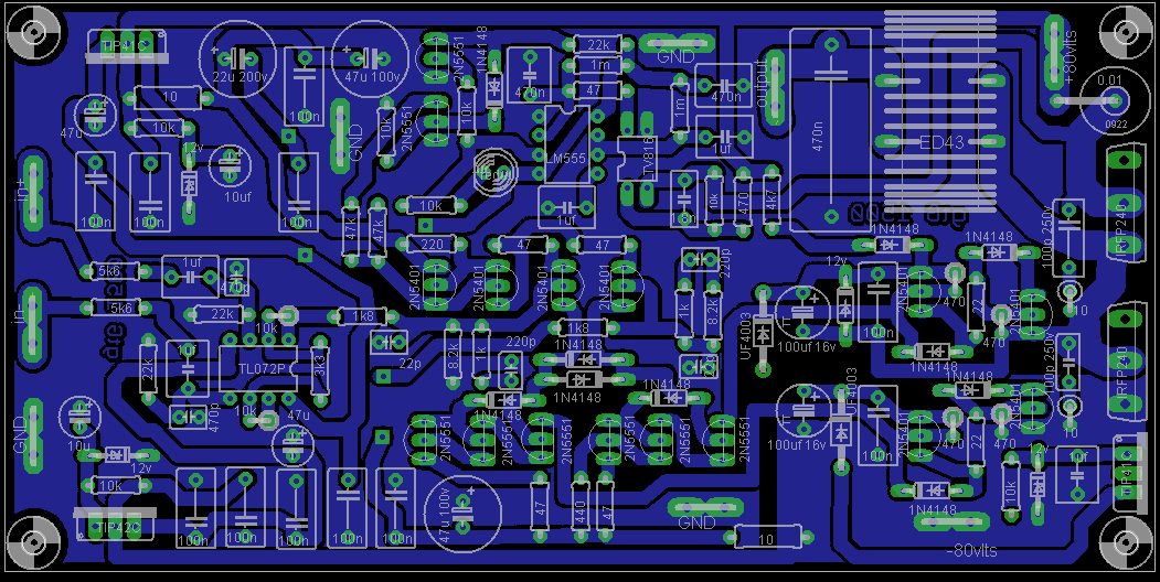

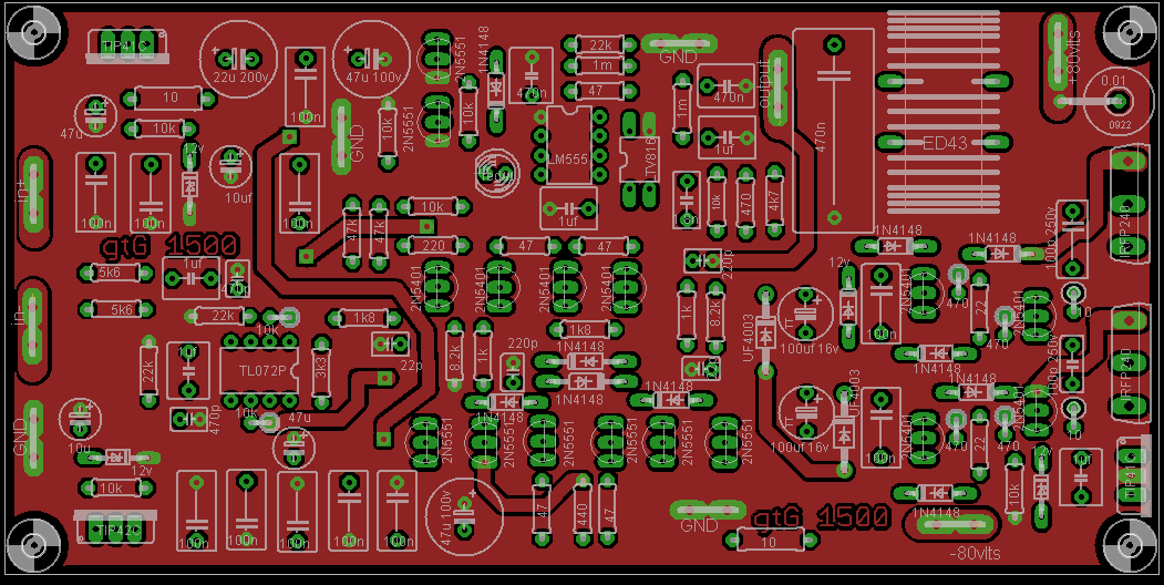

it can operate up to how many vltg +/- ? are the irf540 comfortable or do they heat .
i have done a schematic based on class d from ru the 540 were heating even at +/- 12vlts .i thought it was the rds problem . i changed and used irfb23n20 and still the same problem thats when i thought my signal diodes were the issue . i replaced a 220r resistor with a 440r one on the negative side of the amp and it solved the problem . but i do not have theory proof or calculations to back me up thats why i was so puzzled. recently i used +/- 56vlts it works fine . till a speaker burns and shorts the outputs which destroys them.

If MOS-fets in class-D amps are heating too much, the dead-time between the two control signals is too short. It causes a "shoot-through", a rapid short-circuit of the power supply at every commutation, when both MOS-fets are (fully or partially) switched on together. This results in very short but incredibly intense current pulses through both switching devices, so MOS-fets heat up (and then they fail).
The dead-time depends on the resistor R4 (in the schematic yuo posted), so tweaking the value from 220 ohm to 440 ohm increases the dead-time, so a MOSfet is fully turned off, when the opposite start to turn on.
Have you tried a +/-56V power supply on IRF540? A bit high voltage, IMMO. IRF540 are rated 100V. With 100v parts working, at 112v rail to rail there's a good chance they will fail (and there isn't safety margin).
And protect your speaker! Normal fuses at the output, and on power rails, will save you a lot of money.
thanks alot acid i had been wondering and puzzled GOD bless you big time. i had tried the irf540 at that voltage it works but fails . at that voltage i normaly use irf640 they work fine but if speaker fails the protection does not kick in to save the outputfets. i am not ignorant of using fets with low rds like irfb4227 but they are not there. The only available one is fb23n20 but when i used it with R4 as 220R it heated alot when used R4 as 440R it warmed the 540 and the 640 per
