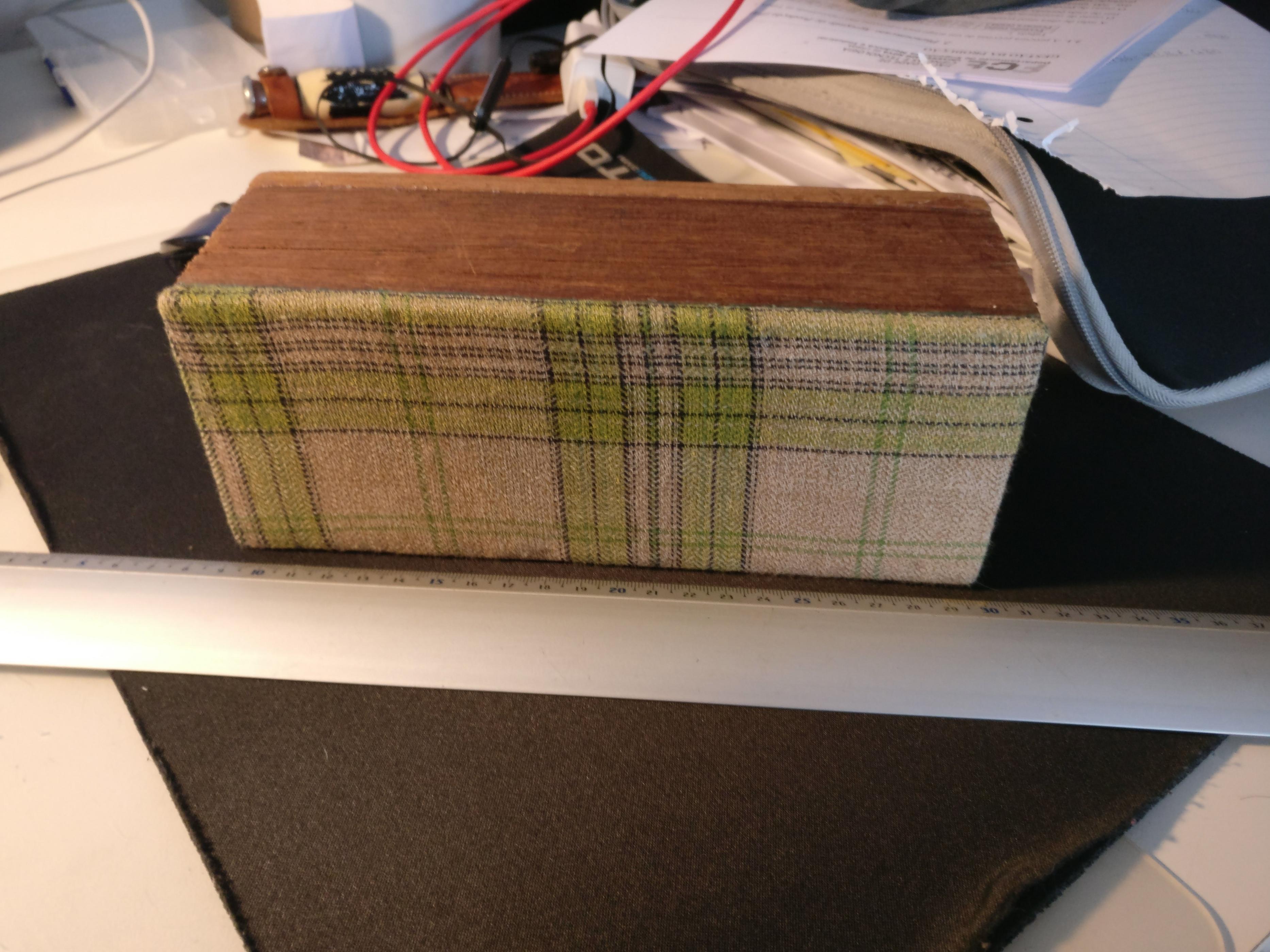

Could you elaborate a bit more on your "backpack speaker" concept and your performance goals?

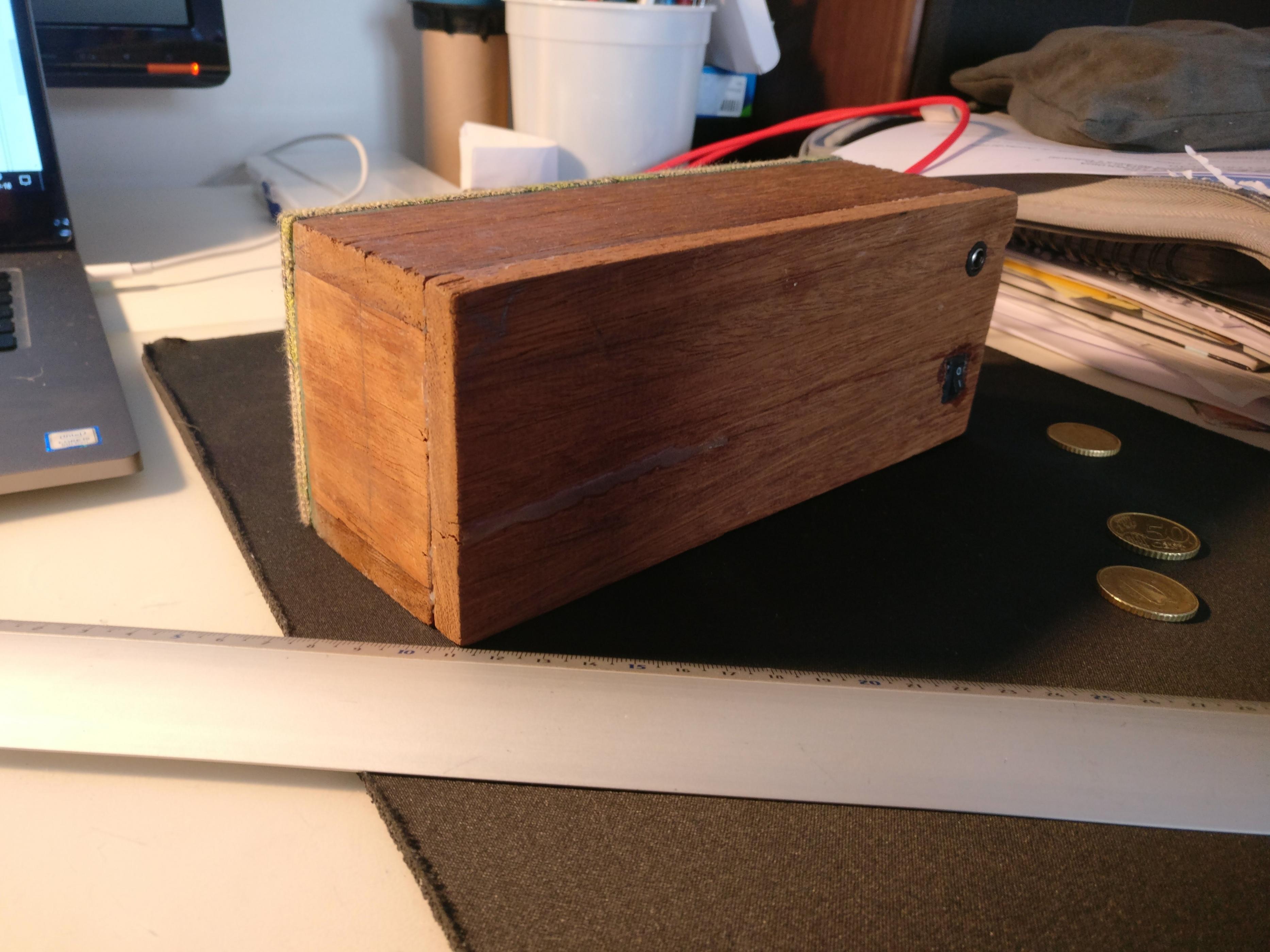

i meant something arround the size of a jbl charge 3 or ue megaboom. like 1litre enclosure. the pics attached are a test i made.
High Fs means more bass? i looked at the entire range of 2'' from peerless and this ones seem to be the best ratio and the ones with higher range of freqs..
High Fs is less bass. Your box is very small and without chamber dampening or stuffing all the back radiated sound will reflect and feedback onto the cone and cause it to sound muffled due to destructive interference. Try adding some stuffing or even removing the back panel to see if the sound clears up (no bass) but that will confirm the source of why it sounds muffled. You are trying to make a small MP3/BT speaker - just go buy one for $15 with passive raditaor, amp, BT 4.0, and rechargeable batteries built in. You cannot replicate that for $15 - at least $50 to make yourself and it will not sound as good.
Foe example:`

Honestly, It's tough to compete with engineers that design amps to fit a driver in a specific enclosure. The units that can be purchased in a store are not just a run of the mill amp and some drivers. Everything is taken into consideration in the design of the unit as a whole. Not many folks on this site have the ability to do what some of those engineers do to build a device and have the ability to sell it for 20 bucks..so you mean that for the same money im gonna spend doing it my self, im always gonna be able to buy something better if i buy it from a store?
or is it possible to spend 200euros and build something better than anything available?
It's the holy grail to build a small unit with lots of fidelity and good bass response. Not an easy achievement in most endeavors..
I'm not wanting to discourage you but try to understand that there is a lot of thought in the design to make things small and sound great. Those store bought units sound good but they have a short lifespan. Anything you build might not sound as good but I'm positive it will last longer..
Don't be afraid to try and let these guys give you pointers. You don't need to spend mega bucks to make a good sounding unit but I can assure you it won't be as small as you like..
