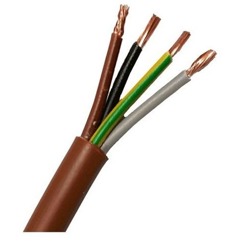

I'm with Peter, any quadripolar electric cable (4x2.5mm) is perfectly fine: just connect together the poles on the opposite side (if you don't use biwiring).
As to biwiring, they are hard to find, but I use a quadripolar with different section, 2x2.5 mm on th LF and 2x1,5mm on the HF.

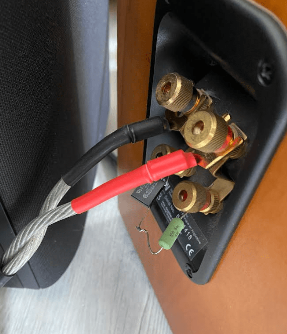

I made all my cables - I use good quality gold plated banana plugs or spade connectors, thick cable like the one below from Amazon and then I feed a nylon sheath over the whole thing with heat-shrink and silicone sealer to secure everything at the ends. The thick cable on the back of the B&W 703's below I bought in Japan - the actual copper strand area is 5mm in diameter for each cable :cool:. As they say in these parts 'Its proper decent like'
(The RC networks on the back on the speakers are because I've been experimenting with cable termination - different subject)

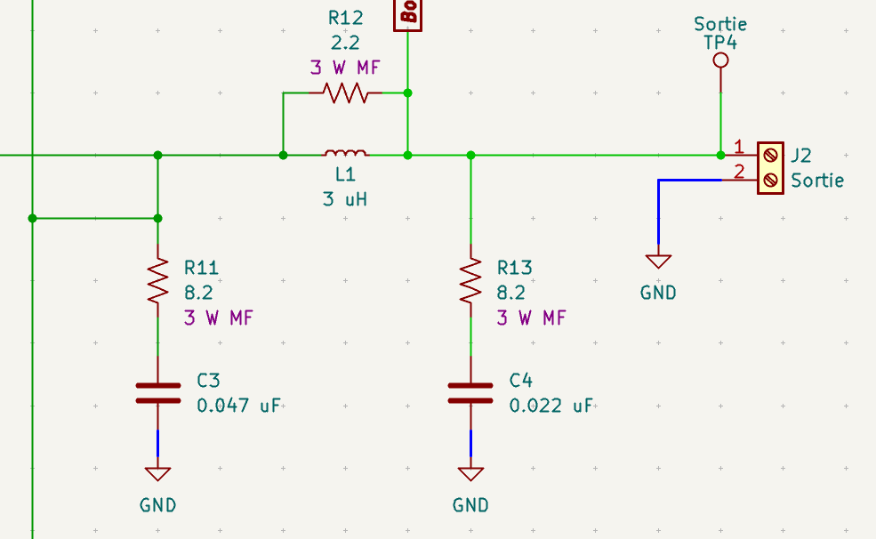

So if I understand it right, 250pF/metre in my cable, versus "amplifier should easily be able to drive a few hundred nano-Farads directly", I don't have to worry, right?
And as for "use an output LR coupling network (0.5-1.5uH//2.2Ohms) and a Zobel from the amplifier output rail to 0V (8.2 Ohms in series with 0.1uF)", my actual design have that:

Yes - assuming your amplifier feedback compensation is also good, you should easily be able to drive your cable. The output of your amp above looks good. When you test your amp, one of the things you have to do is spend a few hours with a range of capacitors from say 100pF up to 2.2uF in parallel with 2 Ohms, 4 Ohms, 8 Ohms, 33 Ohms, 100 Ohms and open circuit looking at the stability. This test is done at 2-3V pk-pk output squarewave at 2 or 3 kHz. You look for overshoot and any oscillation. I use LTspice extensively for loop gain analysis, but you always have to follow that up with extensive testing on the prototypes.
(You only really see very high capacitive loads on ESL's, but I test at 2.2uF because you never know if someone won't use an amp with an ESL)
