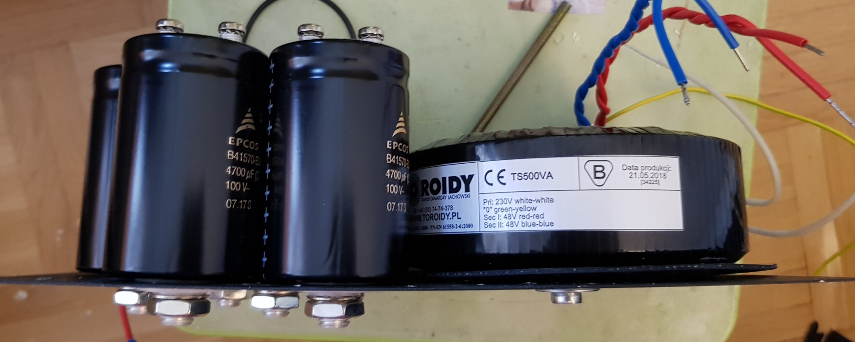

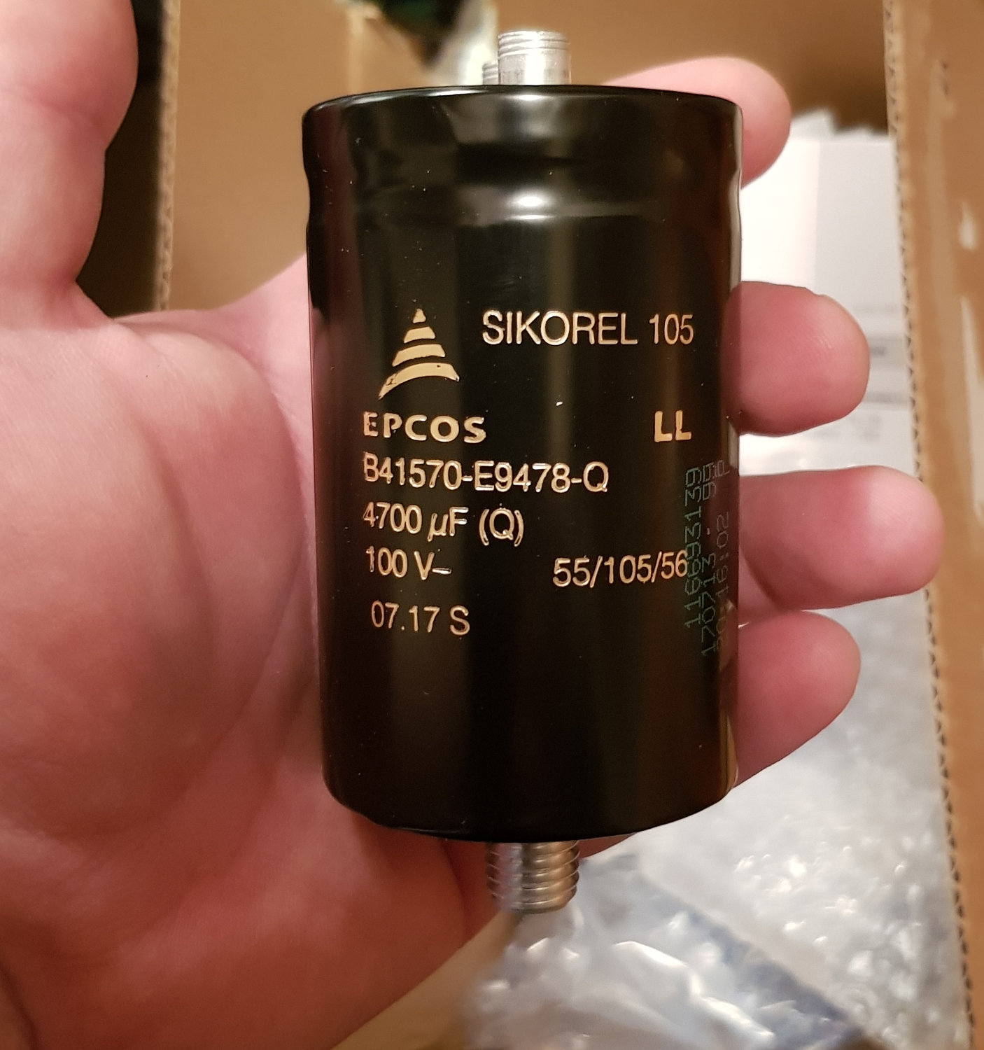

I'll use a 500VA potted toroidal transformer from Toroidy (their Audio line of transformers) that is: 230VAC primary and 0-48Vac + 0-48Vac secondaries.

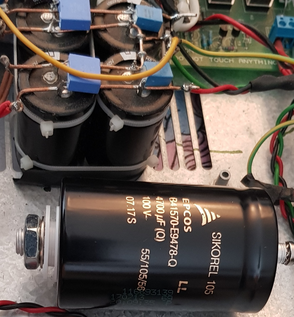

I have six of the big caps in the attached picture I'll use(the toy-looking caps next to it are actually standard sized 10000uF/50 snap-in caps lol).

But since I have a toroidal transformer that's 500VA 2x48Vac (that's about 68Vdc) I can use with the L20D modules, and I bought an L30D module to use with the 500W smps that is around +/-75Vdc...I'm pretty much good for now.
I'll use the L20D modules to drive my Infinity's, and the L30D to drive 2x15" open baffle subwoofer.
That gives plenty of headroom, no risk of sub or speakers being starved of power.

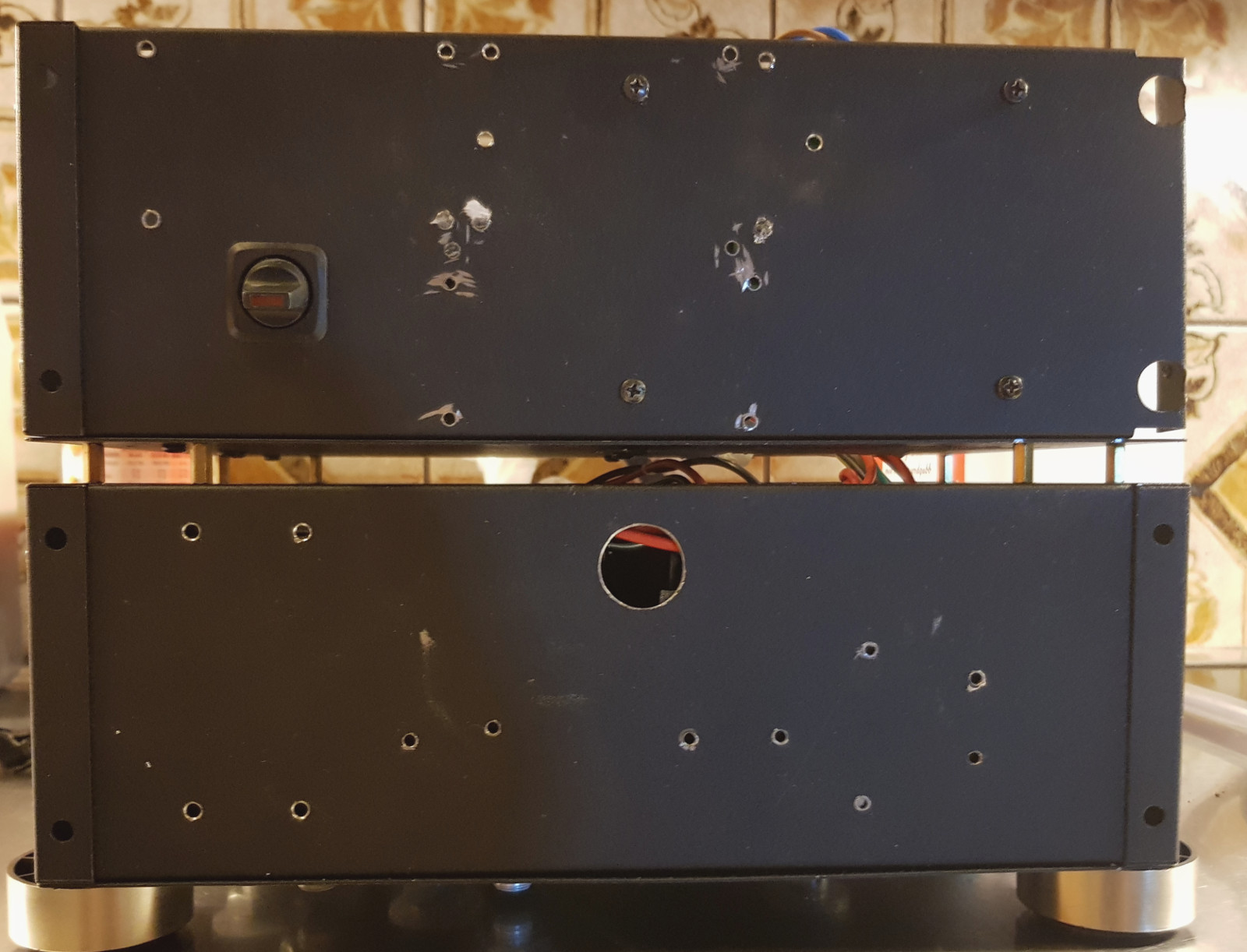

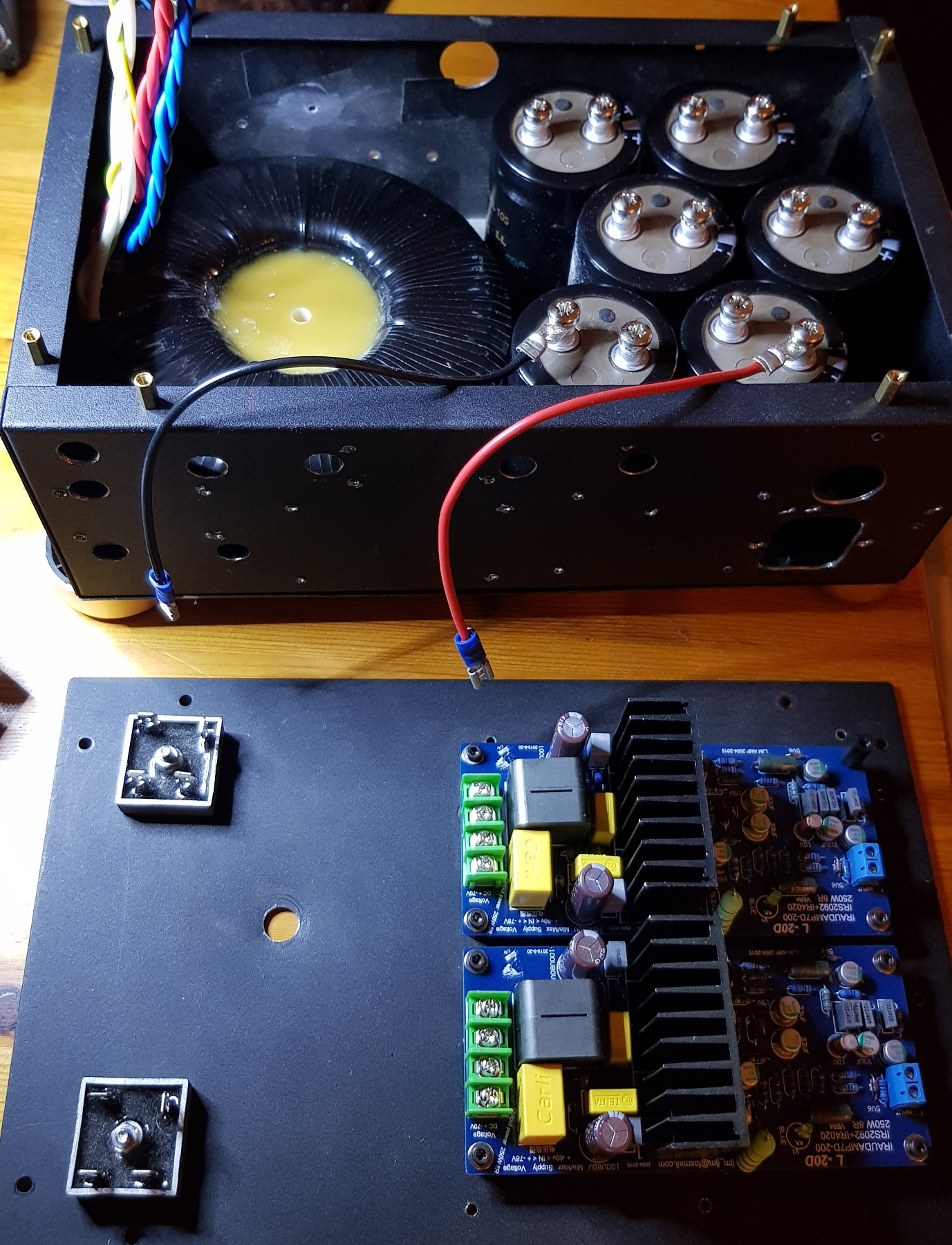

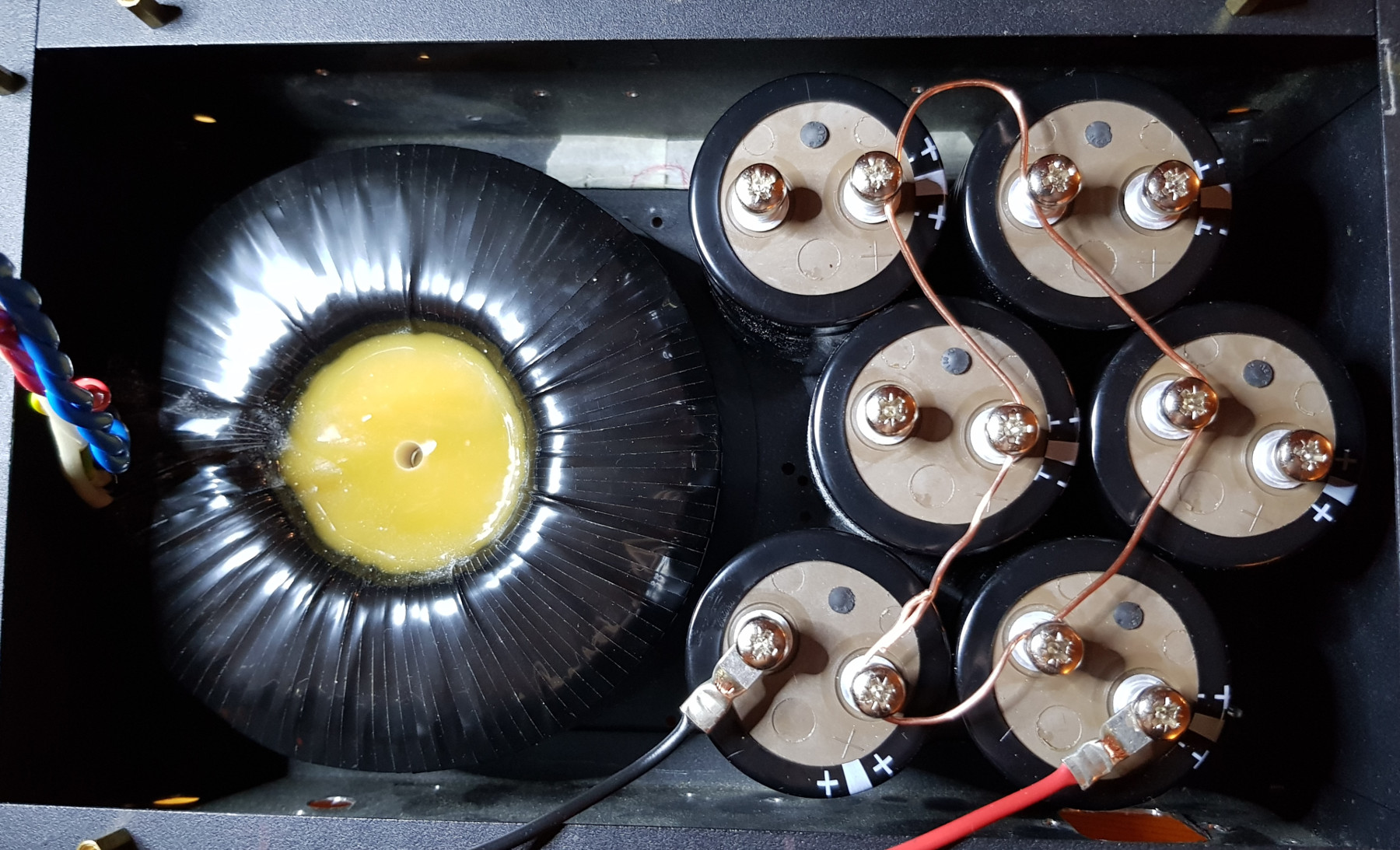

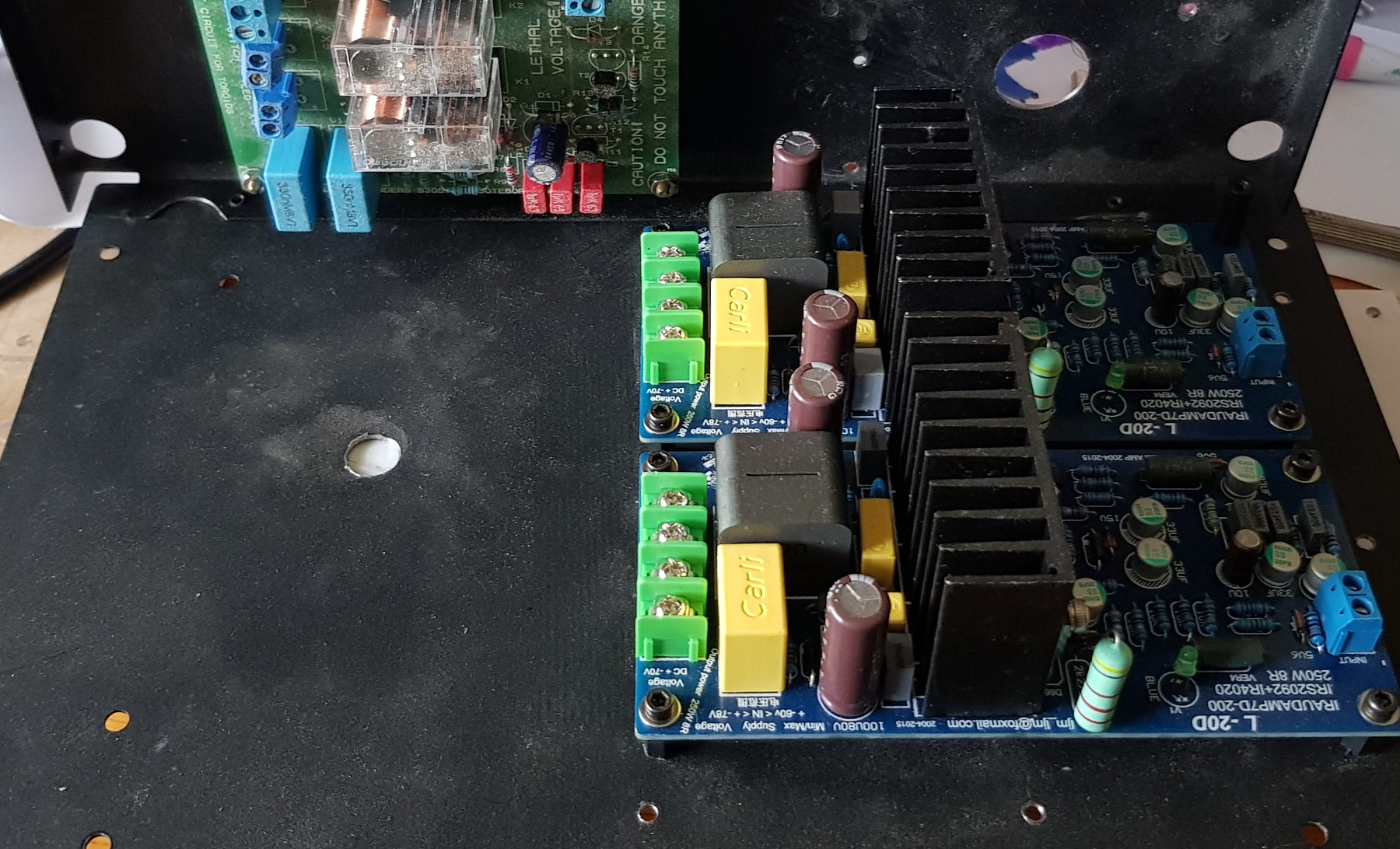

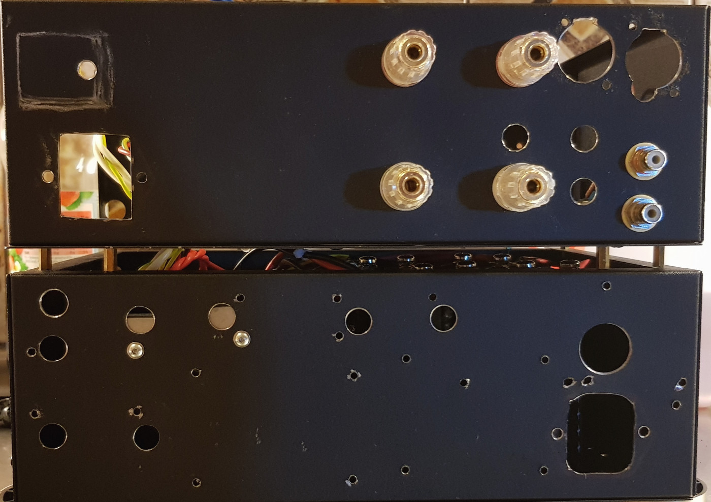

I've finally gotten around to, slowly, putting a stereo poweramplifier using 2x L20D modules, 500VA 0-48VAC + 0-48VAC transformer, 6x Epcos 4700uF/100V very nice capacitors(20000h at 105C), SST01(softstart from P-A Sjostrom) and two medium size enclosures(I don't have one large enough without heatsinks, and I refuse to use a nice heatsinked enclosure for something not requiring heatsinks).
Well, actually medium size might be a bit generous...anyway, I'll use them one on top of the other with spacers as the capacitors are just a bit too tall.
These enclosures have seen better days, but I plan on covering the fronts and maybe the sides with some nice, dark wood.
The transformer and capacitors are VERY heavy
I'm not sure about using the bare copperwire as shown in the picture, I may go for a multistrand 2,5mm^2(AWG14), the same as the black and red insulated cables connecting to the caps.
I think this amp will sound quite nice when completed, I believe the linear powersupply is more than adequate for this Class D amplifier.

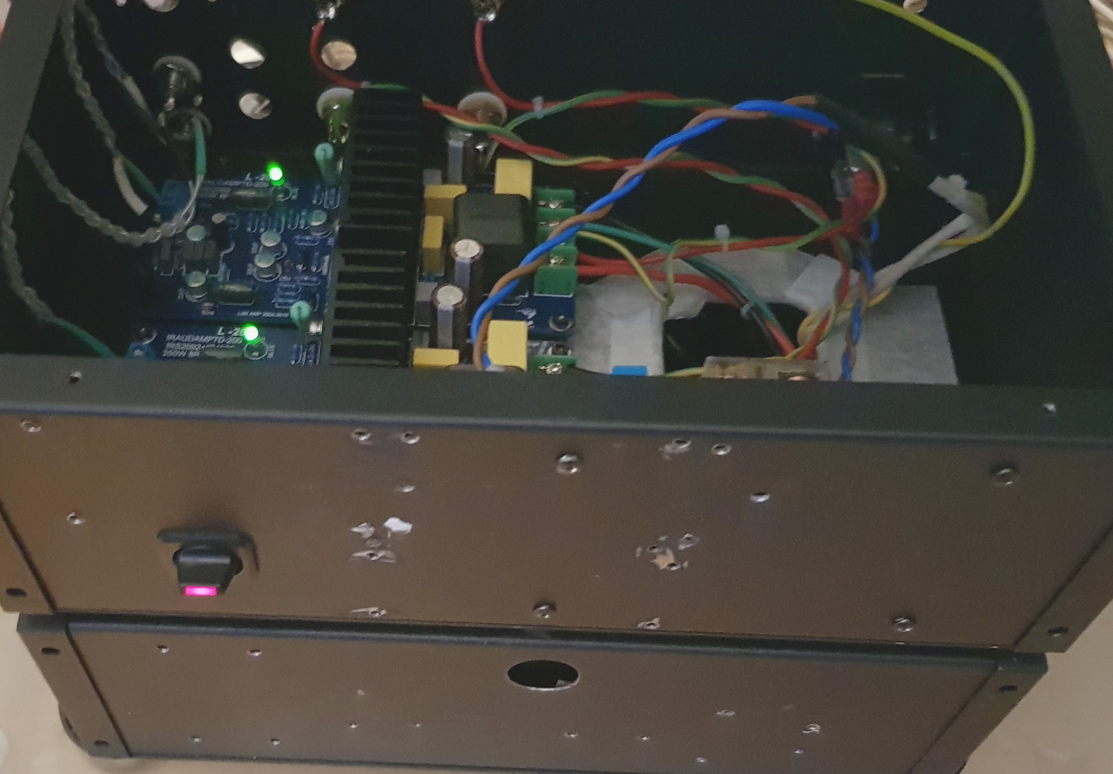

Up and running
Well, it's finally up and running
It's built well, but ugly as sin currently. I will put some nice, oiled, dark wood on the front(s) and sides. Since the capacitors and transformer took up soo much space, I have two identical enclosures...one on top of the other.

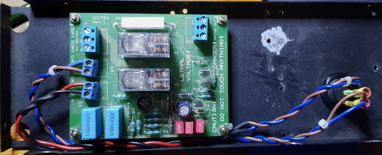

The bottom half house the transformer, bridge rectifiers and the capacitors, the top half house the Sjostrom Audio SST01 (I really like this softstart), the L20D boards, the on/off-switch and all connectors.

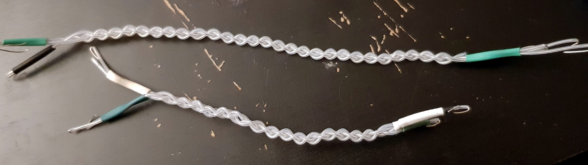

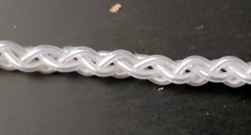

I still need to tidy up the internal wiring. I went with 0.6mm 99.9% silver wire threaded in to PTFE-tubing, for the input cable. I made four lengths(per channel) of it and braided it.
I haven't really had the time to listen that much, but initial impressions are good. Absolutely no noise or thump when turning the amp on or off, with my ear against a speaker and the volume at 12 o'clock (music paused) there's a barely audible hum. That hum however is so faint that it's most likely the, not for long, rats nest of cables with power cables crossing interconnects...it's ugly.
I blame my backpain for that one, but I just recently found out I'll get some help around the house, so I will get that sorted.
